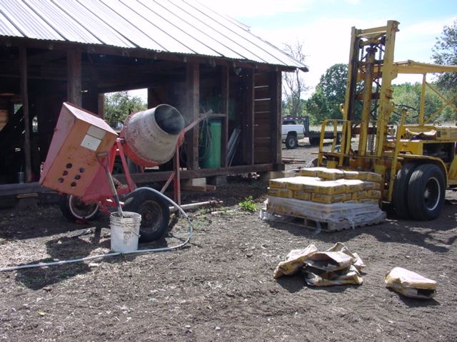

OkeeDon, just thought I would pass along some tips from my last month and a little over a hundred bags of sakrete.
I mix a max of 4 bags a load in the mixer, I think it is a six cubic foot and that seems like a full load(see pic). I wet the mixer down before pouring the first bag, since I know I am going to mix four bags you can be pretty liberal with the water and this keeps it from sticking to the mixer. I add a bag let it mix good, wet it (I spray the top of the mixer which wets the walls and keeps it from adhereing and clumping in between each bag) add another and so on. I get a real good mix but it took a couple loads get it right every time now /forums/images/graemlins/tongue.gif
The sakrete I am using is 60lbs a bag, its a workout humping them from the pallet and dumping into a spinning mixer but if you try load it static you get one of harvs dry bottoms with a wet mess on top /forums/images/graemlins/grin.gif
Just my experience so far not trying to step on any toes....

I did the same thing. Here's a picture of the mixer in my FEL.
If you get the guys at Home Depot to load the sacks or pre-mix into your pickup truck, you can nose the mixer right up there and practically just slide the bags right in without lifting them at all!
