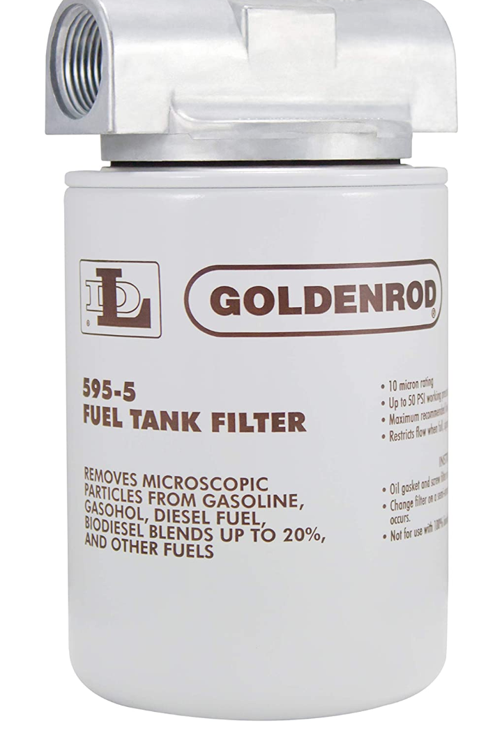

I have a 50 gal barrel with an electric fuel transfer pump that uses one of these. I'm tempted to try mixing a gallon or two of engine/hydraulic oil in my tank. Waddaya think?
