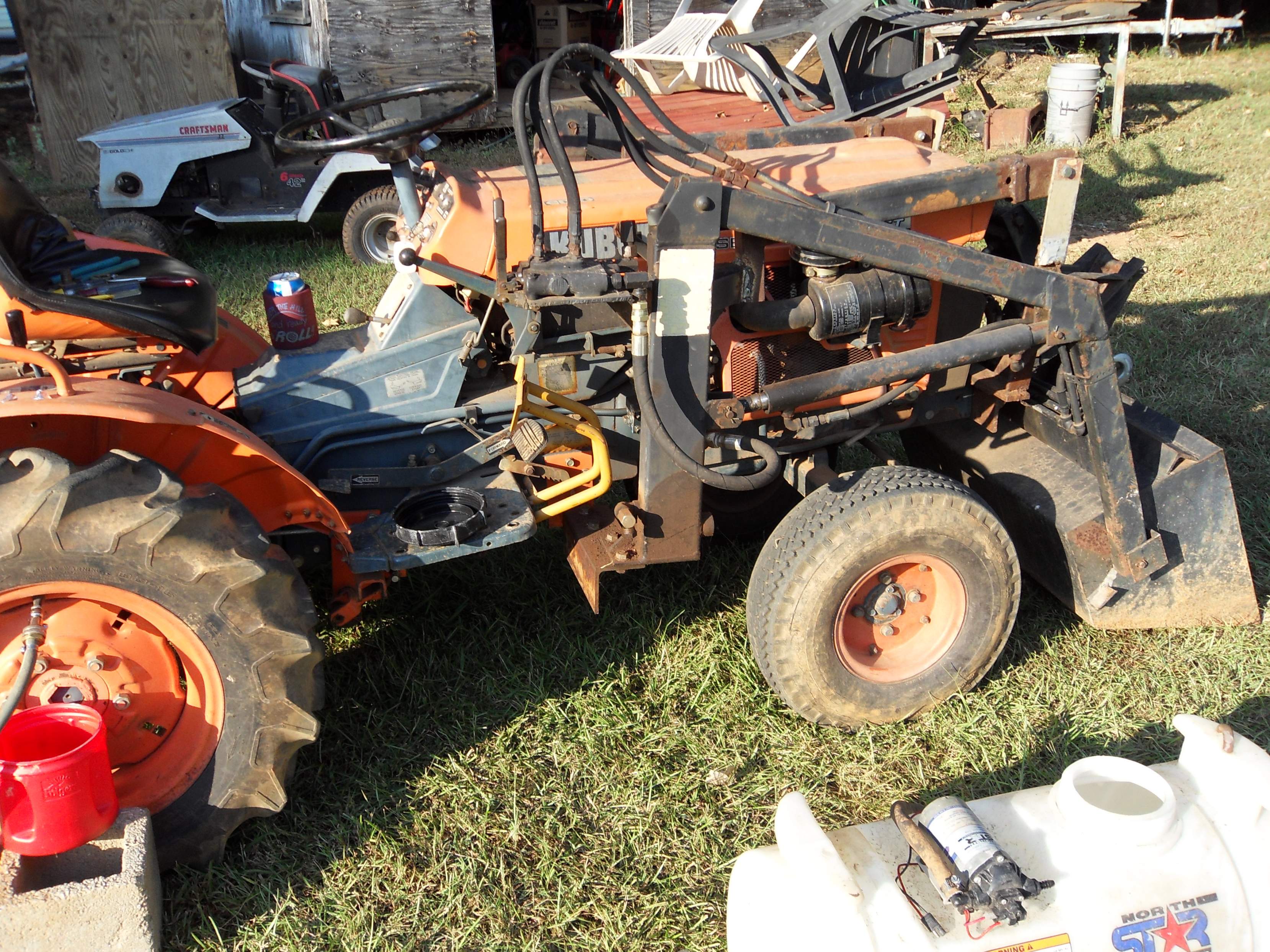

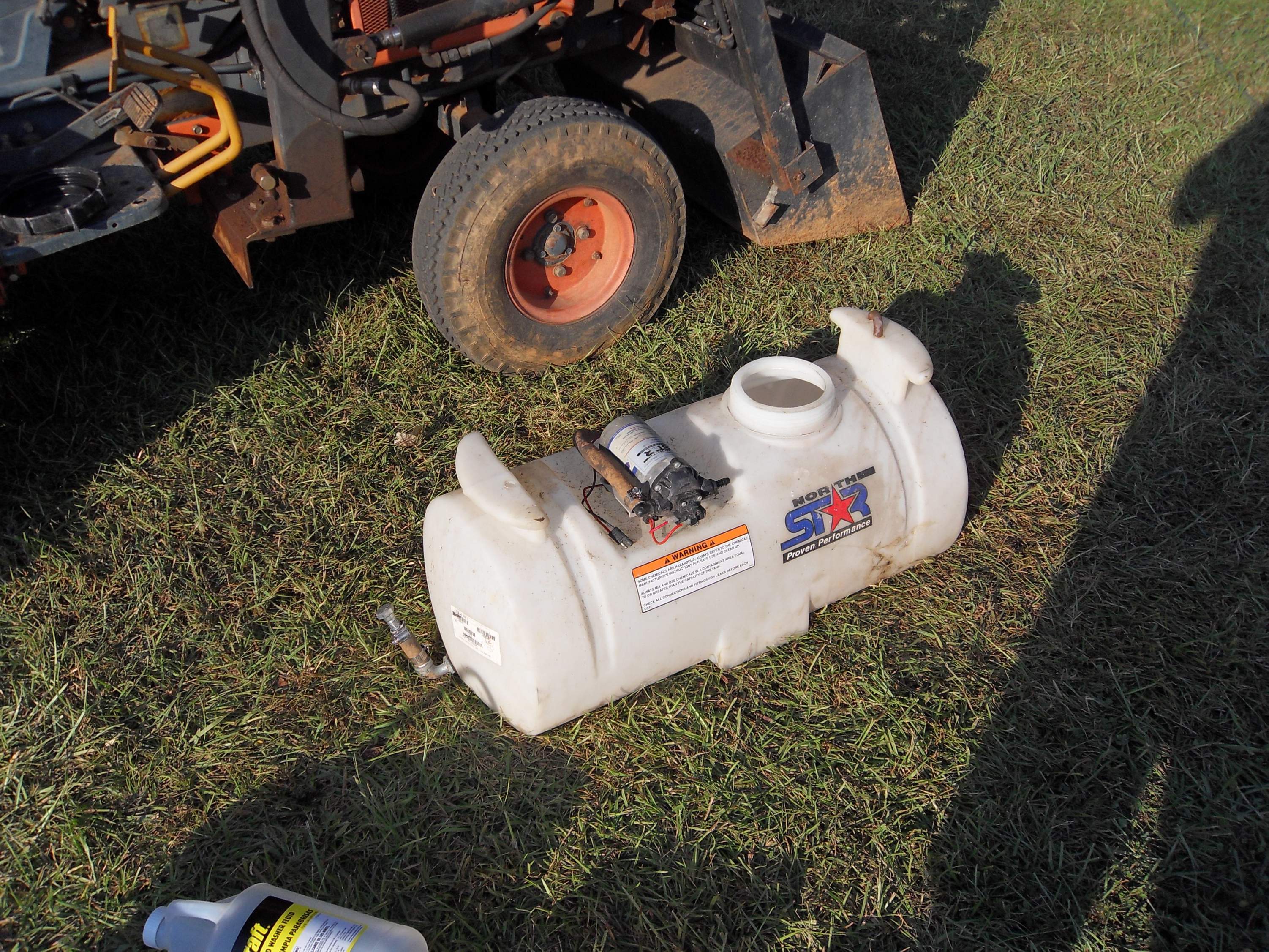

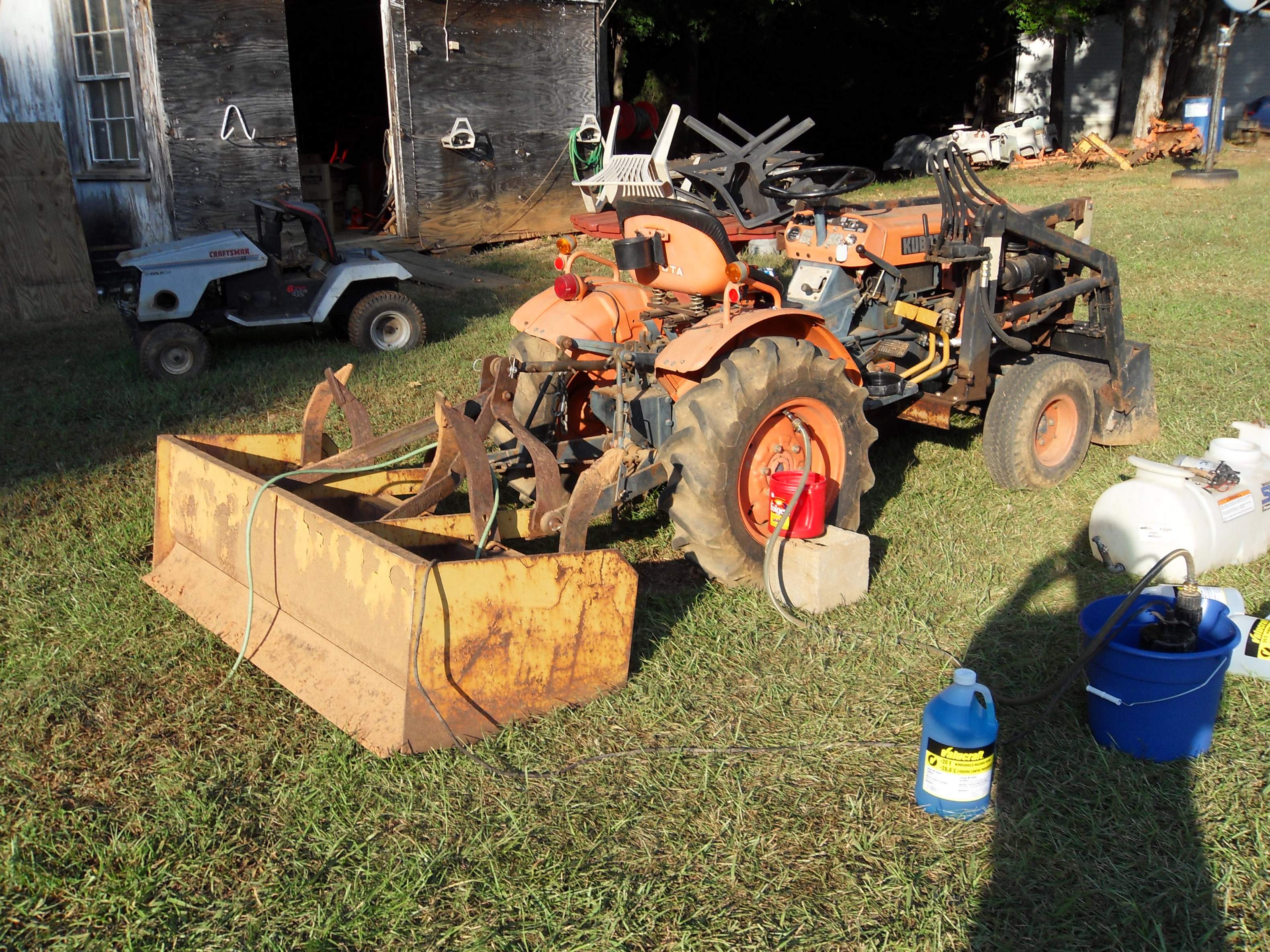

Hey, I finally got her done yesterday. The tank in the 1st pic, I tried 1st to gravity feed it into the tires. But that was too slow. After about 30 minutes I couldn"t tell it had gone down any. I hadn"t used this tank since I had acquired it from who knows where. lol I ran wires to a battery and of course the pump didn"t work. So, then I got my 3 gallon bucket, poured the fluid into it and dropped in my submersible pump in and it worked great. I figured this was the right size bucket ,because it would allow me to pump in about 2 1/2 gallons turn it off, then bleed the air out it. It worked fine,and I can tell it made a difference in the pulling. Even with the weight in the tires, it still wants to spin some. These are powerful little tractors to just be 16 H.P. My little tractor ain"t no pretty thing but she gets it done. :thumbsup:

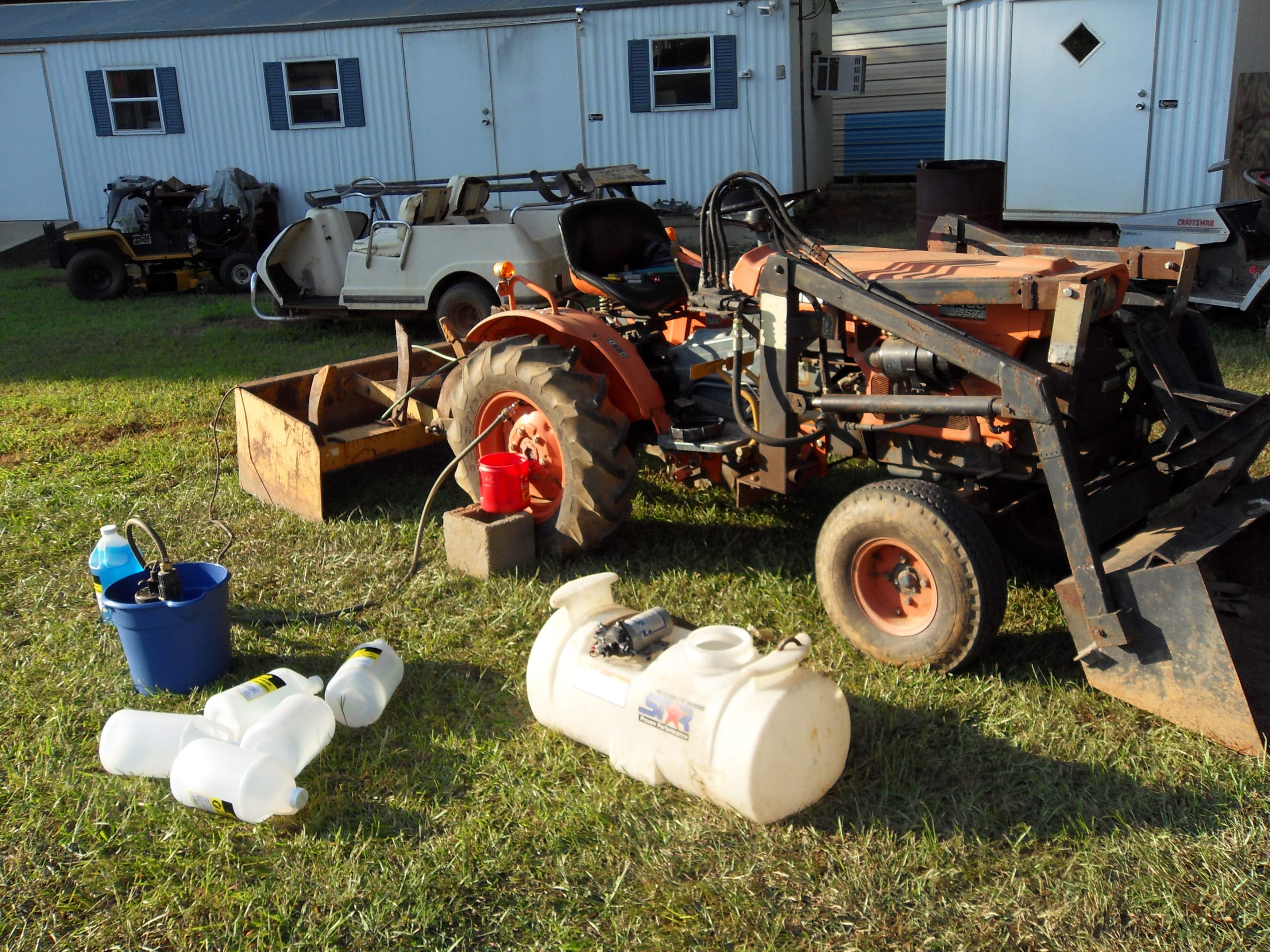

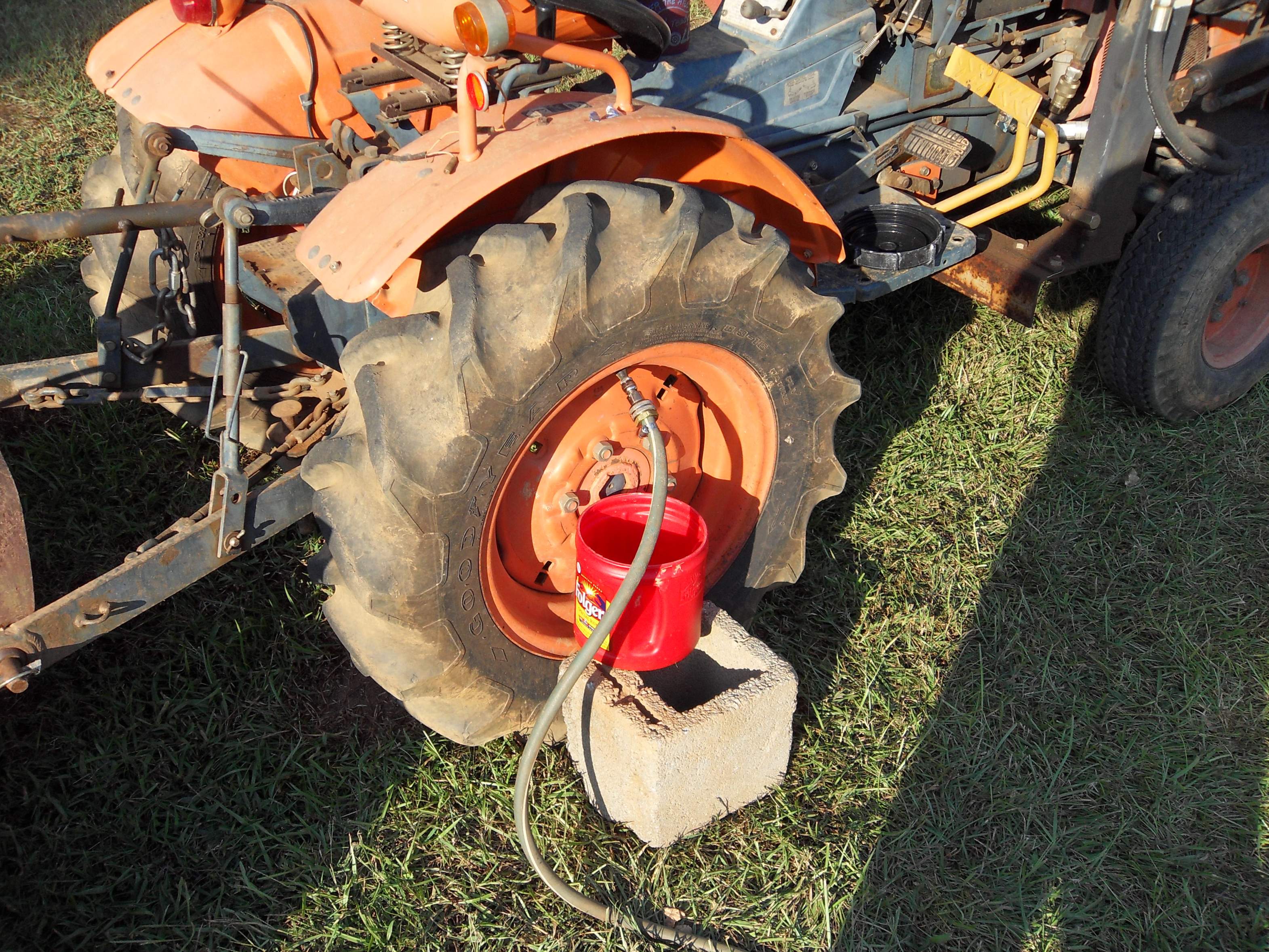

It took about 8 1/2 gallons per tire. I bought all 21 gallons the Auto Zone had so I asked for a discount and he said 10%, and I said man I am buying all you have in stock, so he said ok 20%. So that worked out great. The reason I had the small bucket on a block, under the valve stem was it had a small leak.

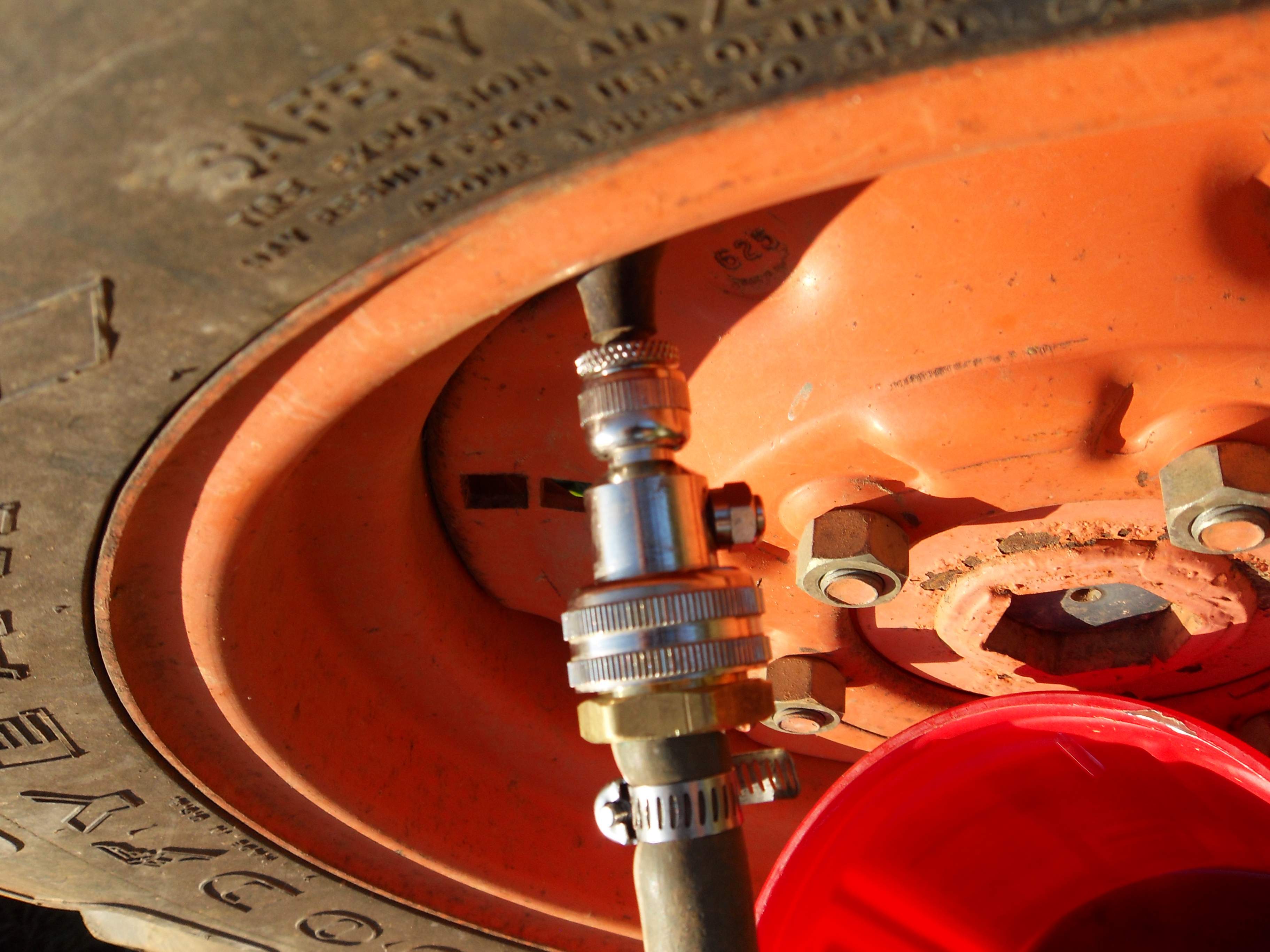

The last pic is for the folks that haven"t seen one of the fill adapters before. I bought this one years ago. The little hex head knob on the side is where you back it out to release the air that builds up inside the tire. Oh by the way, I didn"t mix water with the WWF, I used it full strength. -20 degrees below formula. zman:)
