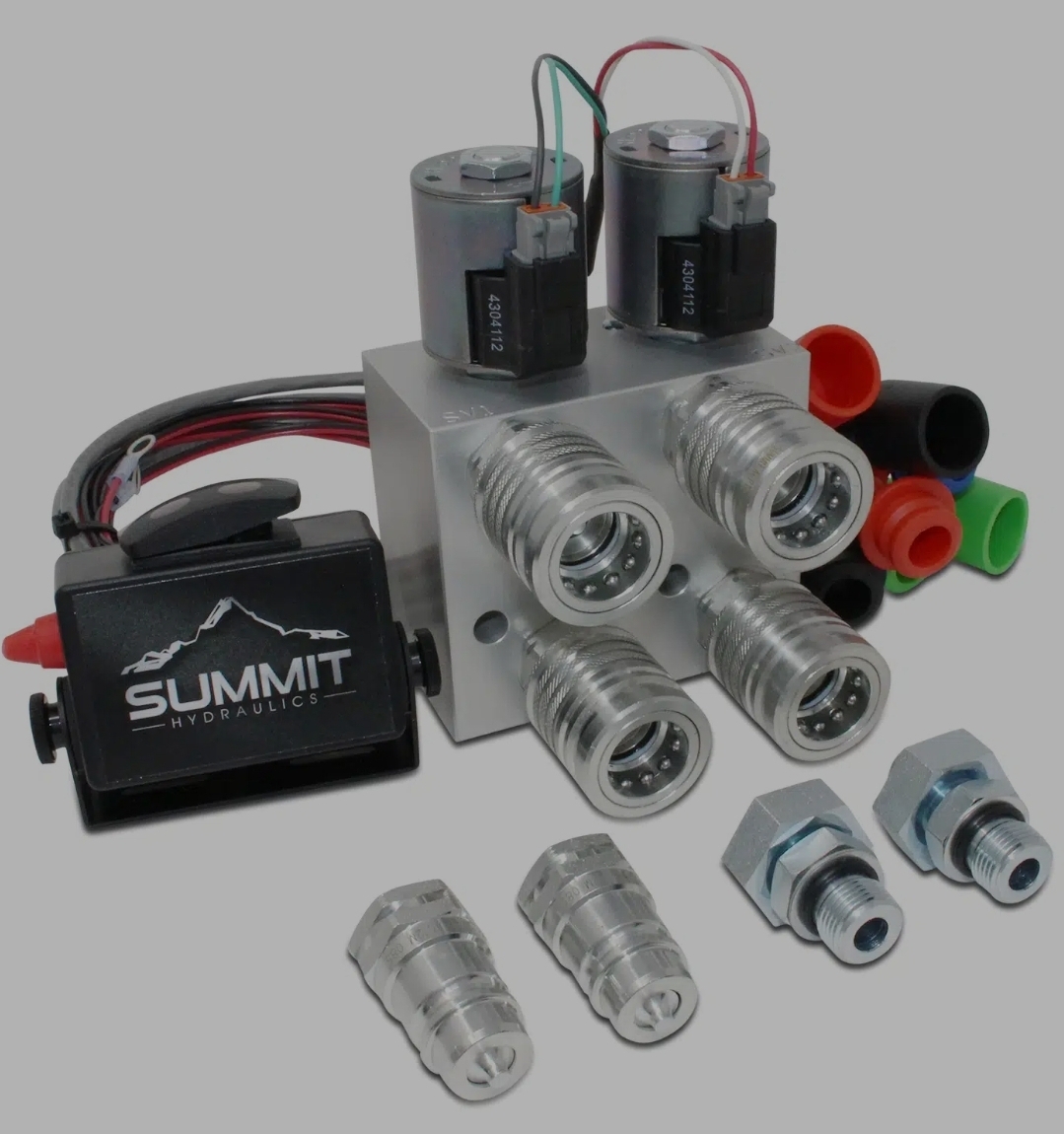

What are you controlling it with?
Are you going to power the rotate function of the chute as well?
   / Mk Martin snowblower hydraulic deflector
#13
I ordered the blower with the hydraulic chute because I knew I wanted that and it was coming in the winter. Needed it usable right away. My tractor came with 2 remotes in the back. I added Multiplier from summit to use a 3rd. I have one set for my hydraulic top link and can switch between the rotation and deflector from the other remote by pushing the button

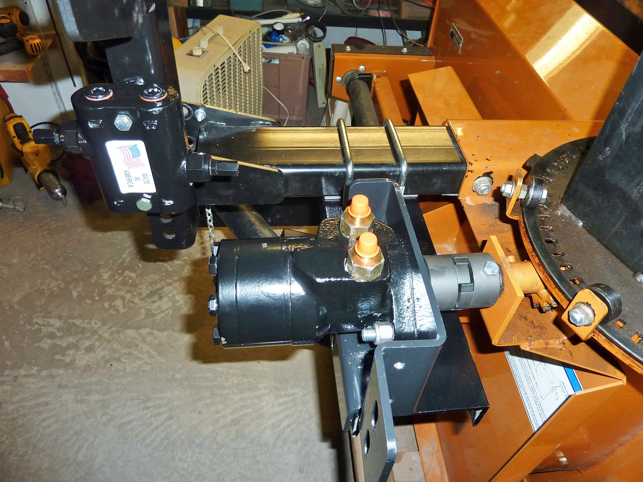

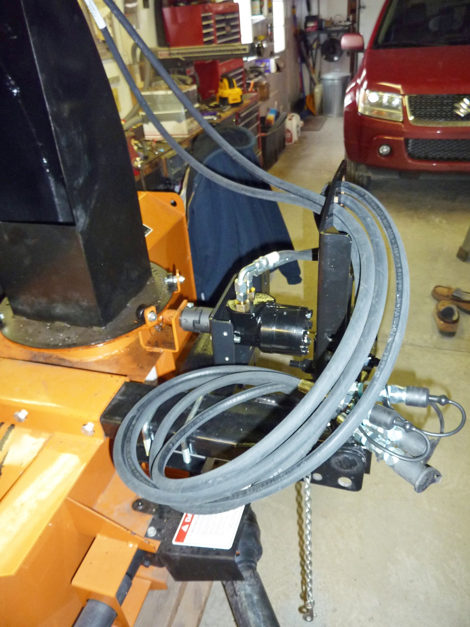

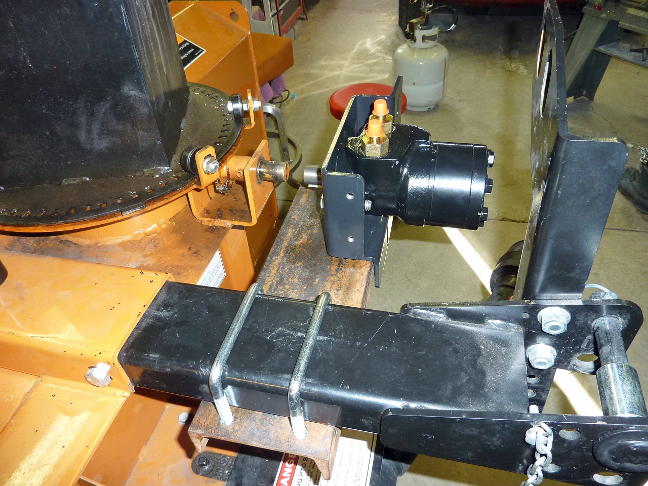

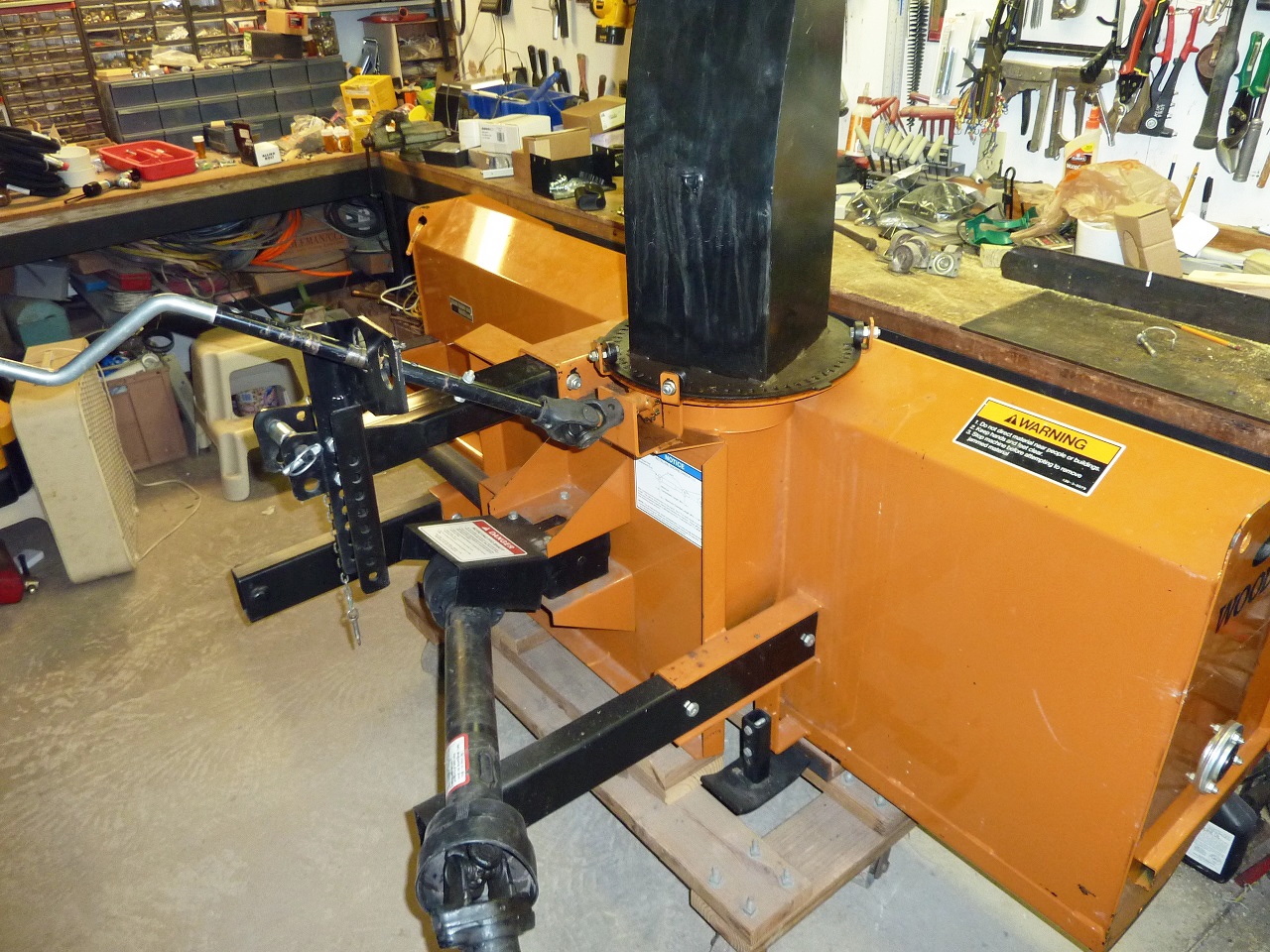

I was in the same boat 10 years ago when I bought my Woods SS74 blower. They wanted $675 for the hyd. chute rotator and deflector package. I had an open station tractor at the time and it wasn't a big deal to reach back and work the chute manually, so I passed.
Fast forward a few years when I bought a cabbed tractor. Working the chute now meant getting on and off the tractor. I began to wish I had spent the money when I originally bought the blower. I searched but found the hyd. chute was no longer available for the SS74.

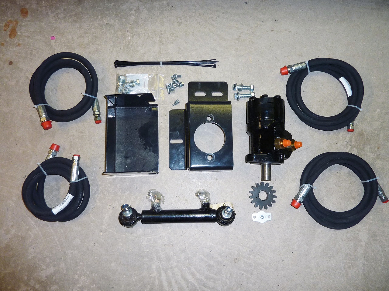

I searched a bit more and found this Woodmax combo chute and rotator kit for $475:

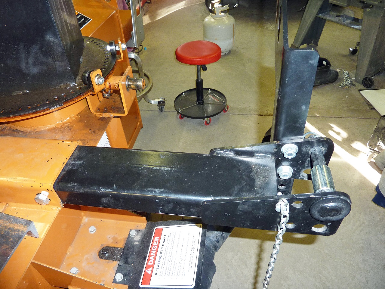

It wasn't much work to modify it to fit the Woods SS74. A piece of 6" channel iron and a few odd parts were all that was necessary.

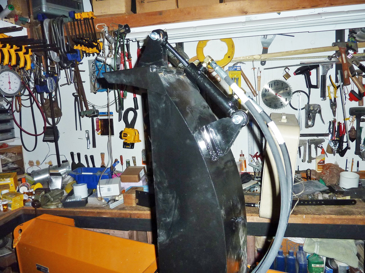

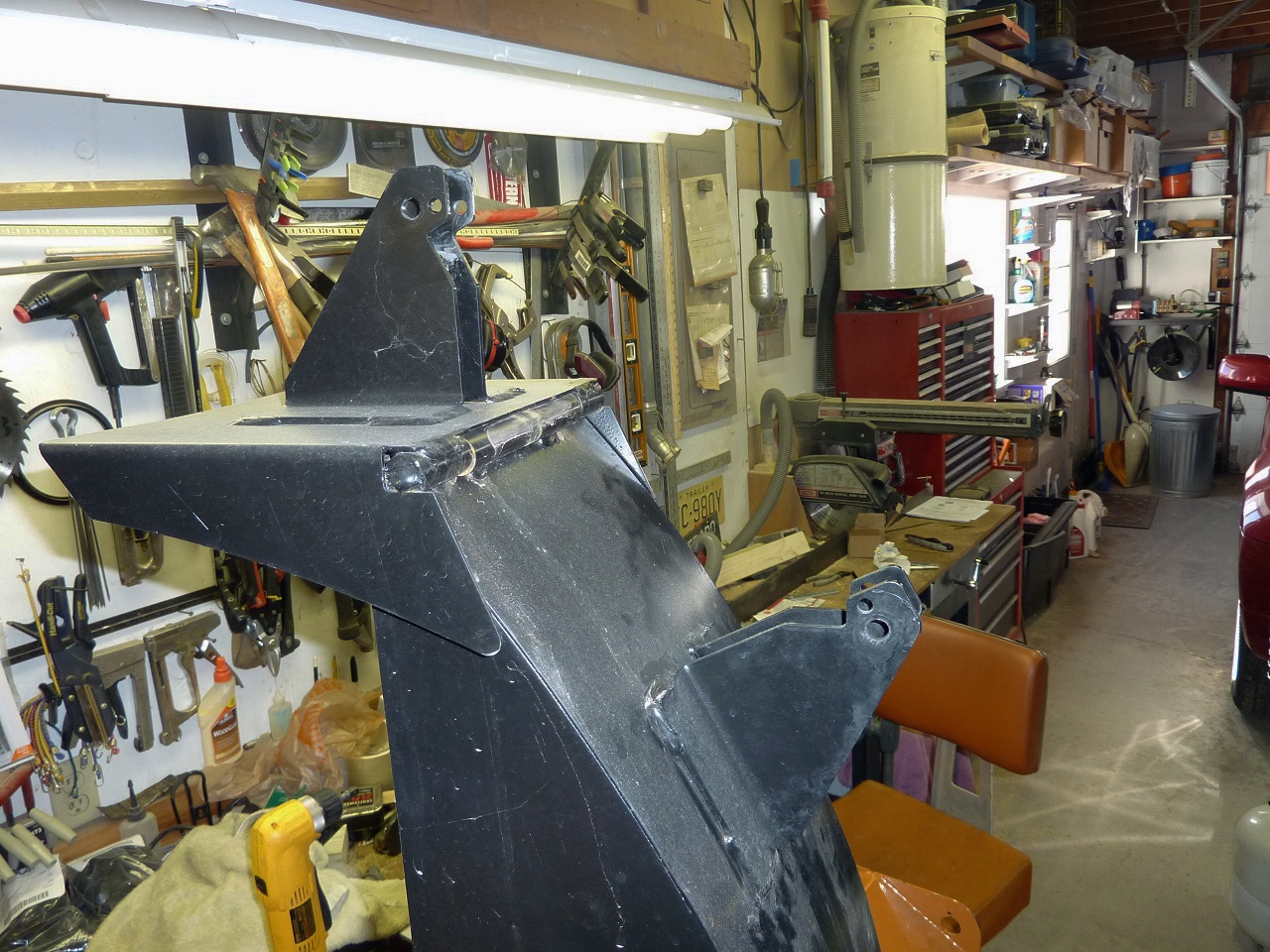

Adding the deflector cylinder to the chute was the hardest part. I had to cut off the existing brackets and re-weld them in a different location:
The project took around 8 hours and IMO, it was time & money well spent. I can blow snow from the cab in a T shirt without having to put my Carhart's on to get out and make adjustments.

I'm looking to copy your setup. This is great! With the 3/8" hose and the flow restrictor, how is the speed on the deflector? Would you go more flow to speed it up or is it perfect? Do you happen to have a video of the setup in action?
   / Mk Martin snowblower hydraulic deflector #17
I'm looking to copy your setup. This is great! With the 3/8" hose and the flow restrictor, how is the speed on of the deflector? Would you go more flow to speed it up or is it perfect? Do you happen to have a video of the setup in action?
Sorry, no video available. I haven't needed the blower for the last 2 seasons due to lack of snow. Early predictions are, I won't need it this year either.
I started with .045 restrictors but the action was too fast, so I replaced them with .030's. With those, it takes around 5 seconds to turn the chute 270 degrees. It takes about 2 seconds for the deflector to fully articulate. This will vary from tractor to tractor though due to variations in flow rate.
In both cases, I'm cautious to not hit the stops for fear of stripping the sheet metal gear on the chute or bending the cylinder mounting tabs on the deflector. I need a crossover relief valve with a lower set pressure to prevent this but so far, I haven't found one. I tried to find the valve used on the Woods kit but the part is no longer available. The Woods SS74 is so old now, "for parts" units are showing up and I may have luck finding one.
