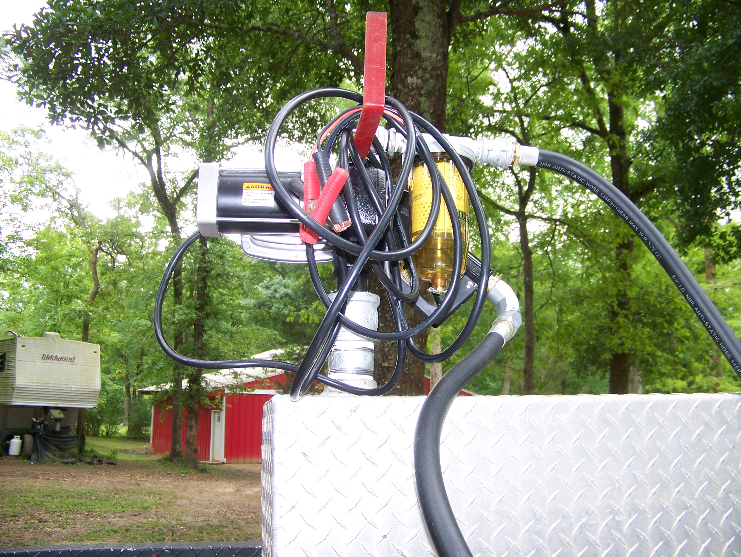

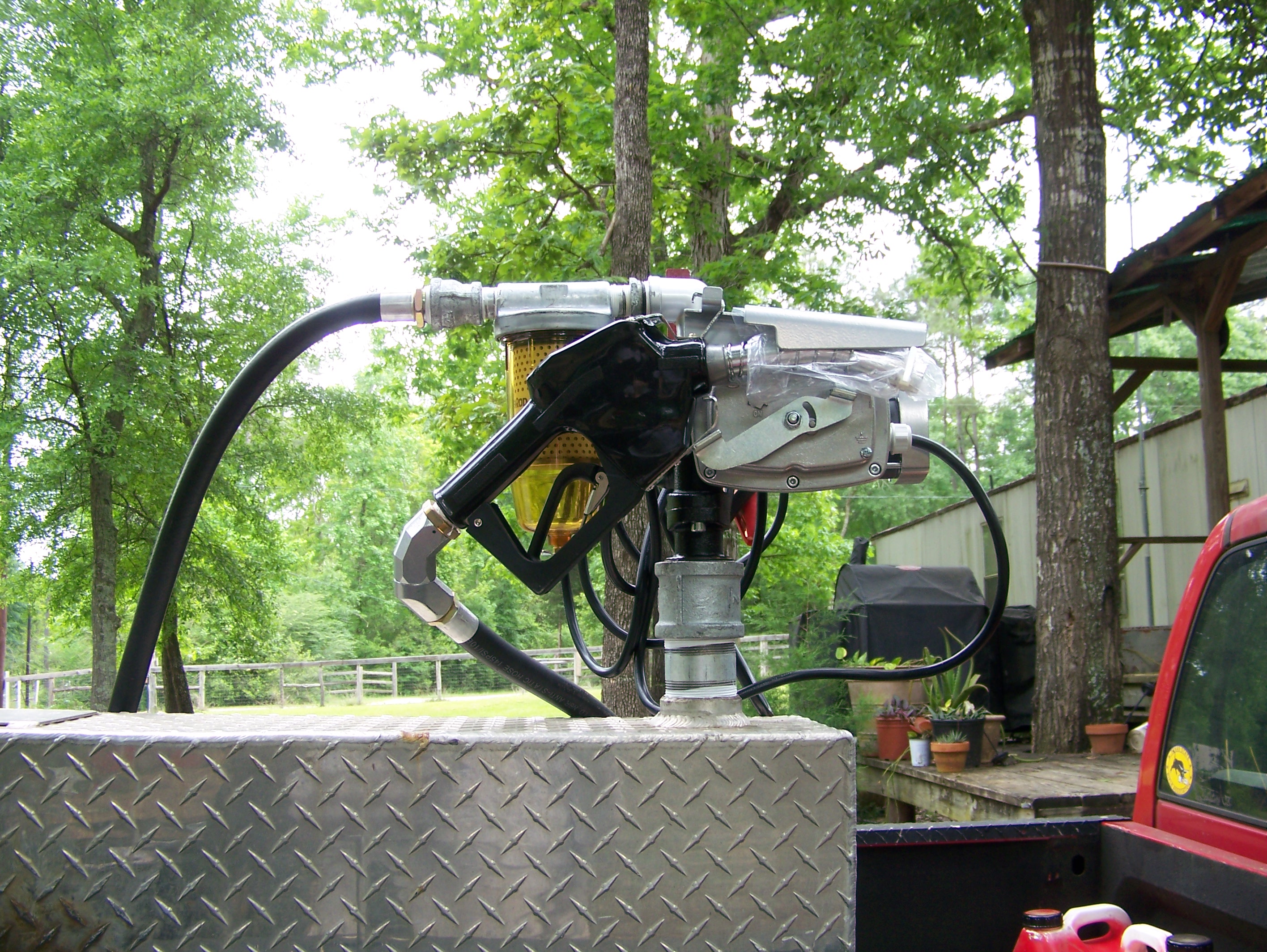

I finished all the plumbing yesterday and loaded her on the truck. I picked up 98.8 gallons today of off road fuel at $1.57 a gallon. Got her home and added 32 ounces of Power Service. Then I tried it out filling the sawmill's fuel tank. I still need to run remote battery studs on the tractor. Today, while filling the sawmill, I just moved the zero turn mower nearby and flipped the seat up for battery access.

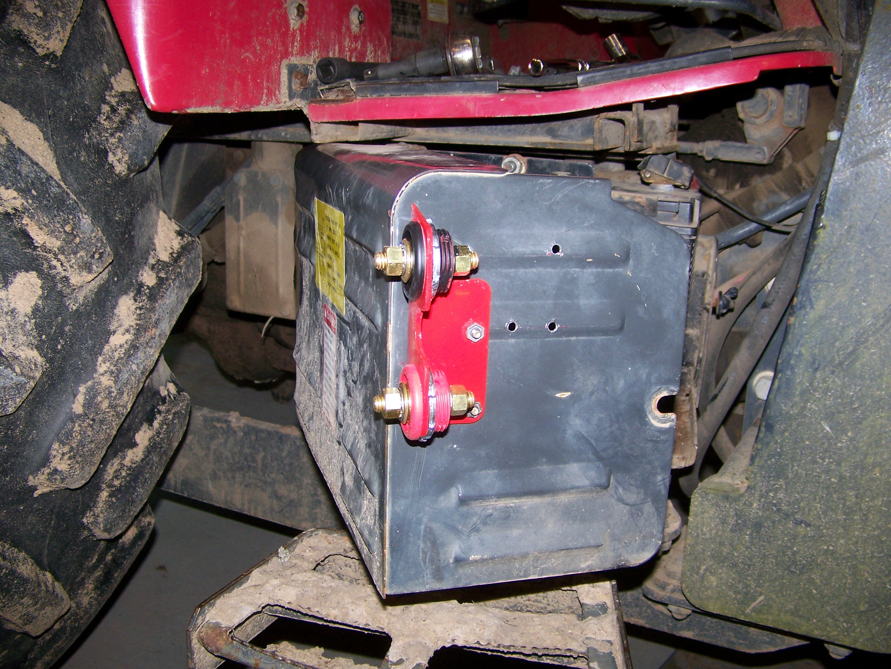

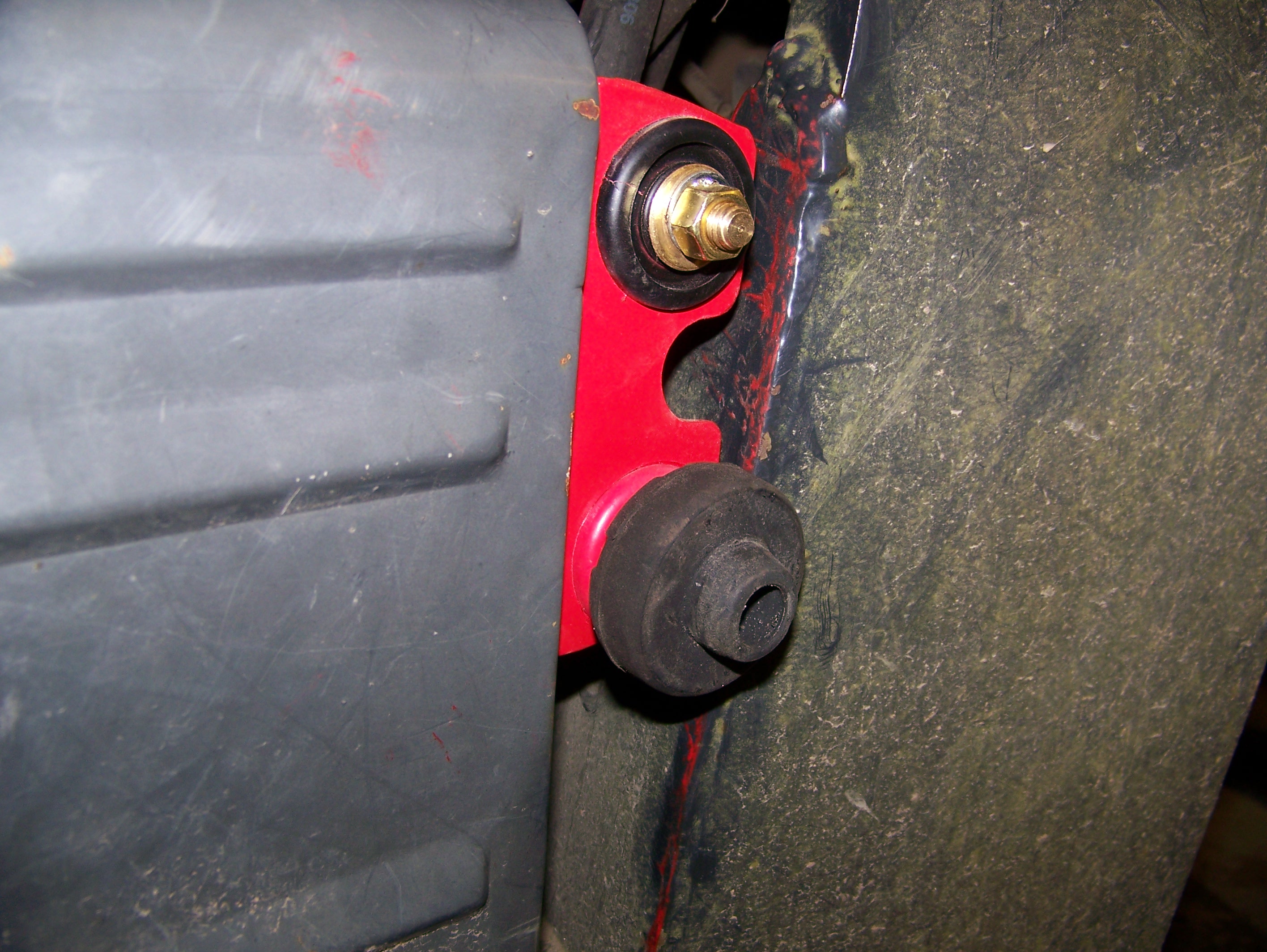

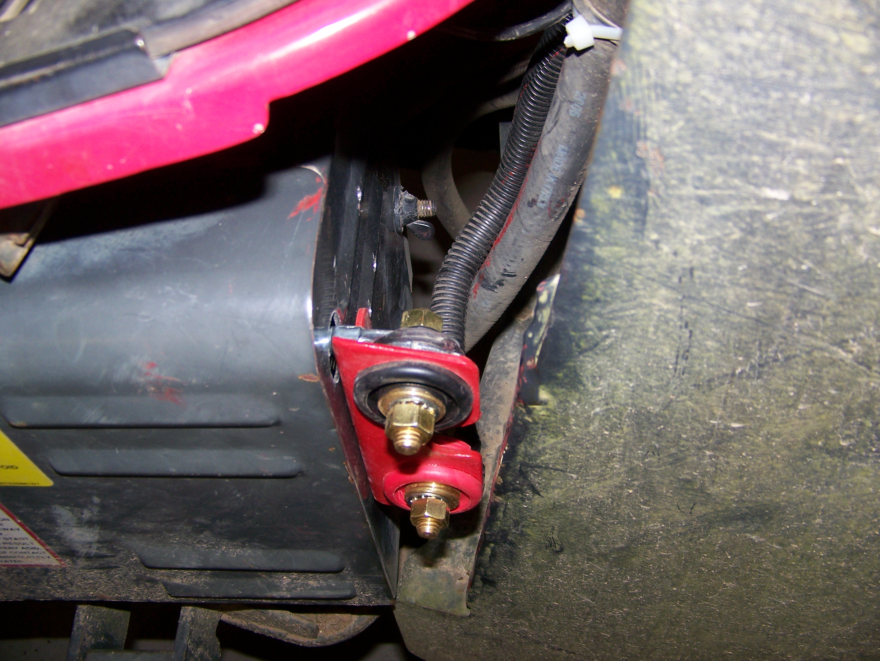

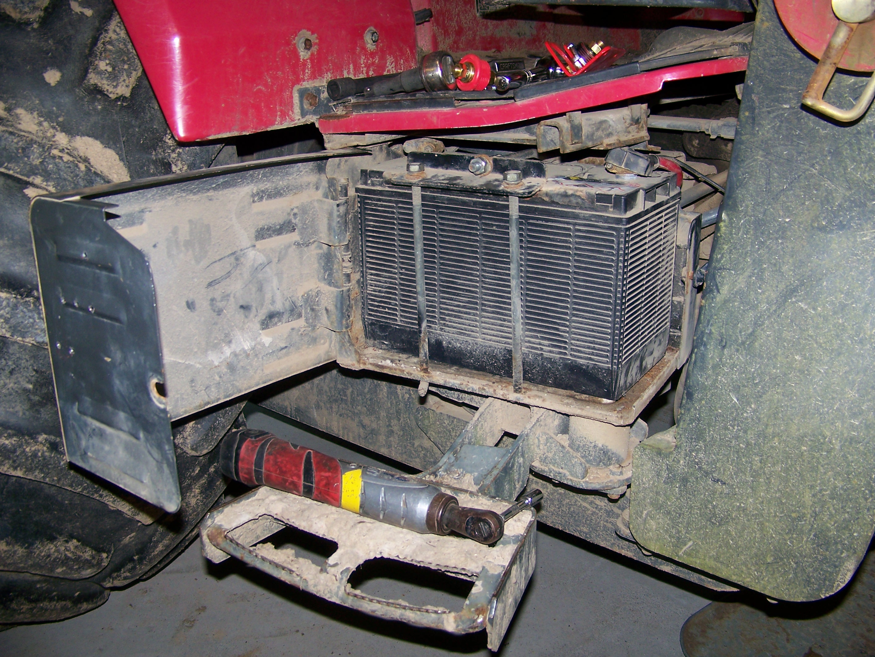

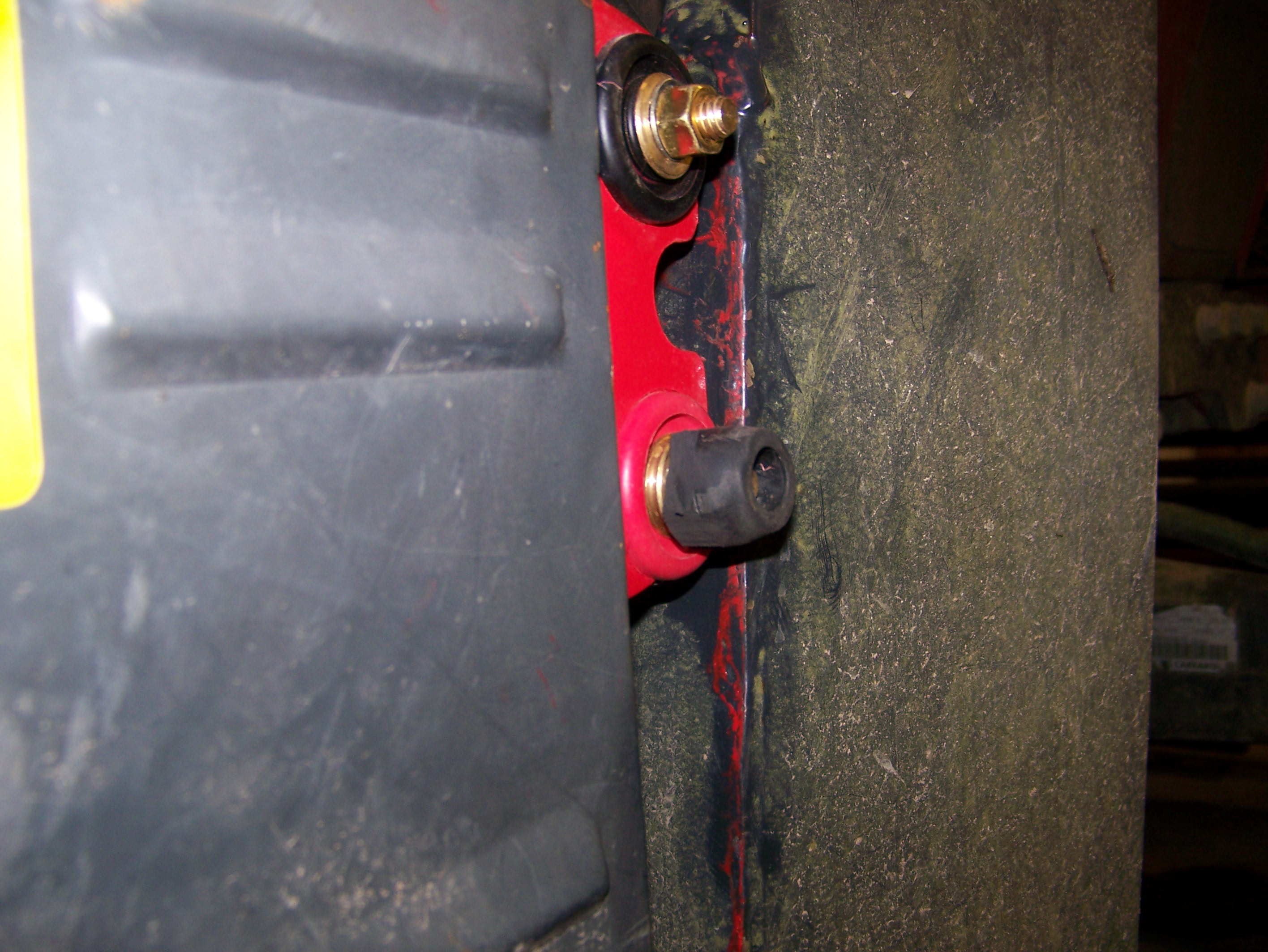

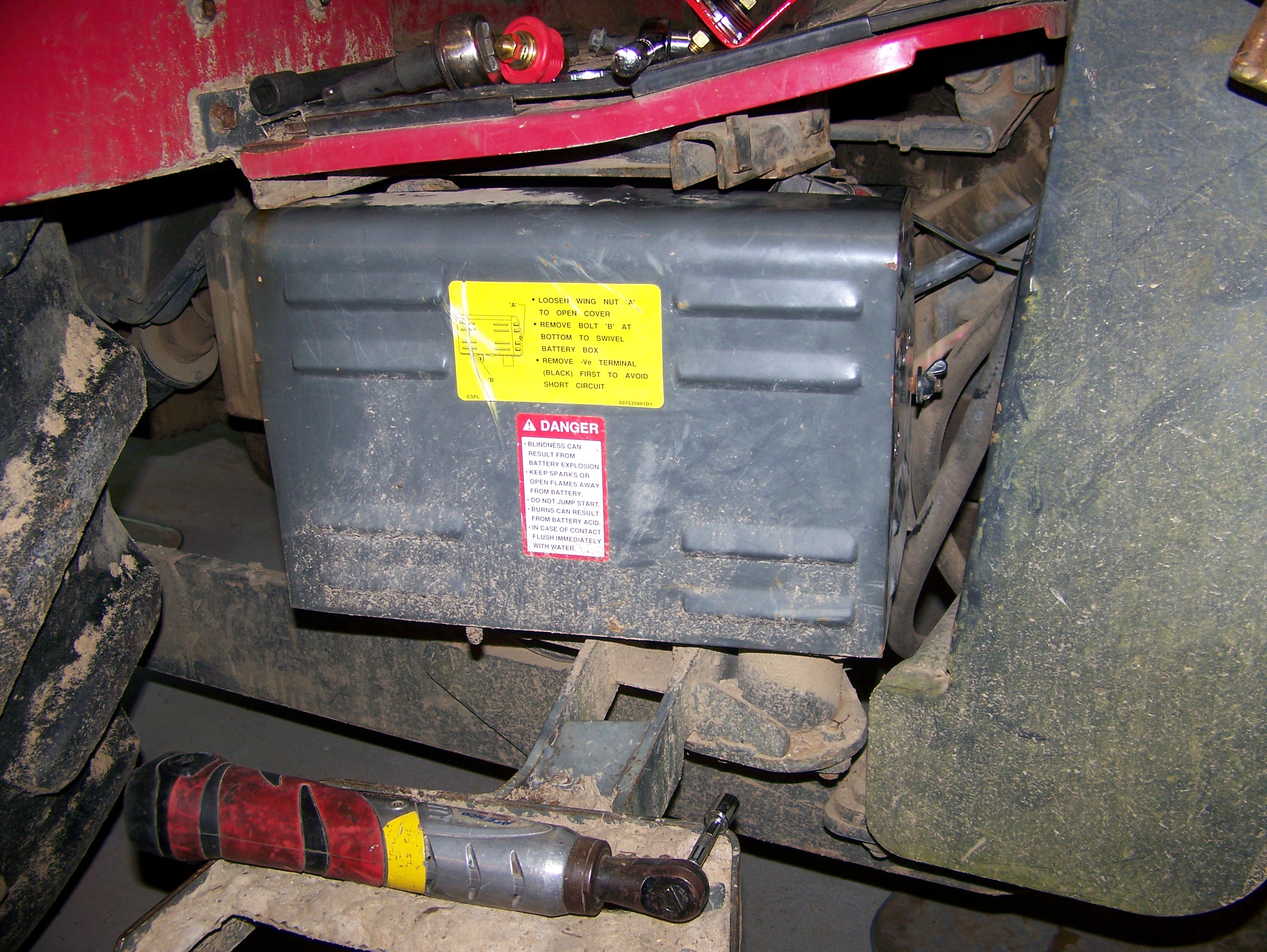

I wired in the battery jumper terminal yesterday. Here you can see how to get to the battery. The cover swings open. 4-12-20 Mahindra Battery Box Open.jpg4-12-20 Mahindra Battery Box Before Mod.jpg The whole thing swings the other way for removing and installing a battery on the tray. I used a bracket I made years ago for the QDs on the loader. The connectors are bulkhead fittings for external power starting on race cars. 4-12-20 Battery Jumper Ground Wire.jpg4-12-20 Battery Ground Wire Closeup.jpg Ground wire goes through the side of the battery cover. 4-12-20 Battery Jumper Ground Wire.jpg The positive wire was installed in split loom coax. 4-12-20 Battery Positive Split Loom.jpg I wanted to cover the external positive. I save old shock absorber bushings. 4-12-20 Positive Stub Rubber Bushing.jpg I cut one down to make as low a profile as possible. It takes a good tug to pull it off. 4-12-20 Positive Stud Rubber Bushing Trimmed.jpg
