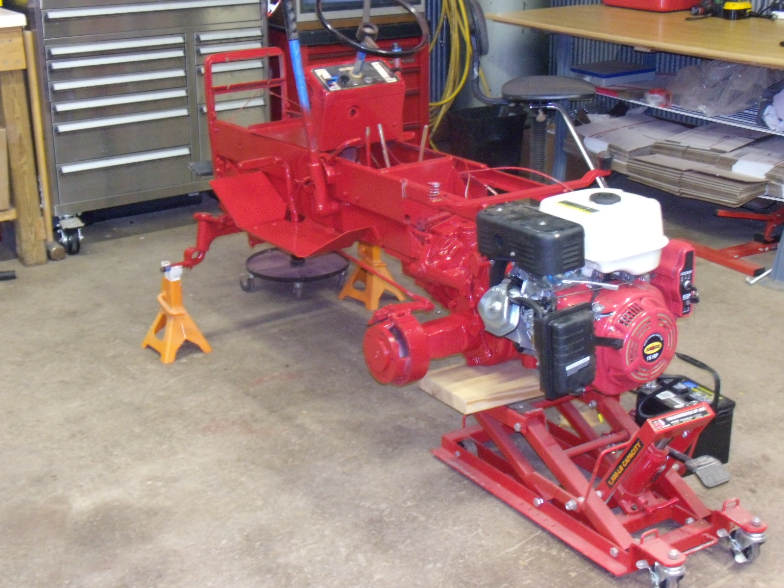

I'm new to this forum but, here is a repower that Gravelymay helped me put together. He helped me on another forum. Its a 1967 424. With Bruces help and his adapters etc, I put a 16 hp Honda knock off on it. I drove it a short time after I got the engine on it then decided to take it apart and restore it. The repower was a breeze with his guidance.

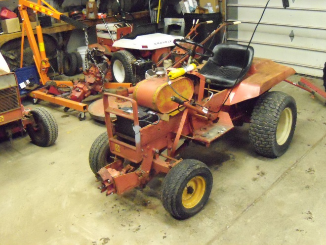

What in the world is that behind your tractor? Is that a combination wheel / ski sulky? Whatever it is, its cool!
   / Model L and Model C Repower Parts #19
Hi! The thing is a one wheel sulky. I make it four years ago for mowing large area. You can run on seat (As motorbike feeling) or upright on footboards. Turn more tight than a two wheels sulky. Never bump trees etc.. I like it . Good luck! Oldmech
