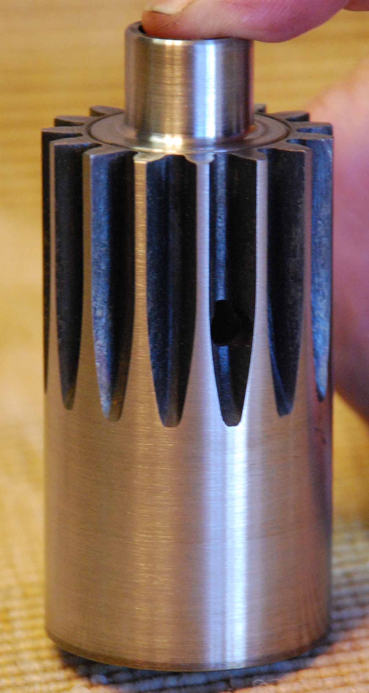

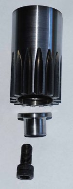

Repower to 1 inch crank Engine parts :thumbsup:

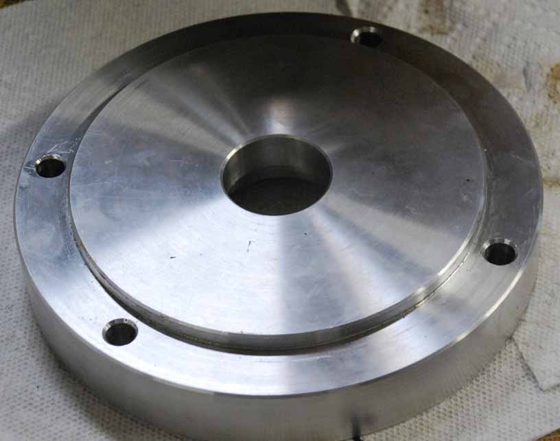

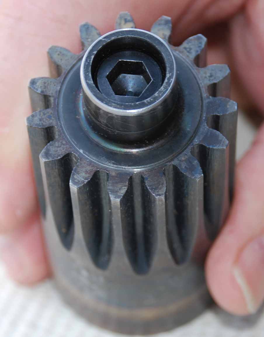

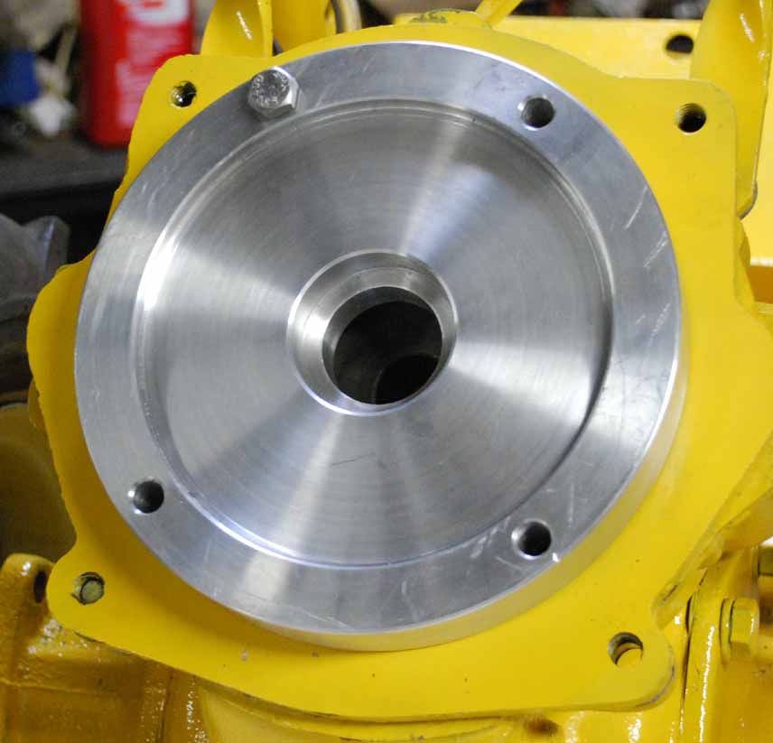

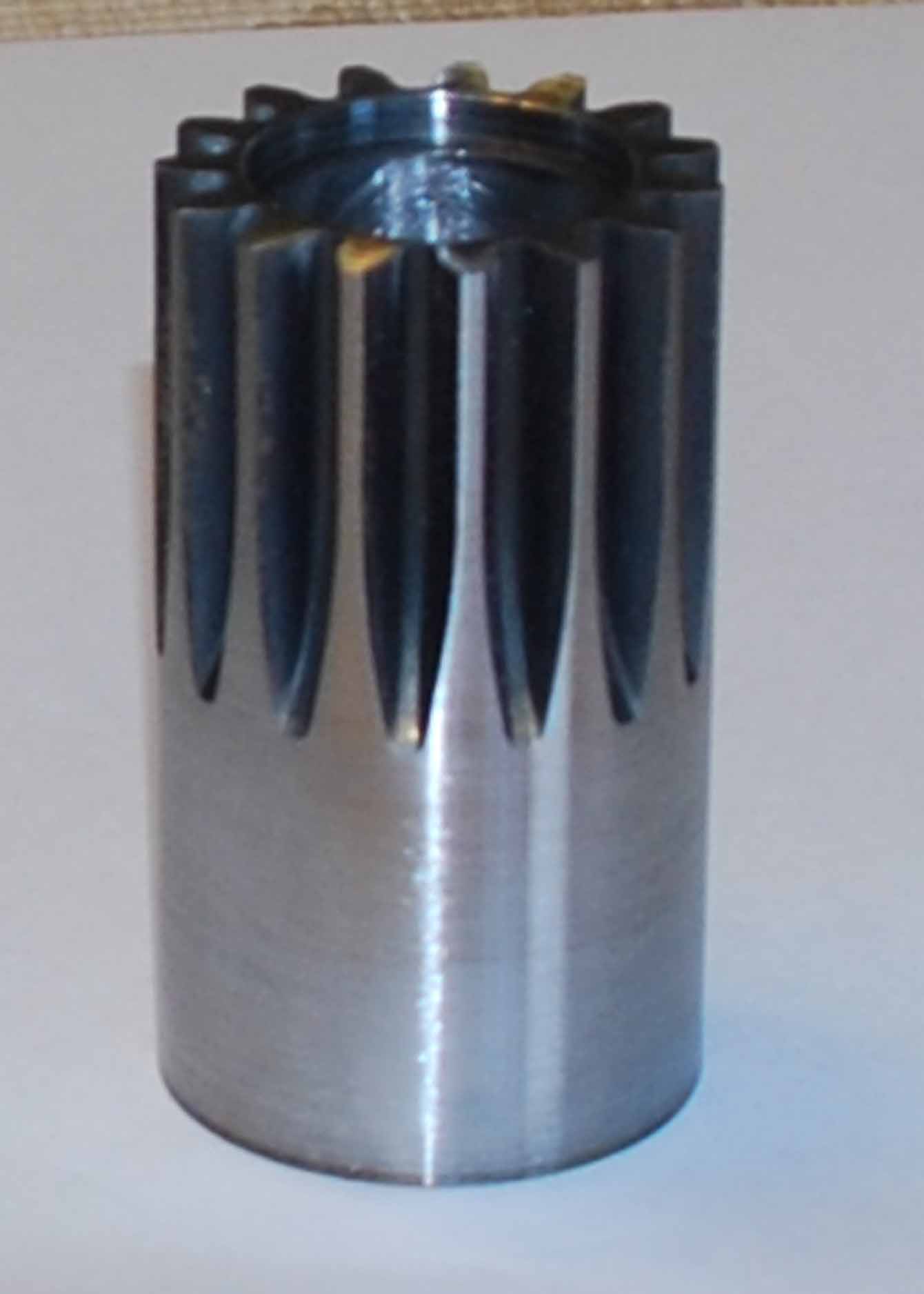

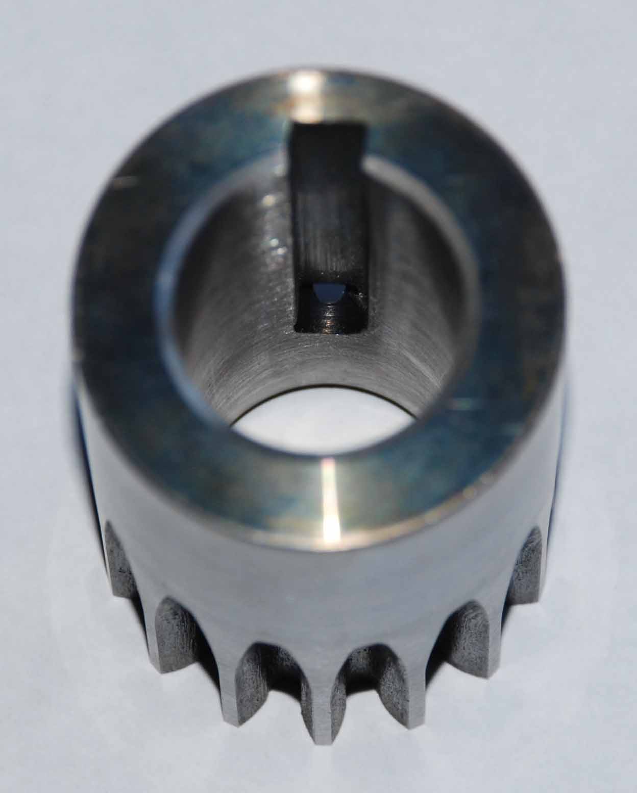

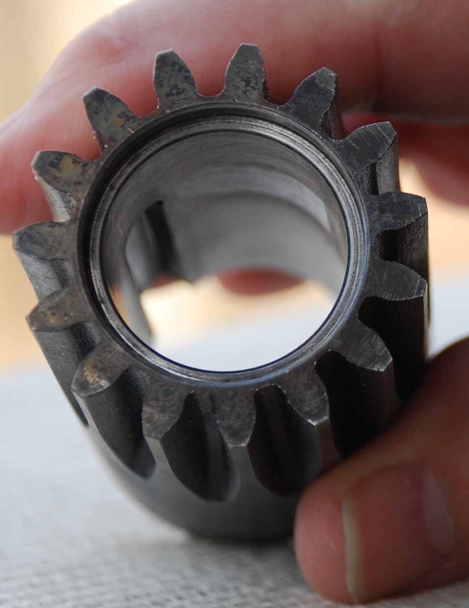

This gear can be used for repowering the L Model C8 & C10.
It is made for 1 inch dia crank shafts 3.3/4 long
also can be used on 3.00 long crank shafts
For repower over head engines.
Here are some better pictures.
Thanks Bruce g

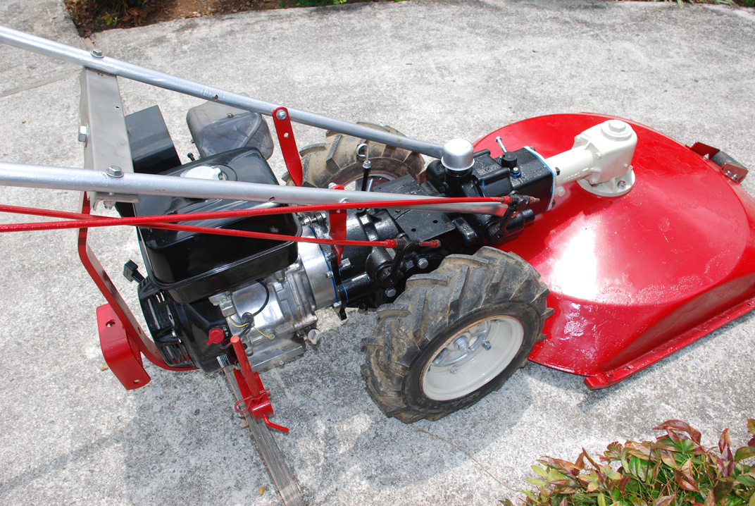

Here is a LI Frankenstein That I put a 13 Hp Honda on .
Runs out good :thumbsup:
But the wheels are to close to the deck.
It don't have a remote control lever for the PTO.
The forward & reverse lever is backward to me.
I plan to fix all three.
Thanks Bruce g
