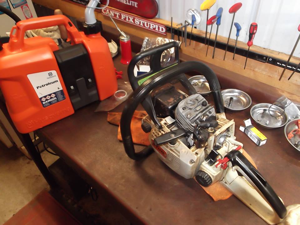

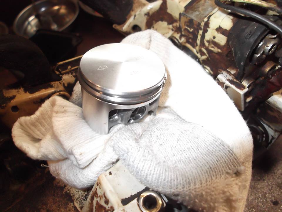

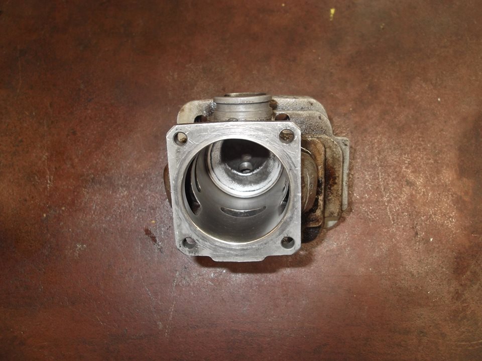

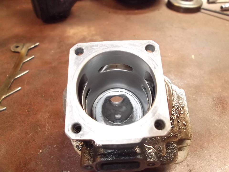

Just muffler modded this 026. Sounds pretty good to me for 44mm 49cc.
Gave it a new heart yesterday and cleaned up the scored cylinder and then put a fresh crosshatching in.
