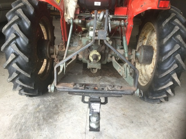

I'm hauling people including children on a small light trailer up and down hills.... would hate to dump them out because they unexpectedly moved to the back and made my lift arms suddenly go up
Good point, the fixed height is essential for that use.
I've twice now had my watering trailer do that when I bumped the lift lever. Its so heavy that I had to use the HiLift jack behind the trailer to tip it back down. I finally set the raise-lower limits to a narrow range for that application.
I now pull off the drawbar like the OP does but in the olden days when I pulled things with a bar on the three point arms, I learned to add stay straps (like the 8N, 9N) to prevent the arms from spiking up and killing someone.
After carefully loading furniture grade ash logs on a trailer I hit something coming out of the woods, dumped the logs in the mud and nearly launched myself out of the seat. It took 8 or 10 years but the stains finally came out of my shorts. ;)

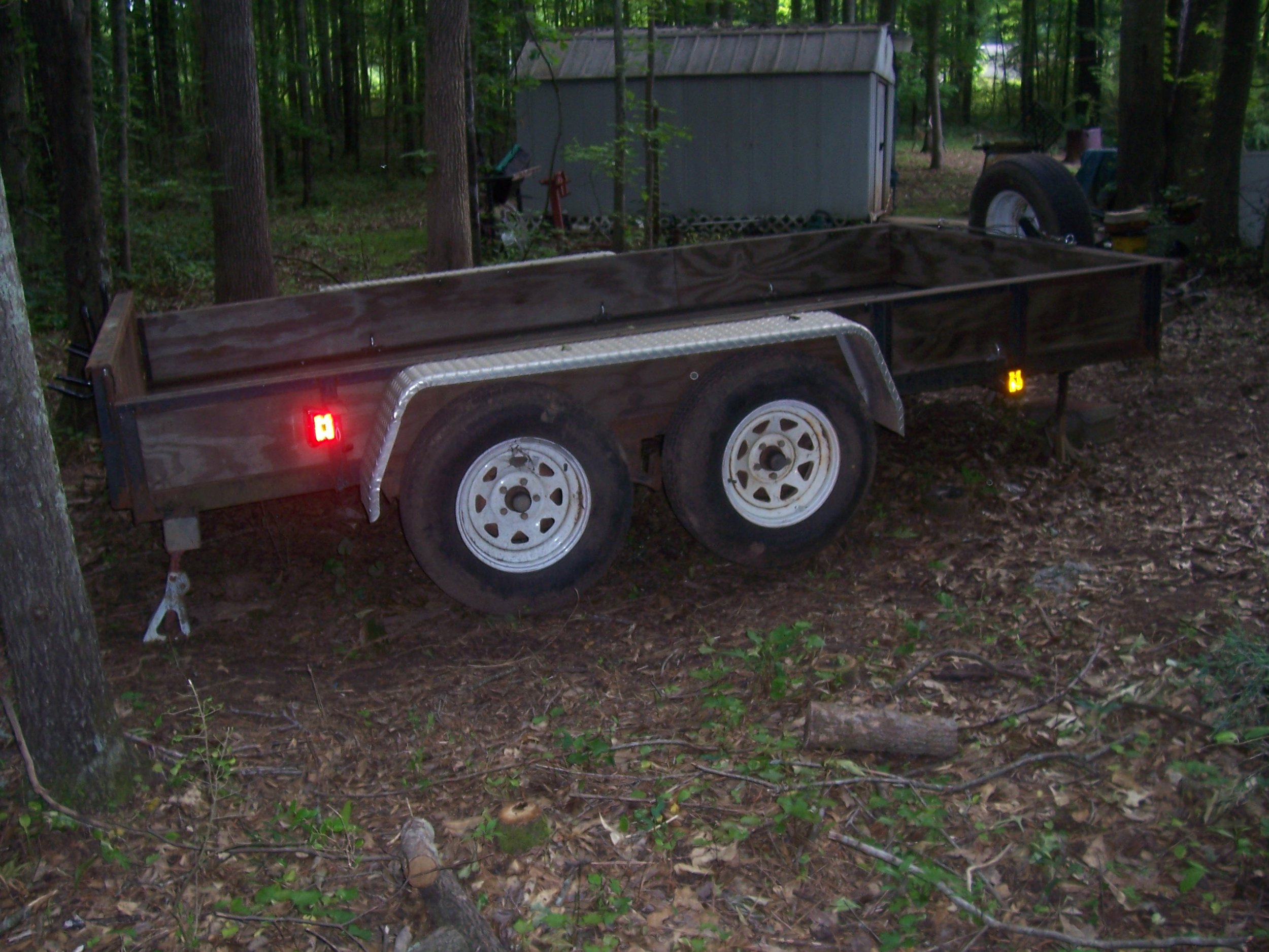

The Ym.2000 won't kick it up. Even tried to make do it. You may need to stick with a little garden cart to be safe. I have it lifted going through the Duel axle Brakes and Tires. See the Jack stands. Never gets close to being unlevel sitting hooked up.

Now I understand why the extended draw bar. The running gear on the farm wagon I built has an extended hitch. Prevents wagon contact with rear tires. Still learning - how to back up with steerable front wheels. Ten ton - 8'x12' deck.

Another solution if you're just moving trailers around: a front trailer ball.
And mount it low enough to get under the tongue of a parked trailer. A ball on top of the loader bucket would likely be to high to do this.
