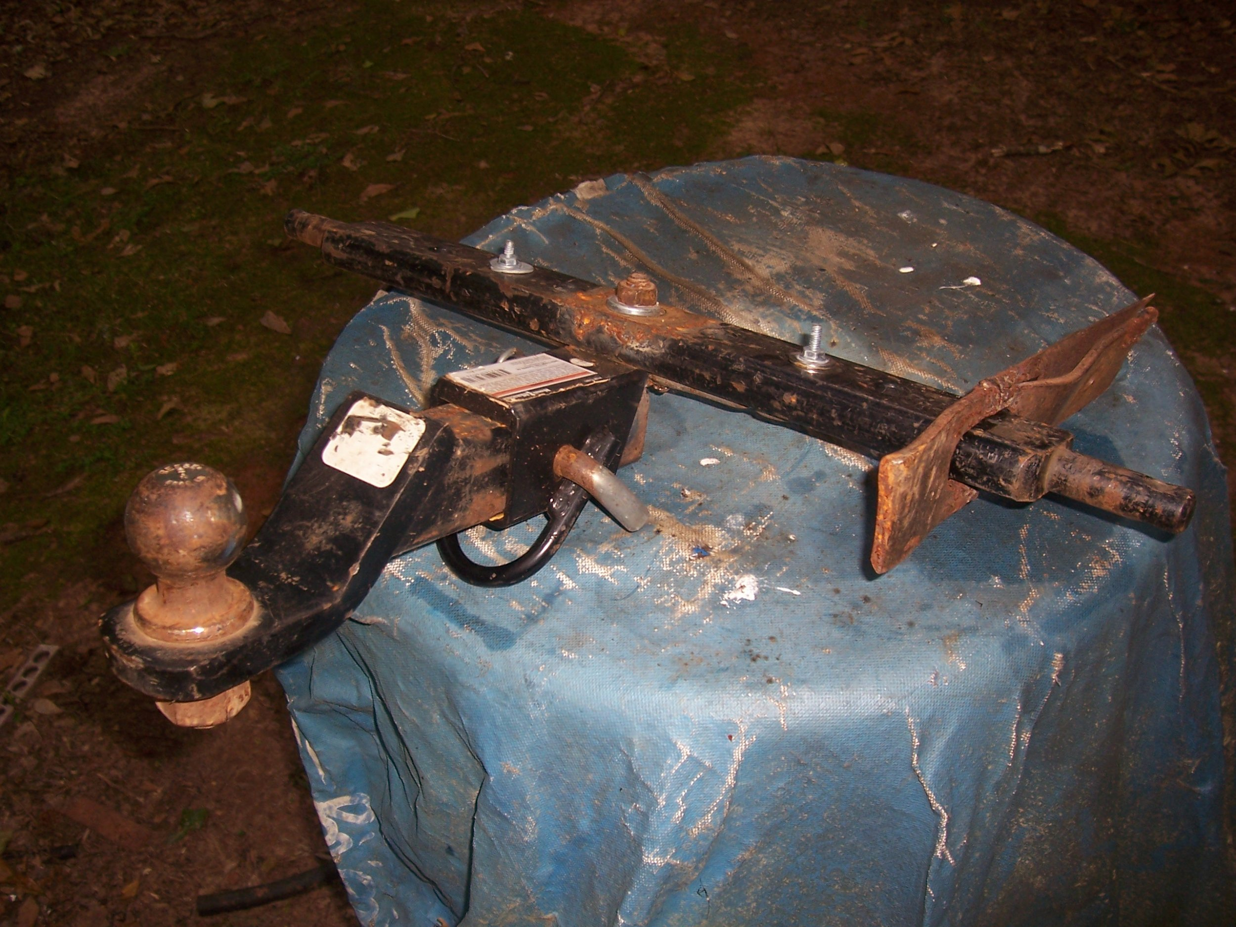

Me Either about welding. Only reason I can is I had to learn to do some simple things. I done this a few yrs. back just in case which after doing it works really well. Only had to use a few times. I have large trailer I use it for if I had to. I don't want to bolt to my Rear end. So I don't want to bust my housing. Plus with the HF. elcheapo Receiver.. I can easily hook the small garden trailer to the loop also. I use it the most. Those are two Sear mower blades I think. 🤨 Hey!! it's ugly but works great.

Nice work.
Not all H-F products are cheap quality. In fact, there are nearly 15,000 posts right here on this forum about the quality ones H-F does offer. ;)
Harbor Freight Tools that don't suck
Before the H-F ext. hitch, the Reese one I had broke. I wasn't going to spend money on a Reese replacement at 3X the price of a H-F clone at the time. In fact, I'm really impressed to tow 12,000-lbs 20ftx8ft enclosed travel trailers loaded to the max with the H-F setup. Only the RAM Hemi 2500 or the Sierra Z71 can move these trailers. The YM2610 with the H-F setup can as well. Nothing else can move these trailers around on the farm needing the raw power and lower gear set.

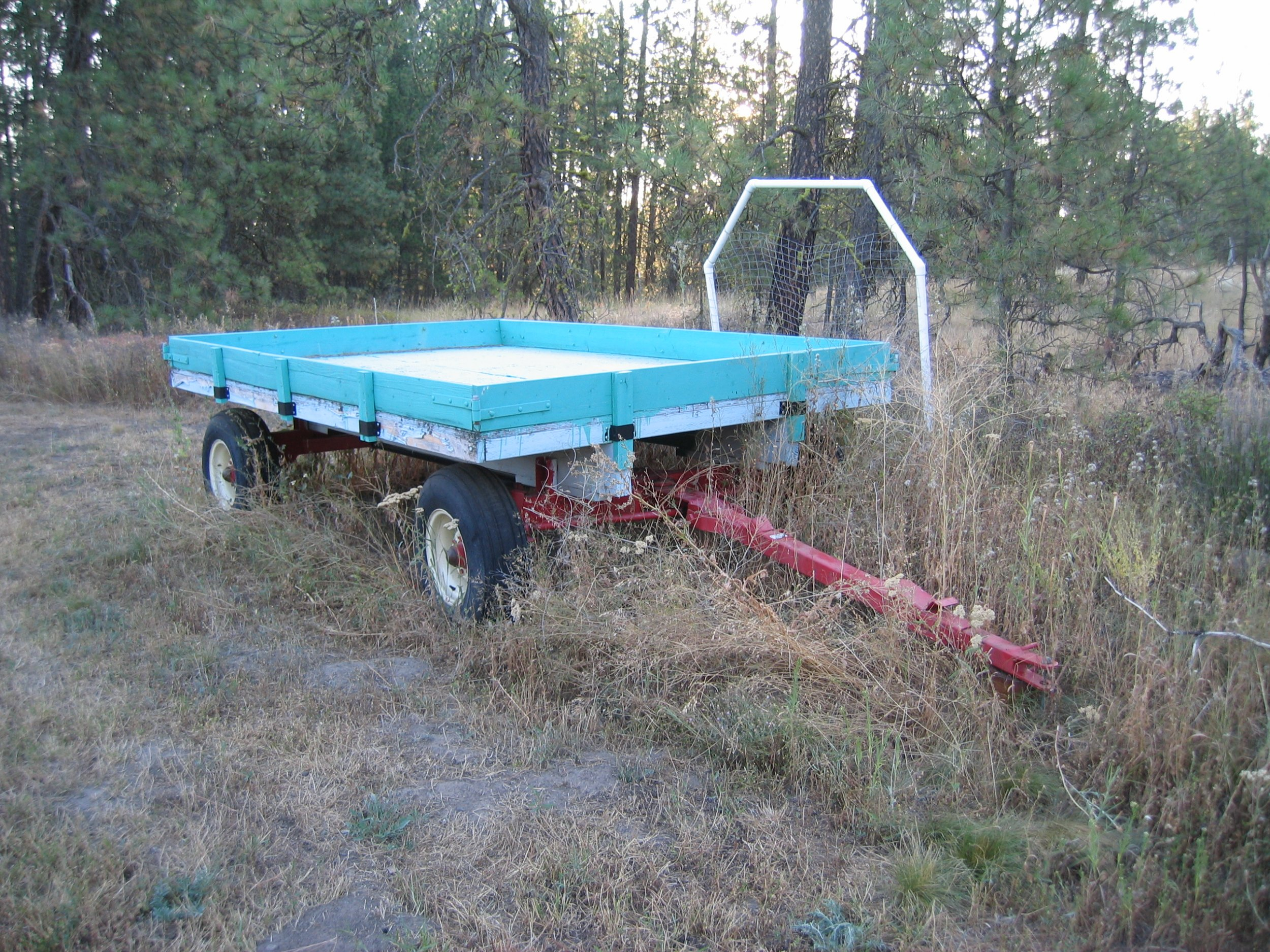

Now I understand why the extended draw bar. The running gear on the farm wagon I built has an extended hitch. Prevents wagon contact with rear tires. Still learning - how to back up with steerable front wheels. Ten ton - 8'x12' deck.

Cheap may be a good thing Esp. $ wise... Here you go!! Elcheapo all the way but I'm good with it when this was all it cost me. I got plenty out of that mower blade also. Can't complain ...... ATV Hitch Adapter
