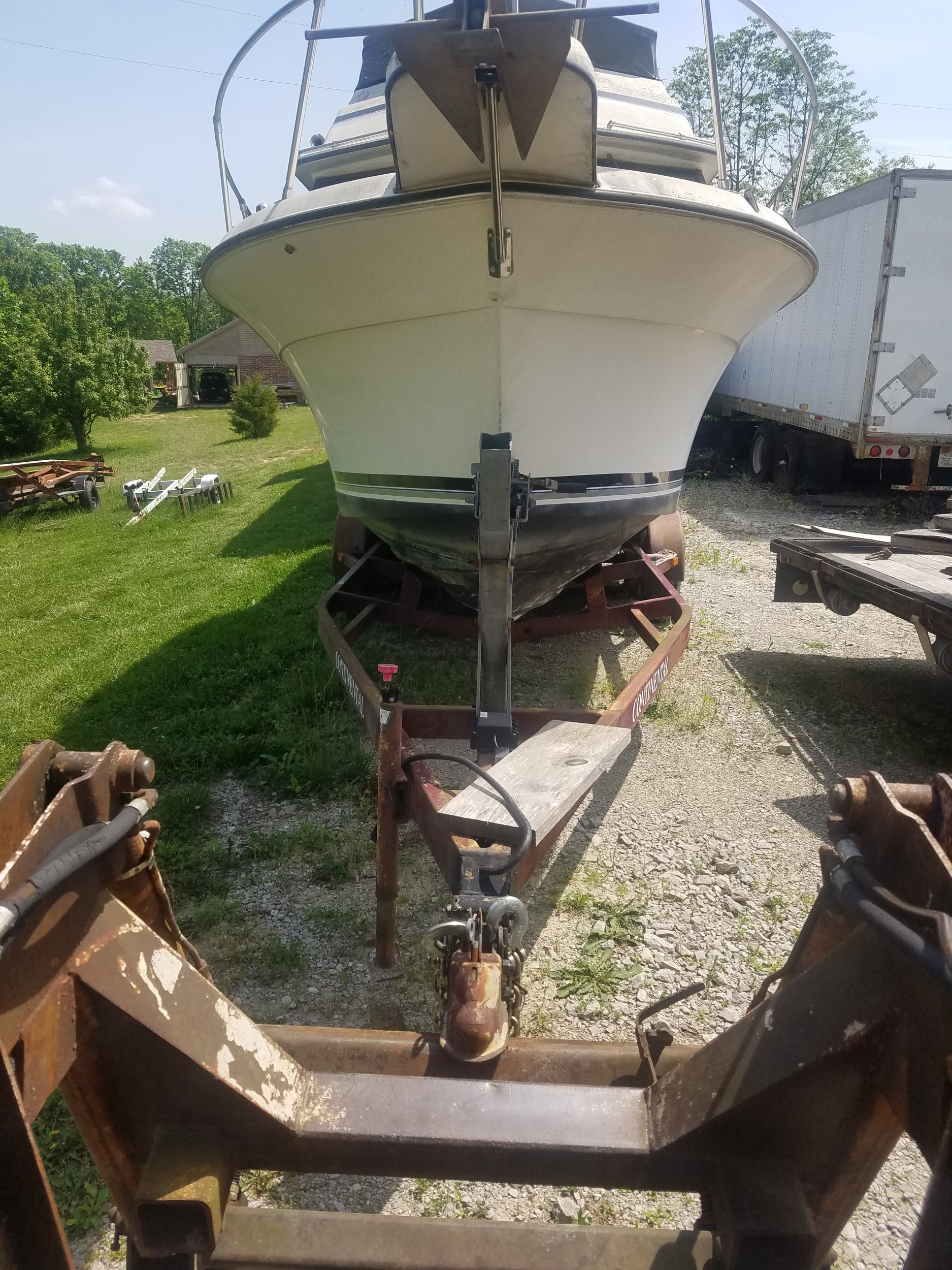

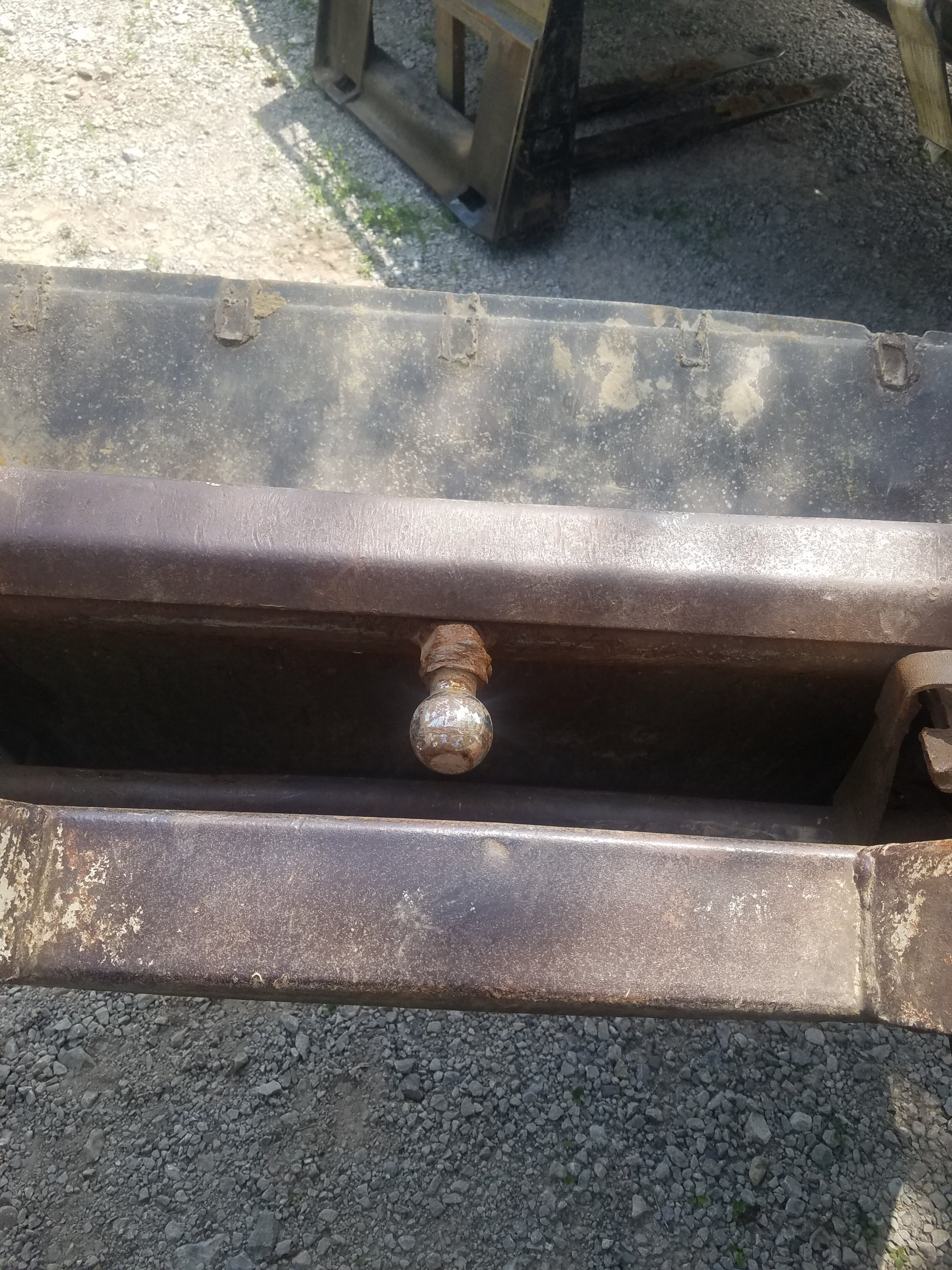

Another solution if you're just moving trailers around: a front trailer ball.
And mount it low enough to get under the tongue of a parked trailer. A ball on top of the loader bucket would likely be to high to do this.
kimg2005rhitchonym186dbucket-jpg.511565
Yup... I have a trailer ball welded on the quick tach top bar on my bobcat M610... super handy to just drop the bucket and go

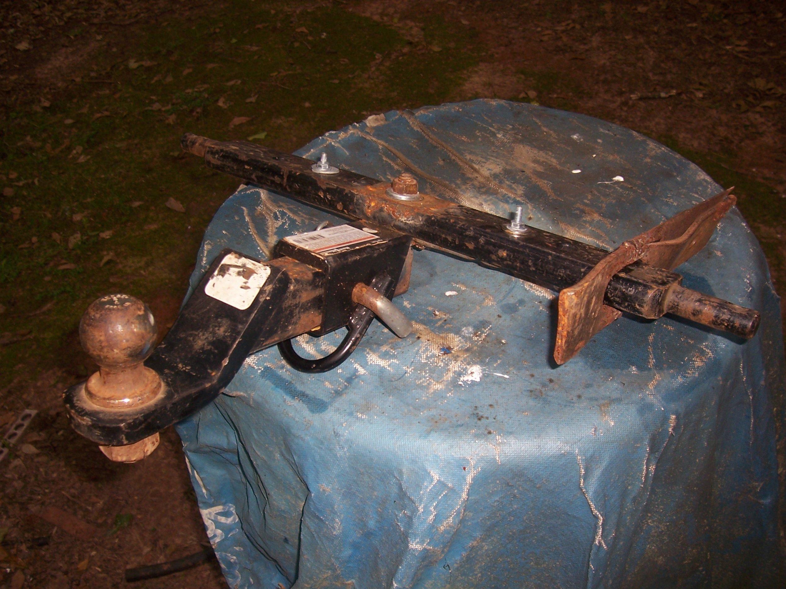

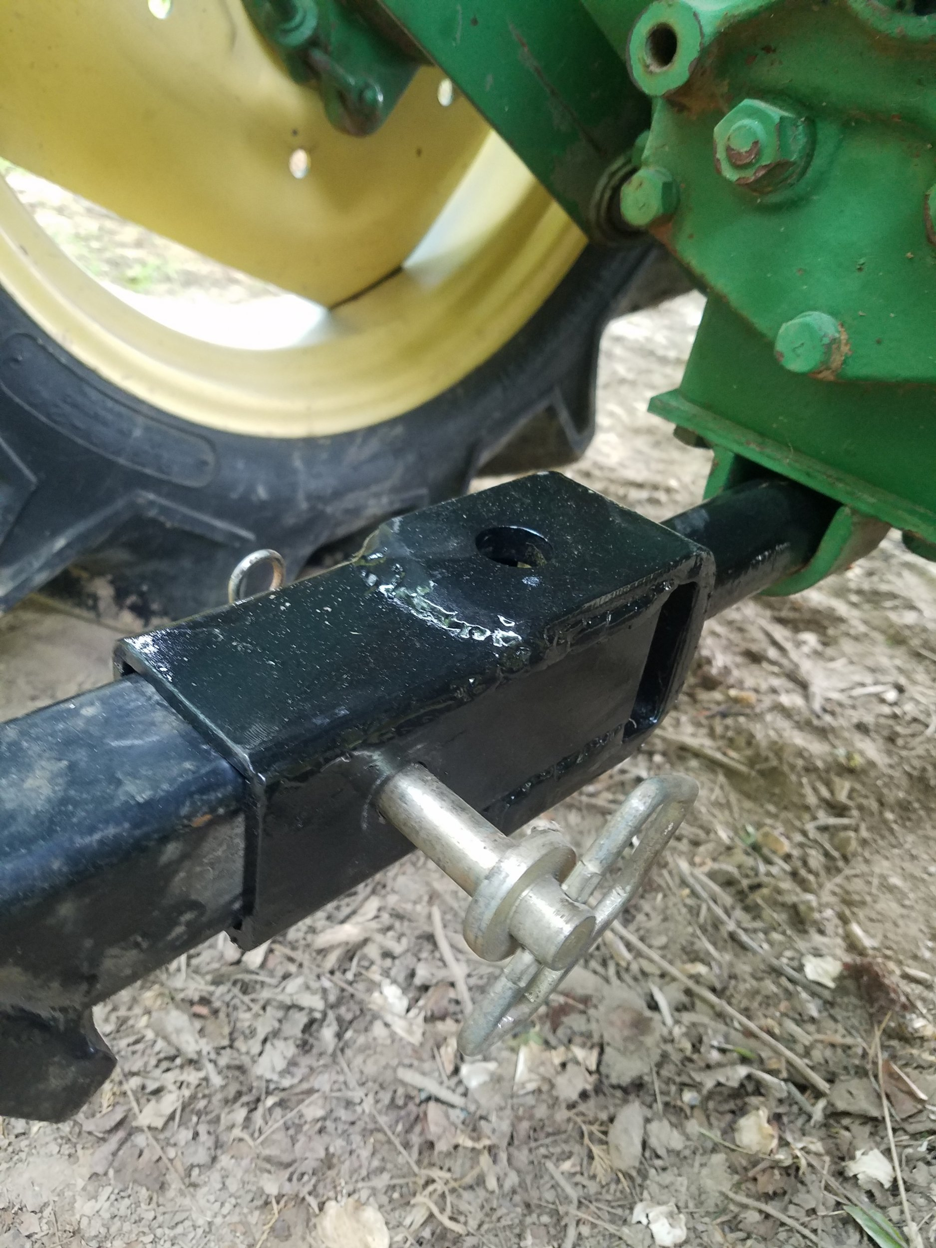

See attachment, hitch receiver on drawbar. Alos, Hoye's four infh wheel extenders are visible.
That was the way I seen it also. But no extra 3pt. and I wasn't removing one for the very few times I use it. Plus I don't have to hook up the top link. Factory hole in the arm. Easy as long as your put the bolt in before you lift it. :confused: leave it there.

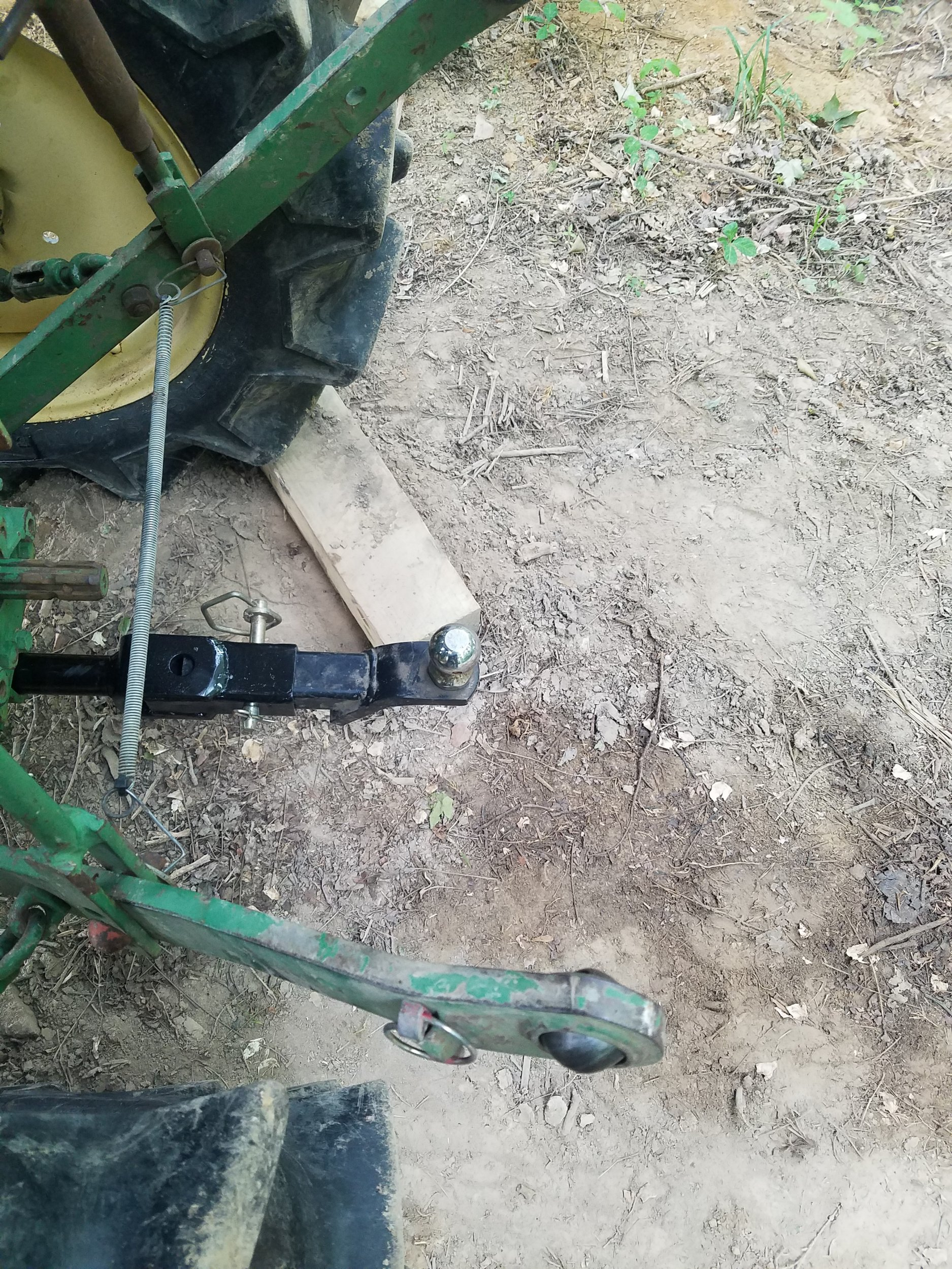

Needed to hook up to a utility trailer for serious tractor work.... hay ride for the kids.... not a fan of 3 pt drawbars and the stock one is about useless in stock form.... soooo I started cutting and welding... VERY pleased w my results....
Obviously the added length would reduce vertical capacity but I won't have more than a couple hundred lbs of tongue weight...View attachment 699033

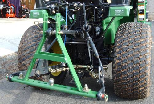

I just bought a three point hitch for $139 that I can raise and lower. No need for the drawbar.
   / Modified my drawbar to actually be useful #38
Pros/Cons to that too.
Pros
- You can easily backup and hookup
- You can raise and lower the trailer without jacking it up.
- Some of these also have the ball on top for 5th wheel moving. Slick deal.
Cons
- limited to the tongue loaded weight of the trailer to the rating of the 3PT hydraulic lift. Going over could blow out the hydraulic seals on the tractor. So don't lift beyond the safety rating.
