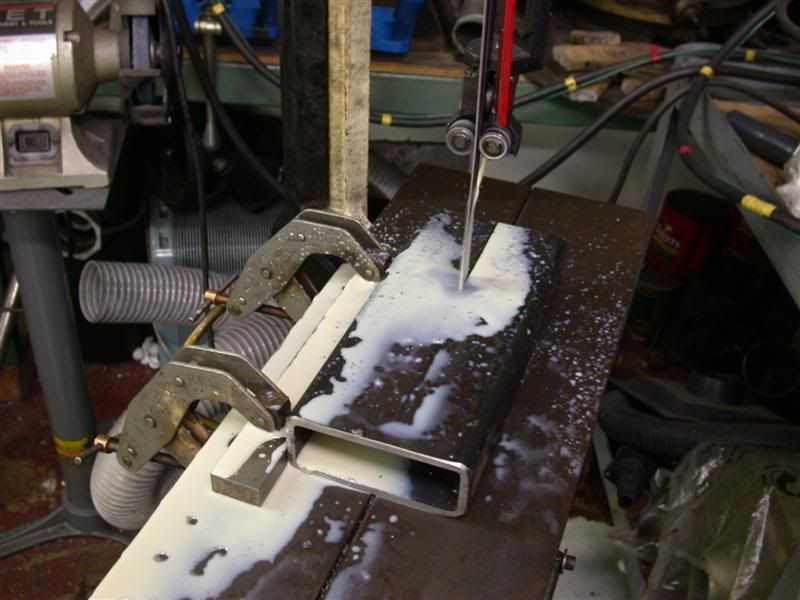

You know how I was slicing those large tubes in half using a saw blade on the milling machine? Well that sucks. I ended up seizing the blades and eventually breaking them, so I quit doing it that way.
I made a vertical sawing table for my shop saw. Figured I'd do it the way smart guys do it. My saw raises all the way up but did not come with the vertical table attachment. I clamped on a guide and sawed them up that way with coolant. That was way easier.:)
Those tubes when cut in half are going to be the base receivers which will be welded to the other taller implements such as the boxblade and rake. Actually, they will be welded to a 3/8" thick plate first, and the plate will be welded on. The dog leg extensions will slide into the half tubes and get pinned together.

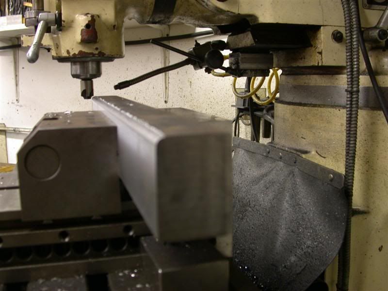

I also got the base for the rotary cutter done. It will get welded to a plate which will be welded to the body. Again, the Quick Attach Wheels will slide onto that and pinned. So here they are all chamfered and ready to weld up. I rounded the tops of the bars where the QA Wheels slide on so it would match the inside of the tubes.
Next is to weld up the dog leg extensions. I can do that here at home. But I have to bring the implement receivers to camp and hand fit them to the boxblade, to be sure it fits and position correctly. The spacing has to be the same on all the implements the QA Wheels go on. So I'll have to do all that final welding at camp. Maybe this weekend?

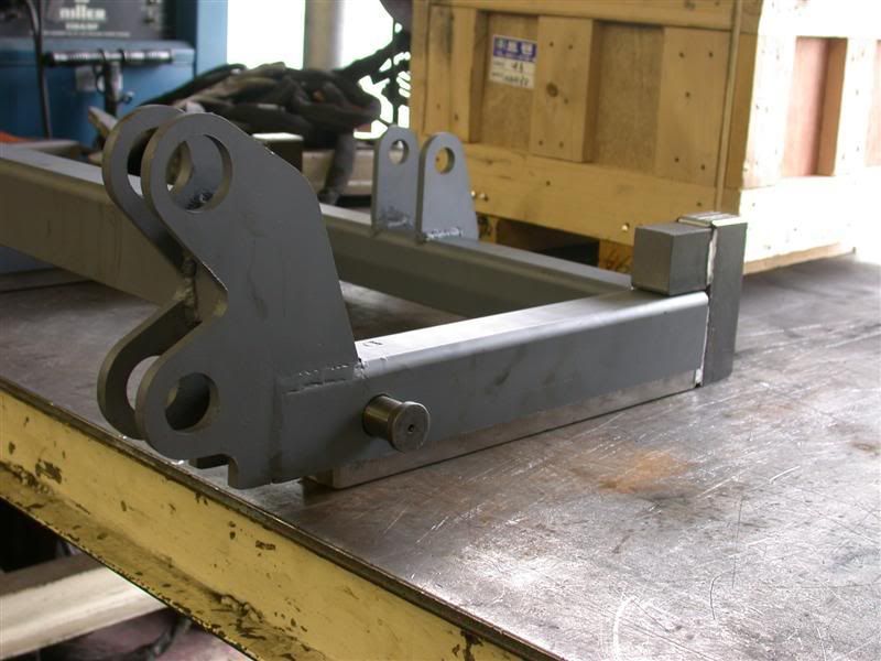

Got the welding at home done today. I used 7018AC rod with my stick welder. Seems my super old Forney doesn't like it as much as my new Lincoln arc welder does? Some welds came out great and others so so. The ones I didn't like I just cut off.
What you see there is the "hook" welded on the frame bar. The hook will capture the end of the QA wheel frame and along with a 1" diameter pin, will hold the assembly in place so it can't move.

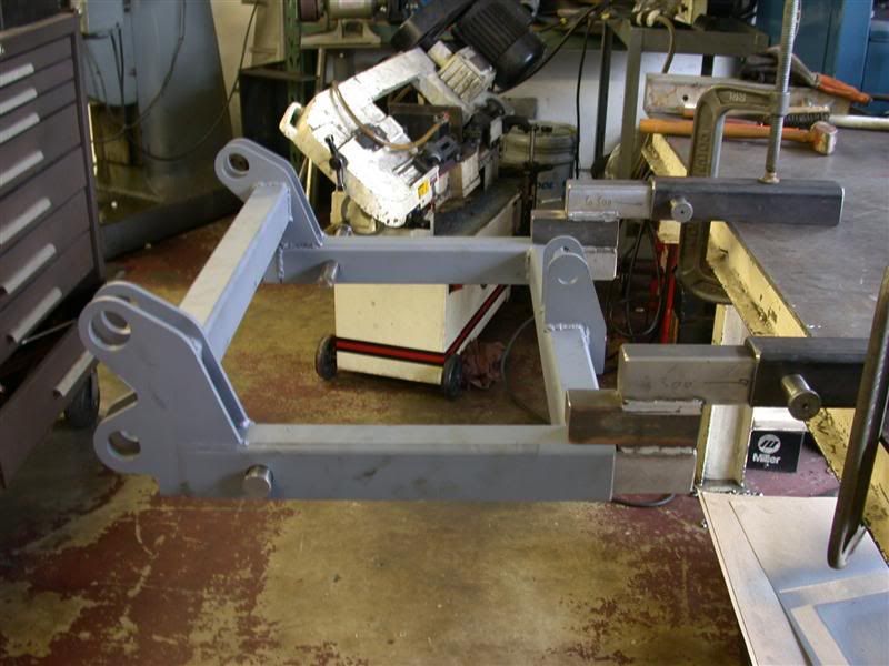

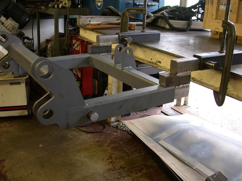

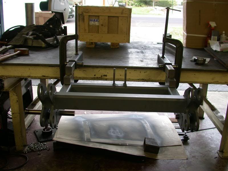

I took these pictures to give you an idea what the receivers look like and how they will work with the wheel frame. The first one shows the receivers for the rotary cutter. the next ones show how the wheel frame will slide onto the receiver. You can see here the rear of the wheel frame is captured and the big pins hold it all together.
Those receivers will be welded to the body of the rotary cutter. You pull out those 2 pins and slide the QA wheels off. I'll need to disconnect the QA hydraulic fittings first of course then they can be parked or put on another implement in a similar fashion.
