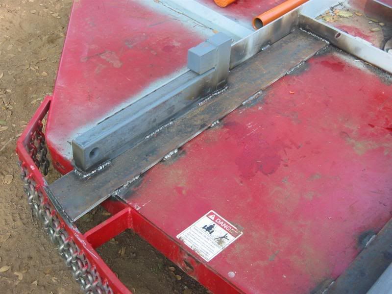

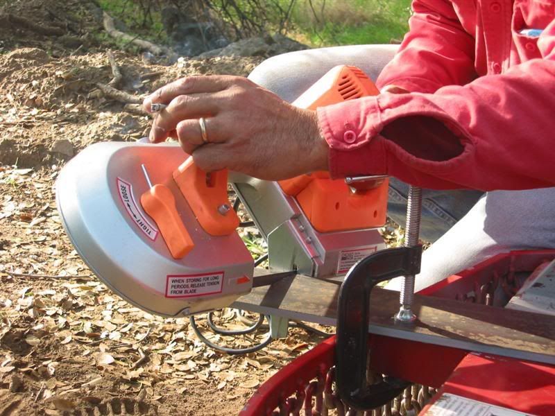

Last you saw was the addition of the extra tubing on the sides of the rotary cutter. In order to mount the receiver bars, I decided to weld them to 3/8" thick plates which will be welded to the rotary cutter body for even more strength. I had to do some fitting and welding first, and then space the receivers so the quick attach wheels would slide on and off them.
   / MODIFY BRUSH HOG SOME MORE
#182
After Loretta and I spent a couple hours getting the rails perfectly straight, we had a chance to touch up the welds with a little paint. It was touch and go getting the rails straight enough for the gauge wheels to slide on and off without binding up. I left .050" clearance and thought it would be plenty, but I was wrong. I could have easily used .051" or .052"... just kidding. Anyway, we managed and they slid on and off easily once we got the position correct. Here are a couple pics showing the result and with the wheels on.
