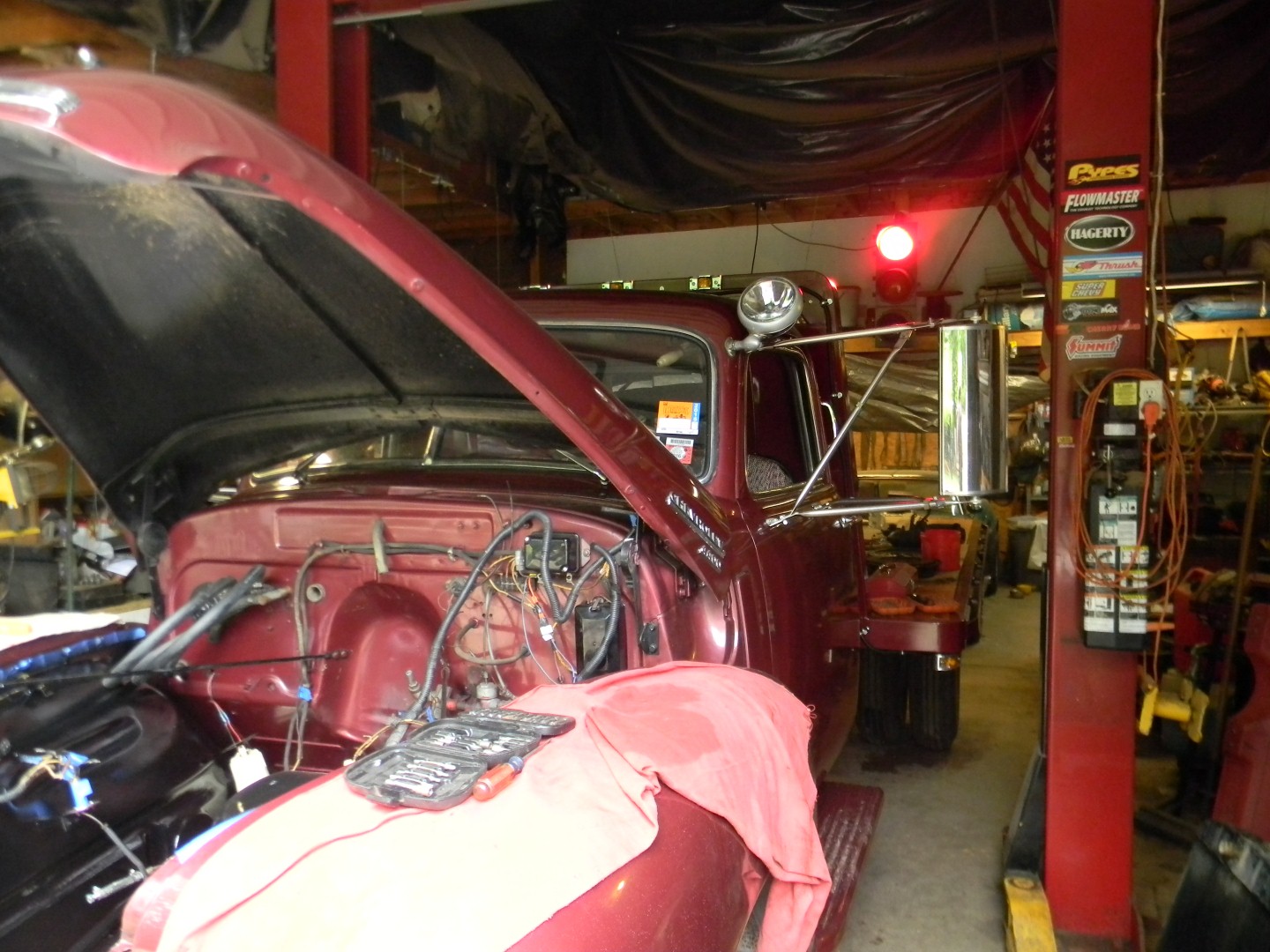

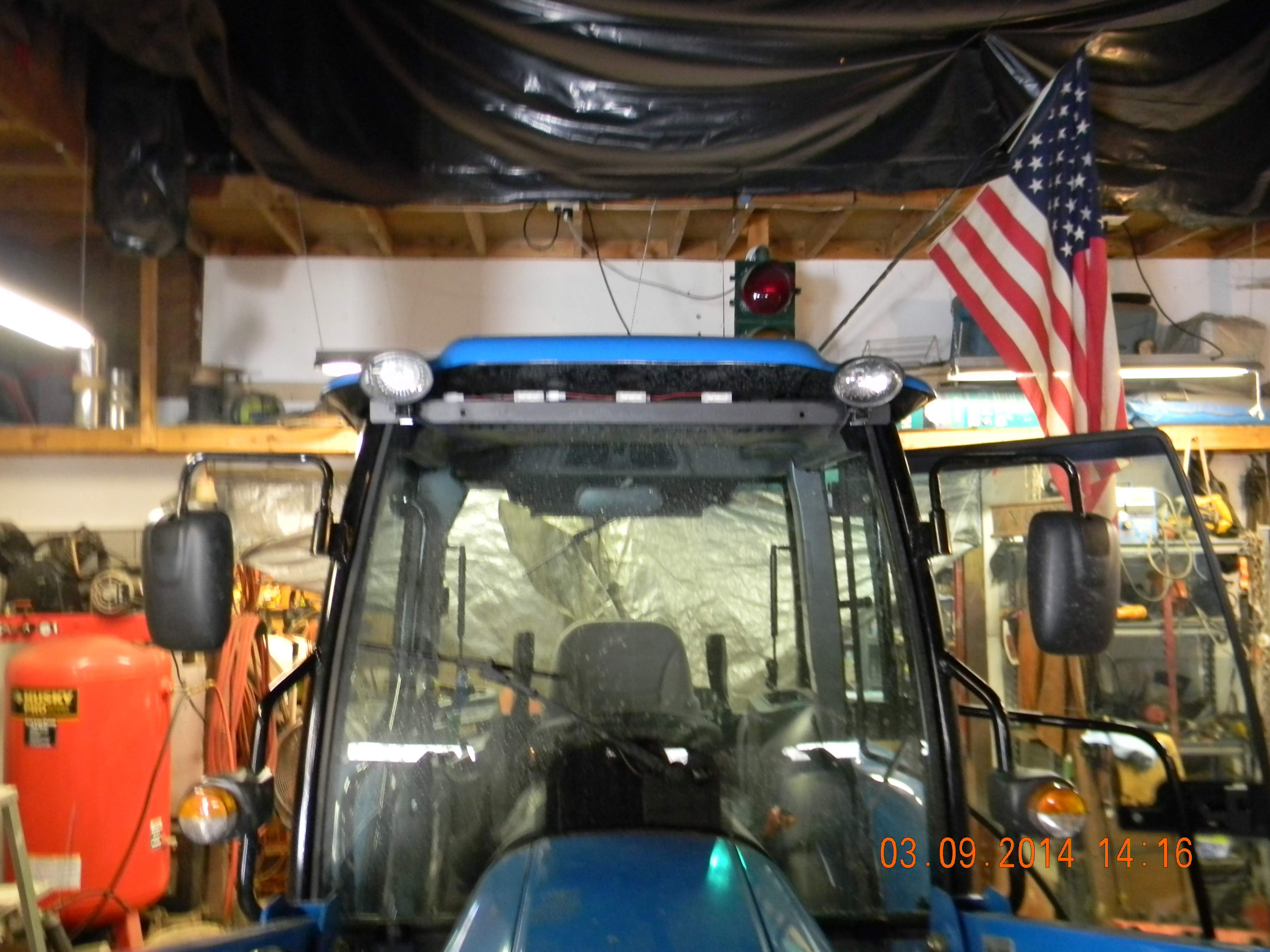

I have a 1960's traffic light (made by Crouse-Hinds in Syracuse) in my garage that I restored. Its one of 4 that I've done. I installed lower wattage bulbs and a controller sequencer to step through the lights. Mine's not LED which is a much newer light.

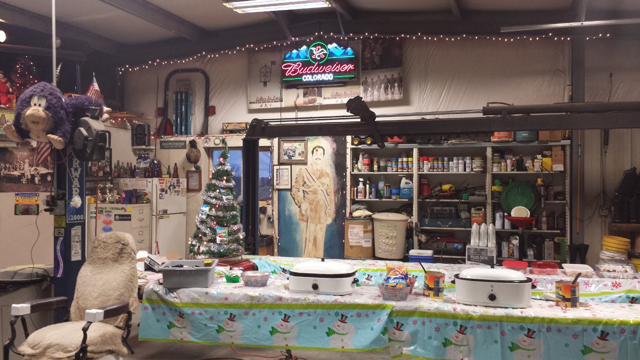

I'm so jealous. I want/need a traffic light in my shop/man cave.
But hey,,,,, I do have this. :)

If you really want one check the local flea markets at car shows. Usually someone is selling used traffic lights for $30-75. Pick one up, take it apart, sand blast and repaint, buy a cheap controller sequencer (<$50), reassemble, hang in the cave and plug it in. I had less than $100 in each and sold 3 for double that.

Richard , what is that mechanism above and behind the table ? Looks like a cylinder on top of it . By the way , hope the back gets better and Happy Holidays .
