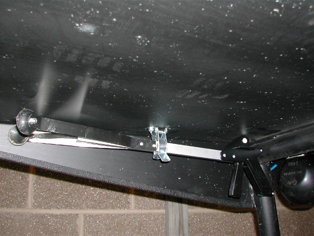

<font color="red"> also want to see if anyone found a good way to move the knee lever for easyer use of the mini hoe </font>
One solution to the knee-lever on the mini hoe is a diverter controlled by a button on the joystick. See the thread below. It works well, but others have found that with practice the knee lever isn't really too bad without modification. (Sorry about the long URL. I can't get the URL markup to stay on my screen long enough to create a click-on word.)

I’m ashamed to show this because it’s such a Rube Goldberg, but it works so well I have set my pride aside to share the idea. This is a lever extender that cost about 4$ in parts from the Home Depot and requires 2 holes to be drilled on the PT. A 3/8” hole is drilled through the knee lever handle to allow a piece of 3/8” all-thread to be attached with nuts and washers (you might devise a better arrangement, I needed something fast). The all-thread is bent to place the handle end just under the left side of the steering wheel. This position allows the left hand to control swing and bucket curl. For an alignment free support point for the left side of the extender I removed the S hooks from a rubber tie down strap and slid (forced) it on the extender and secured it to the PT with a ¼ -20 bolt. This contraption can be installed / removed in seconds. My intent was to use it with the Mini Hoe only, but now I just leave it on. I did reverse the Mini Hoe’s connections to allow curl in / curl out direction to coincide with lever in / lever out which feels more natural to me.

That handle mod is completely cool. I am using the Mini Hoe more, and would LOVE to do this mod. Can you give a few more detail close-up shots so that I can understand what you are doing a little bit better? I can't understand how you got it all to work - I need a list of parts, and a little more pictorial breakdown to understand what you did.

mckat: <font color="red"> I’m ashamed to show this because it’s such a Rube Goldberg </font>
Good to know some of us remember the esteemed Rube. That is one elegant solution. I gotta try it! Back when I still had a working minihoe I started in thinking along the lines of some ball joint linkage etc and just dropped it. Too complicated. I like your solution - a great bodge.

Attached is a more detailed picture as requested. The only parts are a piece of 3/8” All-Thread rod with 2 nuts and flat washers and a short rubber utility tie down strap secured with a ¼-20 X 1” bolt. This thing is childishly simple. What makes it work is the elastic properties of the rubber providing support yet allowing off center movement without binding. I consider this a crude prototype hastily assembled with materials I had on hand. I am moving from Downingtown, PA to Florida next week and will be without internet service for some time so please forgive my lack of response for the next few weeks. When I get back online I will be curious to learn of any experiences other PT folks have with this design idea.
