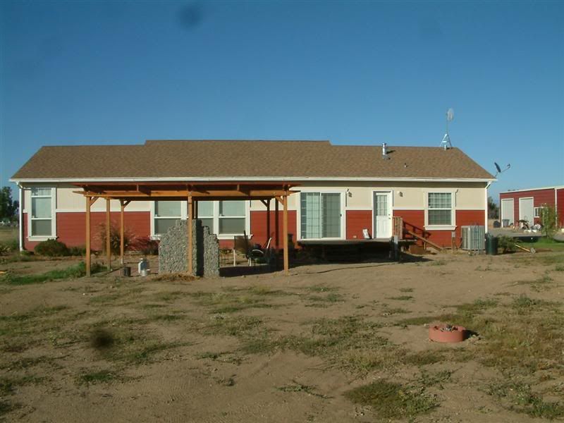

Experience: ordered a new 1800 sf 3BR/2BA manufactured house in May05. Closed escrow and took occupancy in Jan06.
It's like a stick-built house: 2x6 exterior studs, OSB sheathing, Tyvek housewrap, Hardipanel/Hardiplank siding. 5:12 roof pitch. GAF shingles. 2x4 exterior walls, 2x8 floor joists, 1/2" drywall, gas-filled duplex windows. The house is on a permanent concrete foundation over a 24" high crawl space.
Thoughts: you can find excellent stick built homes and excellent manufactured equivalents. Conversely, you can find crappy examples of each type. You get what you pay for.
