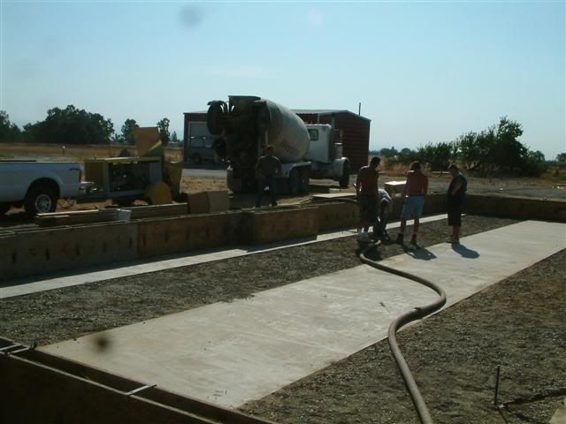

Much of the knock against manufactured homes arises because of skimping on the foundation. I've seen nice 2500 sf triple-wide modulars costing nearly $200K set on those inexpensive "toad pad" supports (i.e. 4" thick x 3-ft diameter concrete pads supporting a stack of concrete blocks). If there's any ground movement at all, these pads will shift and heave with respect to each other causing grief to the structure.
I paid an extra $20K to have 24" high x 6" thick concrete stub walls along with 6" thick concrete runners to support my 1800 sf manufactured home.
The runners and stub walls are reinforced and interconnected with #4 rebar. The interior supports for the modules are attached to the runners which keep them from moving with respect to each other. There's a 2x6 PT sill plate attached to the top of the stub wall so the periphery of the module can be attached to those walls.
I also had a Vector tie-down system installed to hold the modules to the support columns. That system is approved by the Florida for use in hurricane country.
The only noise I hear out from this house is the expansion and contraction of the HVAC ducts when the furnace is running.
My homeowner's insurance is no more expensive than for an equivalent stickbuilt house because of the materials of construction and the stout foundation.
I have all this construction photo-documented in a nice data package so when it comes time to sell potential buyers will see the construction details.
