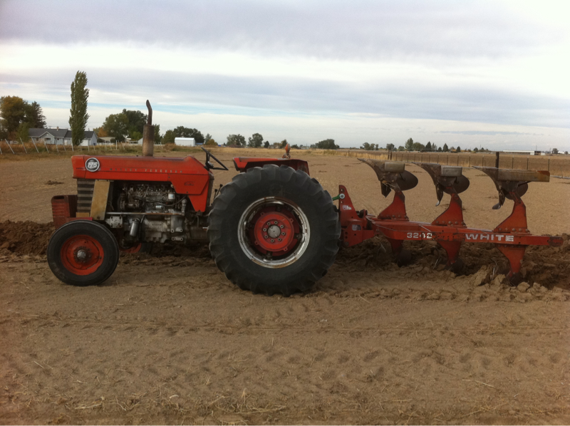

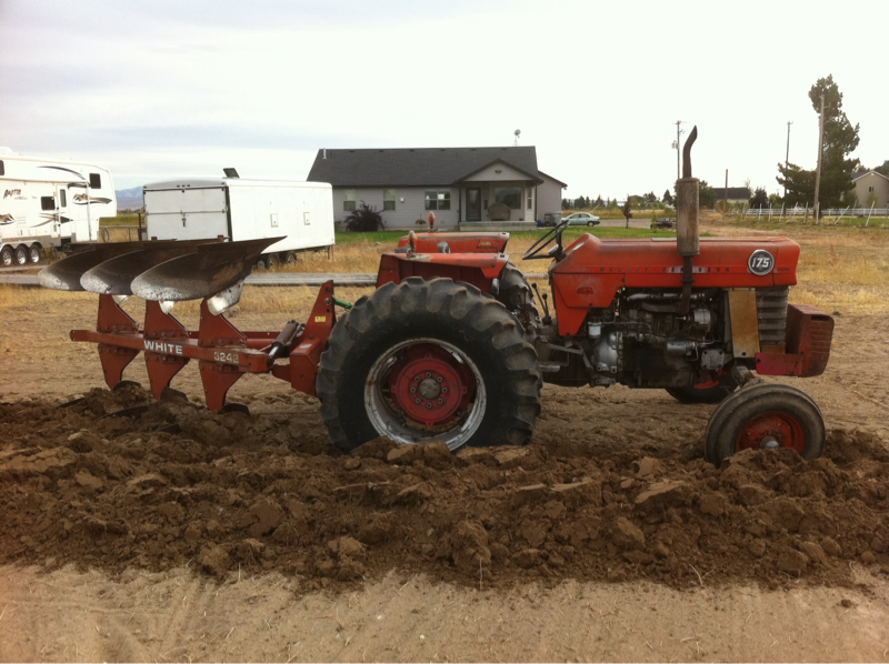

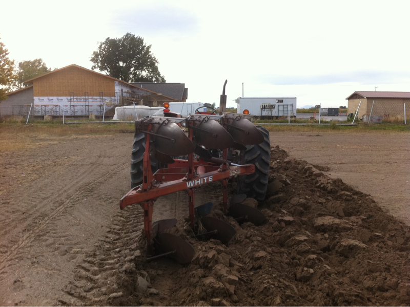

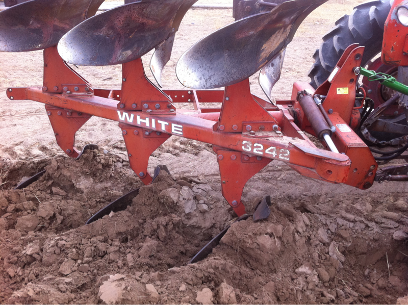

I have attached some pics I took mid row. I did find I was slightly high on the right side lift arm and adjusted accordingly. As near as I can tell the previous owner handy fairly well set up as far as the stops go. They are 26" long shares which extend past the moldboard some and 14" tall shins if that changes some of the dimensions that have been mentioned.
The furrows in the pics are some of the best looking I have been able to pull off.
I have the toplink set in the middle hole both ends if that makes a difference.
Seems on my draft control it will move itself but I am only moving the lever down about 1" on the quadrant to be in position as compared to 5-6"?? of full draft control lever throw. Maybe this is part of my earlier problems?
Thanks again for the feedback.
On edit: I am guessing this started life as a 16" plow but with those extended share lengths it now sits at 18".
Thanks.

To me it looks like the plow is pointing a little to the left of the direction the tractor is going.:)
Hard to tell from photo.
/ Moldboard plow help #9
I've never used a rollover plow but don't think the extra weight would affect you being able to pull it.
What concerns me is a lack of tail wheel??? Shouldn't it have a small, steel, in furrow depth wheel??
If so, that would explain your problems with draft control. Without a tail wheel the tractor is literally carrying the plow all the time which would cause problems. With a tail wheel all the draft control has to do is control the front end of the plow. Without a tail wheel the draft control has to completely control the depth of the plow. That might cause the tractor to struggle when the plow decides to dive deeper??
Your plow appears to be sitting level front to rear and side to side which is good.
The extended shears shouldn't have any impact since the tail end of the shear is running in the previous cut.

always replace the long slide with one like it .it takes the place of a tail wheel .i never thought they worked as good.there is no good way to put a guage wheel on it .you really need water in the rear tires .that plow looks like a 4-18 .a regular 3 bottom 16 plow with a guage wheel will pull easier.your ground looks hard.run a disk over it and wait for a rain .then break it a little wet.after you break it the first time it will be easier next year.you only need to break ground wet in the winter,fall or it will have clods.it needs the freezes to break the clods apart.try to set the plow to plow shallower it will be hard with all the weight of the plow sitting on the hitch .
#12
