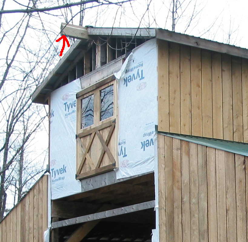

Dave,
Are you talking about a ridge beam that extends out over the doors for lifting heavy things into the loft with a block and tackle? Maybe something like this? /forums/images/graemlins/wink.gif Great Minds...

Hey Paul,
Really nice barn! I've been wanting to build one like it. Got a couple of questions for you.
Looks like you framed your second story on top of the deck just like you would a pier and beam house.... without running your posts all the way up to the top plate. Is that right?
Are you using 1x pine for your siding? It really looks good, like the barns they used to build.... rustic. Are you going to "bat" the cracks with more 1x? Do you have a sawmill closeby?
Thanks for the great pictures. You have a fine looking structure!

Willy,
The second story is a stick-built room, just like you figured out. I spanned 16 feet from the glulam headers with 2x12s, then glued and screwed 3/4 tounge/groove plywood flooring. It was pretty easy to sway that structure back and forth, and pretty scary, too. /forums/images/graemlins/crazy.gif Even after I had the 2x6 walls up, and tied together with 16 inch OC rafters, it still swayed in a strong wind. Once I got the roof sheetmetal screwed in it stiffened up quite a bit. Then I added the 1x hemlock rough-cut siding and now it is solid as a rock.
Yes, I do plan to bat the gaps between the 1x boards. As for mills, they are a dime a dozen around here. I bought my rough cut from an outfit about 30 miles away that pretty much supplies all of the pole barn materials for a 50 mile radius. If I had larger, mature trees on my property, I could have a portable mill come in and cut my wood for quite a savings, but I don't have the forested land for it.
Good luck with your project, and feel free to ask as many questions as you want.
