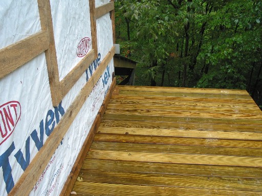

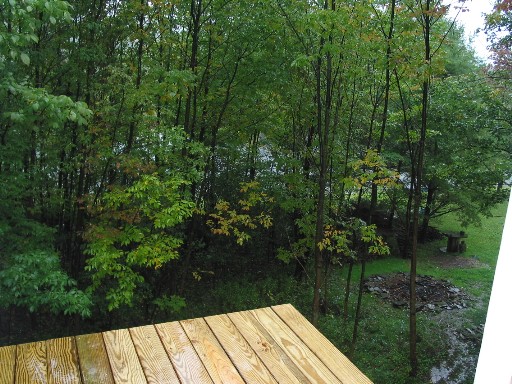

#21
This is a view from the second floor deck.

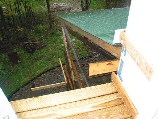

#22
This is a shot of the cantelevered 2 bys that support the second floor deck. You can see the deck in the right side of the picture from the underneath.

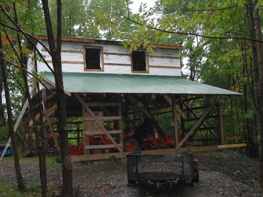

#23
This is an inside view of the second floor loft.

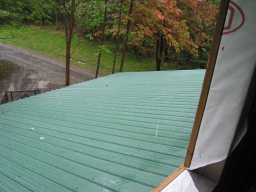

#24
This is a view of the first floor roof looking out the second floor window.

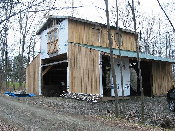

#27
OK, one final picture. This is the side view where the man door will be. If you look just behind the near tree, that is where it will be. The question for TBN'rs is, how close to the ground should I cut back that 2x10 PT skirting board when installing the prehung door? I am thinking about a 6 inch pour someday (but not for a few years, probably). Maybe I could get away with a 4 inch floor, but shouldn't it be thicker near the edges? I don't mind stepping over the board for now, I just dont want to have the door too high after I pour the floor. Can any pro builders out there help?
Thanks
/ Monitor Style Pole Barn in Progress #28
Paul; How much room do you have between the corner post and the first one along the side under your eaves? Also, how big of a service door do you want to put there? /forums/images/graemlins/grin.gif
#29
The opening for the service door is a little small - 32 inches framed. But that is because the door I already have from a previous house remodel is 30 wide. I will have to live with those dimensions. What I'm not sure of is how high off the ground the 30 inch door should be.

/ Monitor Style Pole Barn in Progress #32
Paul; First, figure out where the top of your future floor will be. Then take a circularsaw and make a horizontal cut on your skirt board. And then, use a reciprocating saw to make the vertical cuts. I dont think I'd remove any more than 3 3/4" though, that would leave you 5 1/2", the width of a 2X6 that would act as support for part of the bottom of the door frame. Then when you pour the floor, just place a piece of felt paper under the door frame to isolate the concrete from the wood on the frame. Never have untreated wood in contact with concrete, it tends to migrate moisture to the wood and rots it out. I don't know the codes in your area, they may require a ratwall around the perimeter of your floor. If thats the case, you'd be better off hiring some kids to dig that out now before you hang your siding. That way is much easier since you'll have elbow room on both sides instead of battling the inside of your siding when trying to dig, and also won't splatter concrete on the inside walls when pouring. /forums/images/graemlins/grin.gif

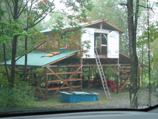

Really nice barn! I've been wanting to build one like it. Got a couple of questions for you.
Looks like you framed your second story on top of the deck just like you would a pier and beam house.... without running your posts all the way up to the top plate. Is that right?

Willy,
The second story is a stick-built room, just like you figured out. I spanned 16 feet from the glulam headers with 2x12s, then glued and screwed 3/4 tounge/groove plywood flooring. It was pretty easy to sway that structure back and forth, and pretty scary, too. /forums/images/graemlins/crazy.gif Even after I had the 2x6 walls up, and tied together with 16 inch OC rafters, it still swayed in a strong wind. Once I got the roof sheetmetal screwed in it stiffened up quite a bit. Then I added the 1x hemlock rough-cut siding and now it is solid as a rock.
