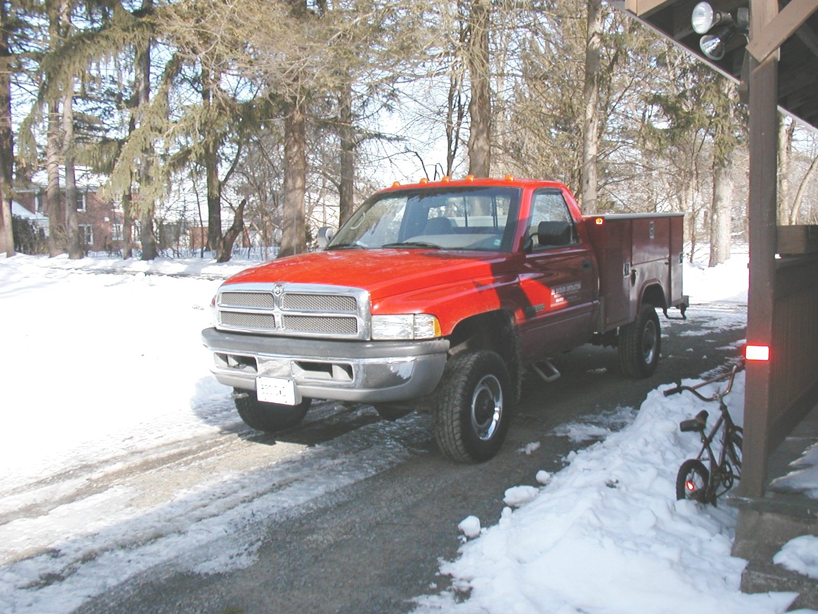

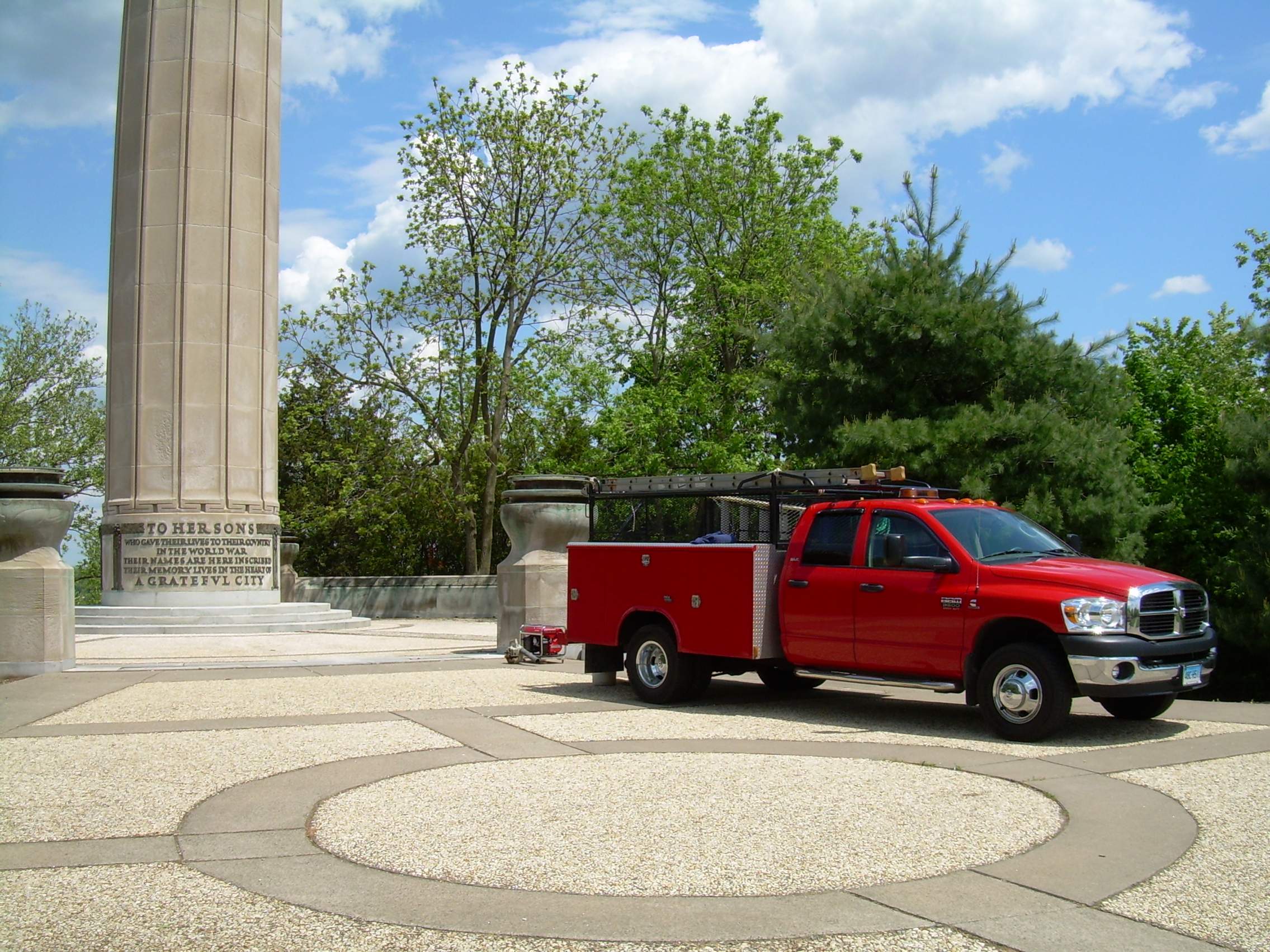

I had a 95 ram 2500 with 5.9, only had 160 HP with the automatic, that thing ran so sweet and pulled nice. I did have to rebuild the Bosch pump, cost $2,500 at a Cummins shop, I'm sure they are the highest price around. I was real bummed at the time over the cost, but after I realized that was the only mechanical problem I had with that truck in 12 years.
I stuck with Cummins, even being a Guinea pig for the first year (07) 6.7L. this thing is super sweet, just miss the 5.9's sound :)
I just believe diesel power was meant to be housed in an in-line 6 :)
JB
