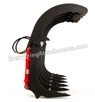

Have you seen this one?
Everything Attachments Tractor Loader Root Rake Grapple
  • Approximate weight: 420 pounds (60") and 460 pounds (72")
From: Everything Attachments Tractor Loader Root Rake Grapple
