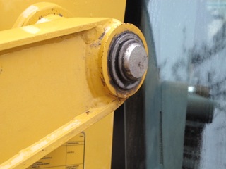

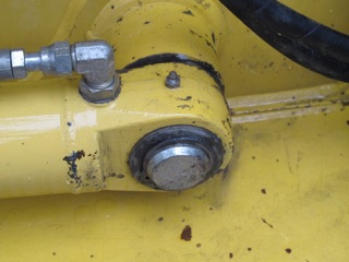

How small is small? What diameter are those 7520 pins? What kind of loading do they rate for at the forward pins? I got curious so went out and looked at some of our other similar lift tractors. Back in message #56, 5030 pointed out that these tractors we are talking about are all roughly the same size - all big tractors with pin loading at the bucket in the 4000 lb range....give or take a thousand pounds. That fits the M59 pretty much exactly (4000# pin load spec for fairly large 1.375" diam. pins).
Below are pictures of a couple more tractors to ponder:

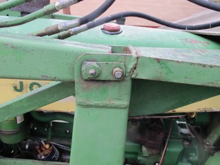

The very old JD530 has had these same drilled pins without wear or breakage since 1958! and we've certainly beat it extremely hard in every way. The 530 pins are roughly the same design as we've been discussing but with some slop & even less metal out on the "ears". Pins are 1" center-drilled pins made more or less like the ones that failed on Hersheyfarm's Kubota - and rated even higher for bucket and pin loading. I didn't pull one, but they have to be cross drilled and probably center-grooved as well. They ride in a piece of what looks like 1 3/8" tubing welded inside of the hollow lift arms. So that gives us more or less the same design but with even more flexure and using a smaller pin...and without problems. BTW, the JD530 is only 30 hp, but is quite a heavy tractor. Fitted out as ours is with an implement, it would go 7500/8000 lbs. Not as heavy as the M59, but close.

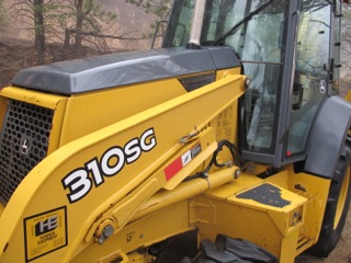

Next is the JD310SG - known world-wide as one tough construction machine. 90/100 HP and 16,000+ lbs. I have no idea what they are rated for...but it has to be lots. Just guessing, it could be double what an Ag loader is spec'd at. Not heard of a 310 breaking pins, and look at that pivot....it's completely different. There's a full 2" diameter pin but it's cantilevered with no outboard support at all. Not drilled in any way either, and the zerk is on the outer part - not in the pin.
I wonder what steel JD uses? Is that the answer?

,,,,,,,,,The size of the pins is 1.125, stated awhile back. - - The forces pins in the curl circuit see is many times the lift capacity of the loader. ... Take tractor weight, loader, counterweight and ballast, and lift capacity [over 5K for the 7520 at low height] and add together. This gives the conservative push force figure with AGs. - - For the 7520 this amounts to about 17,000#. -- Then theres some multiplication of this figure in the curl circuit when 1 pin location pries against the other during the 17K push. I would guess my pins see over 20K on occasion where load is offset a lot to one side or the other.
I am surprised that 1.375 pins on the M59 would fail. Kubot has done an extraordinarily bad job on that setup.
,,,,, The steel, and the finesse used in finishing/optimizing the stress profile can make a huge difference.

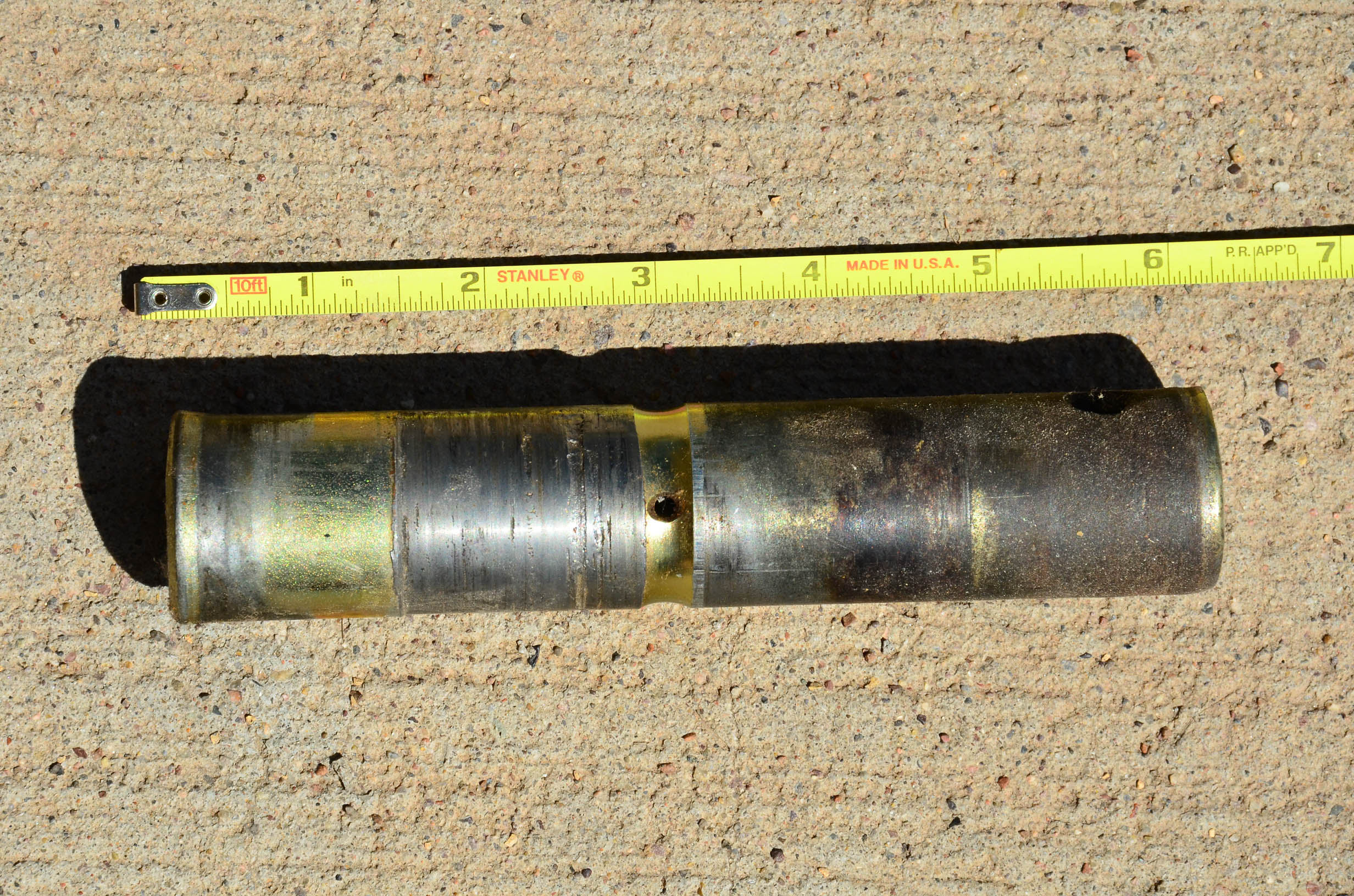

Yikes - Just saw this thread. Thanks for the heads up, I may replace some loader pins at probably the 1000 hour mark, just to be safe.
For reference here is a pic of a warn pin from the front quick attach assembly. When I bought the tractor at 250 hours, the previous owner had torqued and warped the quick attach and I had to pull 4 pins and replace it. The pin shown was badly warn due to things being out of alignment. In any case, this illustrates the construction of the pin. It is drilled for grease from one side, and there is a single cross drill as shown. I don't recall any longer, but I don't remember any damage to the pin sleeve, so it may be that the pins are intentionally of a softer steel than the sleeve.
