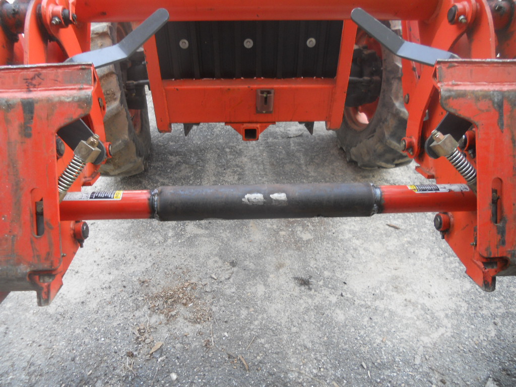

When I bought the tractor at 250 hours, the previous owner had torqued and warped the quick attach and I had to pull 4 pins and replace it.
This is a easy fix (if the L/R sides are just out of "time" with each other) that I just had to do myself. Just cut the torque tube on the ssqa, got them back in "time", welded, ground then put a good fitting pipe ofer the weld and welded that. DSCN7881.JPG
