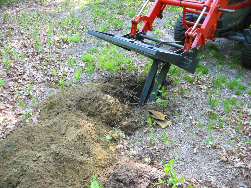

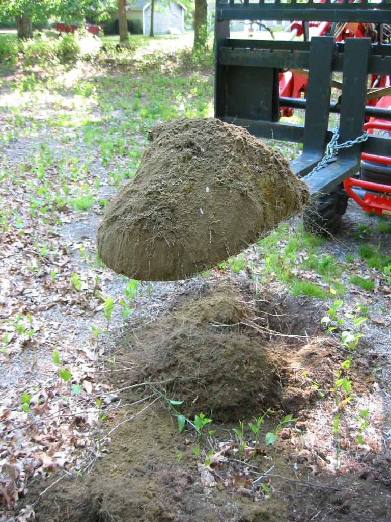

Regarding other implements to consider, forks would be next on my list depending on what type of work you are planning. They are very handy. I use mine not only for lifting stuff but also to dig like a massive shovel by attaching a QuickSpade. Not as efficient as a backhoe but very useful especially as they are much easier to mount/dismount for a smallish task. Works about ten times faster than a man with a pick and shovel.
