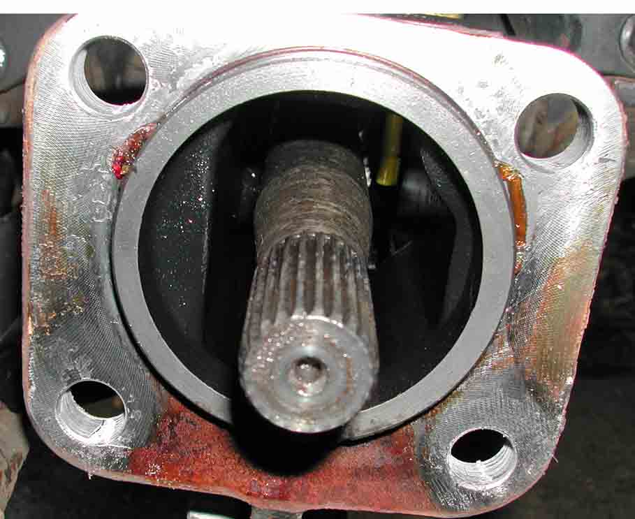

I use GL-5 gear oil. We went thru this before when I posted about
rebuilding my early 4300 axle.
I know this is offensive to JD true believers who want to use the hyd oil
specced in the manuals (J20C or J20D). I made this change for several
reasons: I was concerned about the corrosion I saw in my axle, after
9 y of THF being in there. There have been lots of changes to this axle
in just the 4 or 5 years of production. All seem to be made by Spicer (the
inventor of the U-joint), though the earliest ones are unmarked. They are
not made by Deere. OTOH, Kubota and DaeDong do seem to make their
own MFWD axles, and both spec gear oil, and both companies have very
reliable axles. I have not met any JD engineer or other employee who knows
anything about the lube choices they made. (I do ask them at the giant
exhibits at the tractor shows.) I am more comfortable using gear oil for
this low speed conventional gear final drive, but everyone should make
their own choice.
As for the access to inside that axle, that only requires removal of the
4 bolts (photo), and possibly the tie rod end. The shaft slides right out.
You can see the dipstick in there.

I use GL-5 gear oil. We went thru this before when I posted about rebuilding my early 4300 axle.
I remember going through it, I just couldn't find where and the conclusion! :)
going to "2 oil" machines
See, thats the answer as to why they spec HyGard. Its likely significantly cheaper to have one oil dispenser during assembly than two. Some accountant came up with it and an engineer was told to recalculate the amount need in the axle to achieve equivalent results.
Maybe the true fix here is filling the front end with 80w90 and getting a longer dipstick
I'm changing my previous stance I took with dfkrug and saying that I think you're right. I just may try it...
Thats a great picture, btw!
