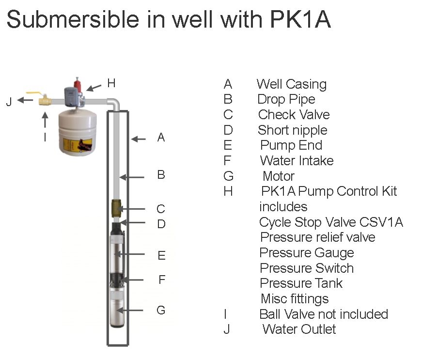

I am always surprised by the misconceptions people have about how pumps work. All the water volume and pressure comes from the pump. A pressure tank is 75% air so an 80 gallon tank only holds 20 gallons of water, a 20 gallon tank holds 5 gallons of water. A tank does not add pressure or volume to the water. I have many systems without a pressure tank at all. The pressure tanks only purpose is to limit the on/off cycles of the pump. The tank can supply a few gallons before the pump comes on. But once the pump is on, water comes directly from the pump. Excess water is stored in the tank to used during times the pump is off.
Water also does not come from a water tower. That water was put up there by a pump under pressure. And again, water in the tank is just to use for small uses before the pump must come on. It takes 2.31' elevation to make 1 PSI. That is why most city water towers are 115' tall, as that is how high it must be to store and then supply 50 PSI to the system at ground level.

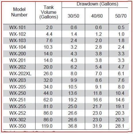

In the FYI bin, an 80 gallon tank, going from 60psi to empty at 40psi will discharge about 53 gallons of water. Going from 40psi to 20psi gets you about 40 gallons, but the energy cost will be about 40% of the 60/40 pressure swing, on a cost per gallon basis.

I think what they call the maximum acceptance volume for an 80 gallon tank is about 53 gallons. But that is a stupid number to publish as it doesn't mean anything. Looking at this chart you can see the actual draw down of a WX320, 86 gallon size tank is only 23 gallons at 40/60 pressure. That is under perfect condition and laboratory testing. In real life you would do good to get 20 gallons out of a 80 gallon tank before the pump must come on.
People see these big tanks and think they have lots of water. But that is a false sense of security as water comes from the pump, not the tank. Having 20 gallons or even more in a tank is not of much use for a house that uses a minimum of 200-300 gallons a day. Again, pressure tanks don't hold much water and their only purpose is to limit the on/off cycling of the pump. In the old days using as large a pressure tank as you could get was the best way to limit the cycling. But these days when using a Cycle Stop Valve to limit the cycling, you don't need a very large tank.
