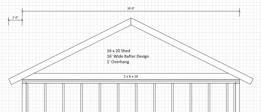

Here is some additional detail on my Rafter Design. I mentioned a 16' rafter... I intended that to be the full width of the building.
Using the full length 16' ceiling joist with a 6/12 pitch will allow me to use 10' rafter boards. All good with little wasted cut-offs.
I would increase the strength of your rafter by making it into a truss. A simple M design will give you tremendous strength and its super easy to do yourself.
