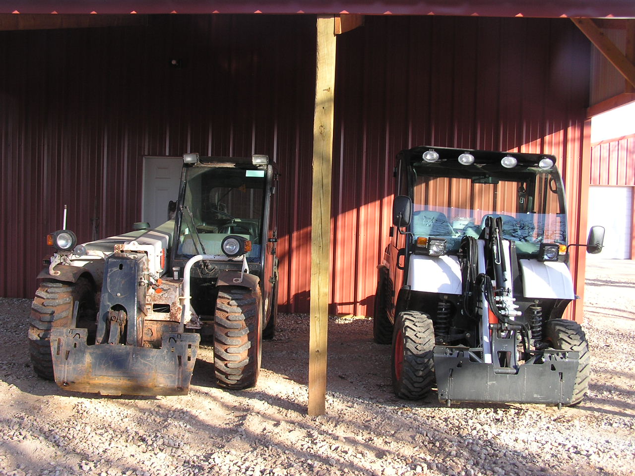

I think the 45 inch width is to cover manufacturing tolerances. The Bobcat SSQA is 44 inches wide, so the forks probably would fit most skid steers. I have some attachments that are very narrow tight and some that are sloppy wide.
The Bobcat SSQA plate is one piece so not likely to vary like tractor loader plates, even though the OP's plate is in spec.
424787-more-ssqa-problems-dealer-avoid-p3070021-jpg
