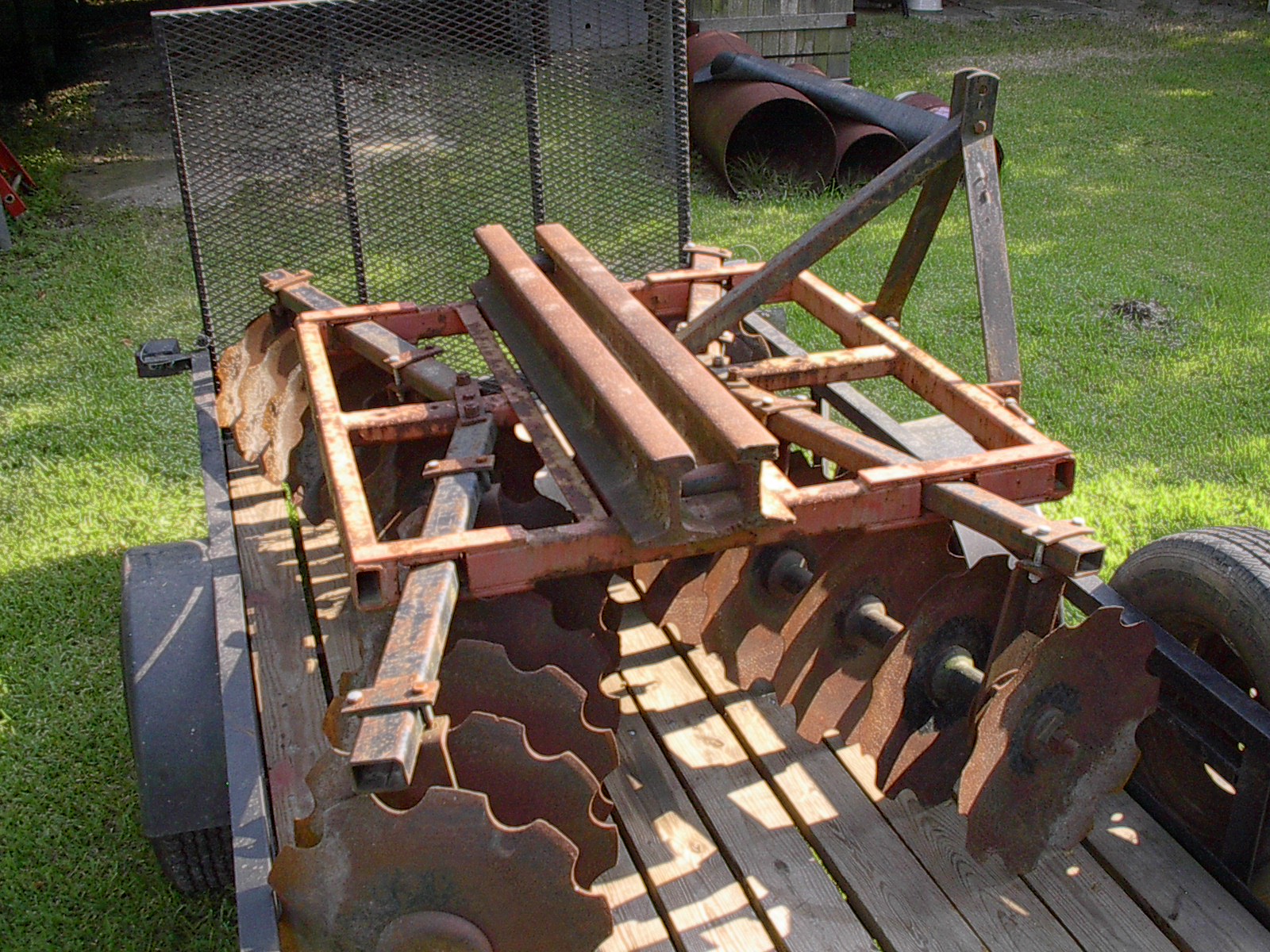

   / More weight for my disc harrow #13

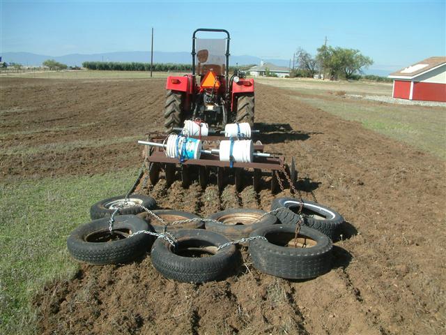

I strap four 5 gallon plastic buckets filled with concrete to my offset disk. About 110 lb per bucket.
Good luck

The 5 gallon buckets full of concrete look like a great idea. I made a wood box that straddled the frame of my disk and I add rail tie plates as needed. I could see a similar wood frame working well to hold the concrete buckets.
   / More weight for my disc harrow #20
oosik, I've a disk very similar to yours. I looked at the pictures numerous times and I just can't visualize how you get that blob to sit on the disk?
It seems that the center angle iron that attaches rear of disk to the top link would interfere? If I could figure out how you set that blob on the disk, I'd copy your idea in a heartbeat!
The next time you have the blob planted on the disk, would you "please" take a picture? Thanks much if you can do so. Greg
