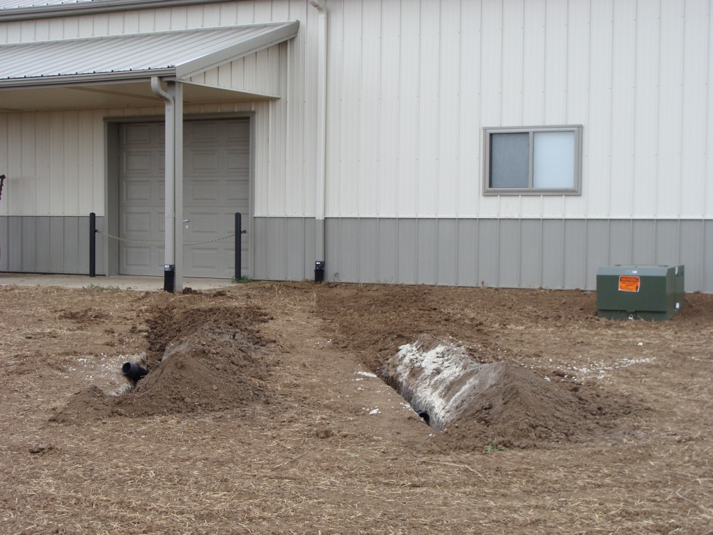

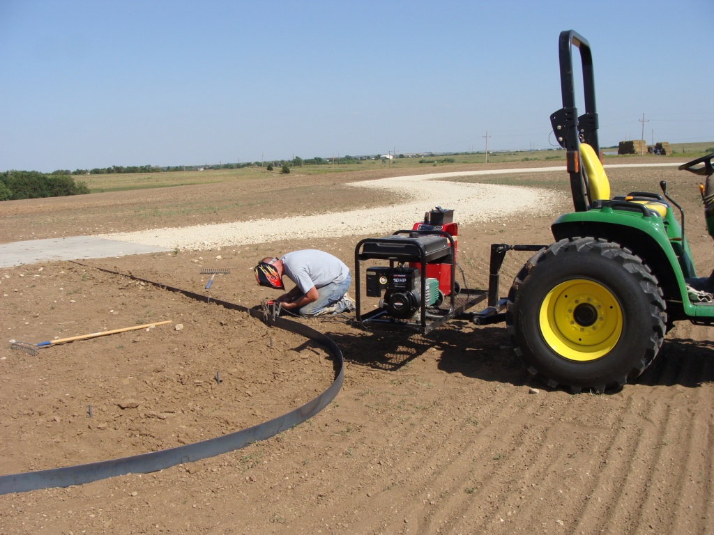

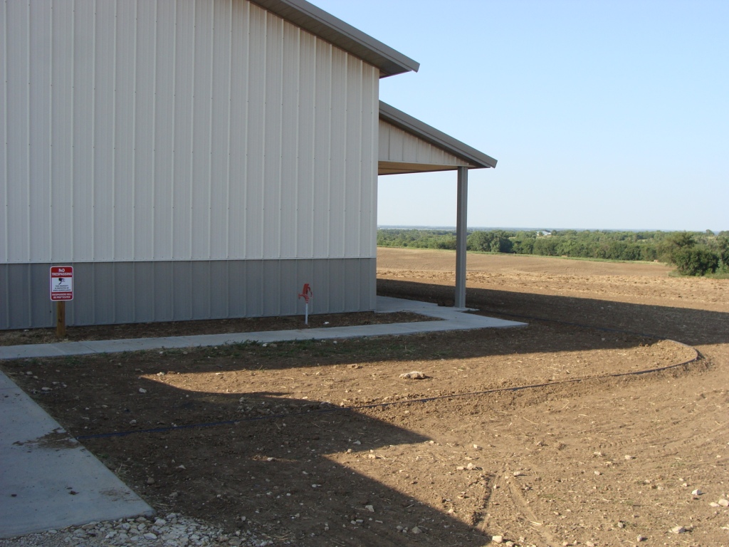

Progress update:
Last week I buried the 5 downspouts that come off of the building and yesterday I installed 200 feet of landscape edging. The landscape edging consist of 1/8"x4"x20' steel pieces with 12" pieces of rebar welded about every 4-5' to help anchor them in the ground. I guess this was better than the stuff you buy at Lowes, etc. Anyway, the next step will be to put down landscape fabric and river rock to give it a finished look.
