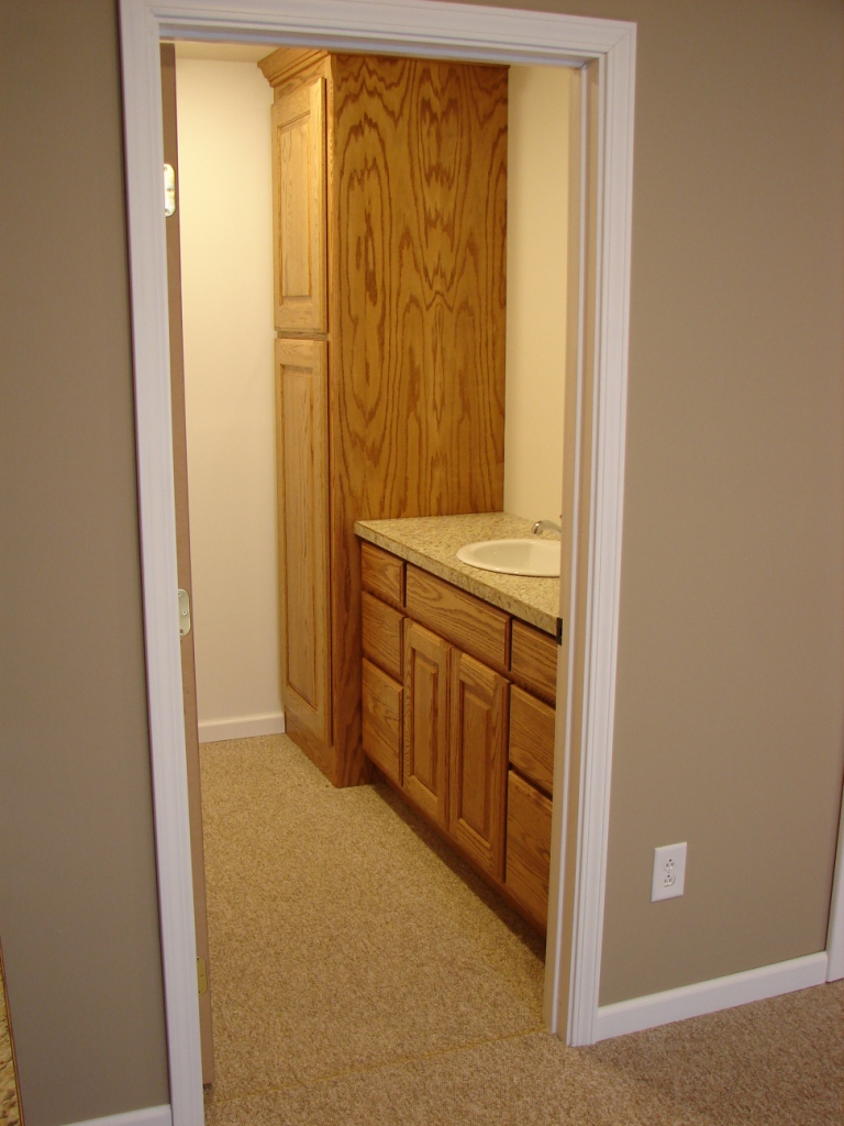

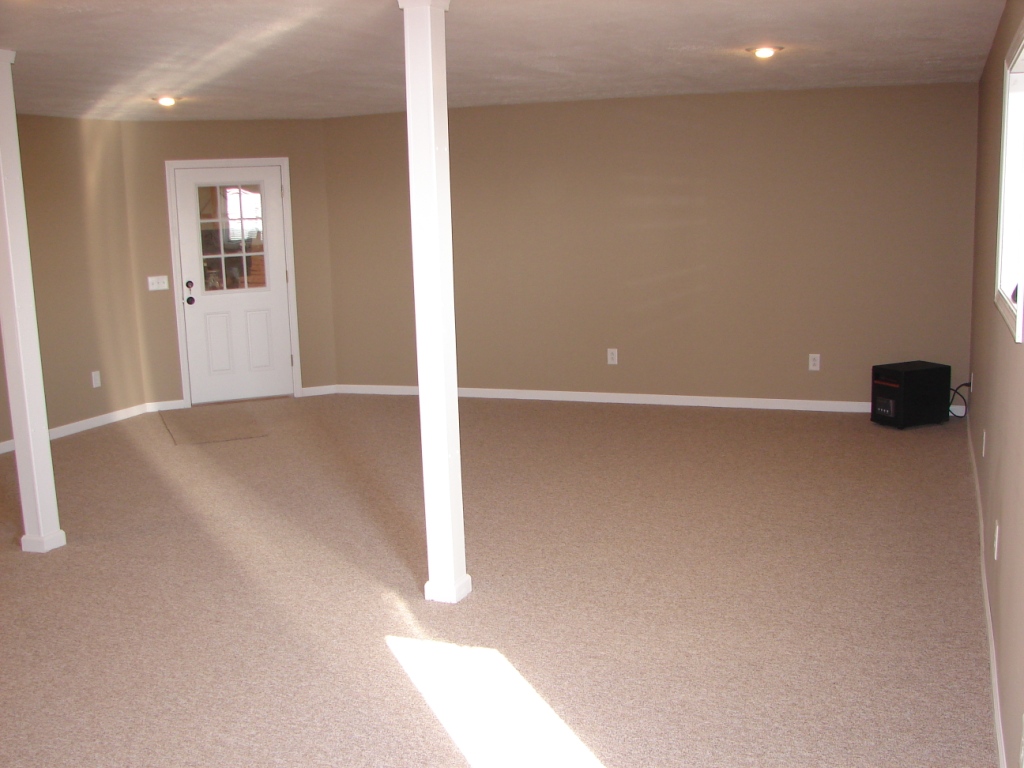

Here are a few of the latest...........

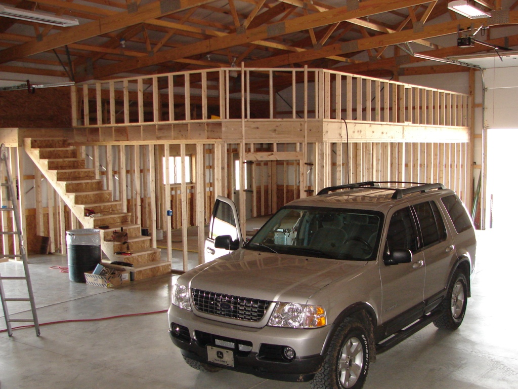

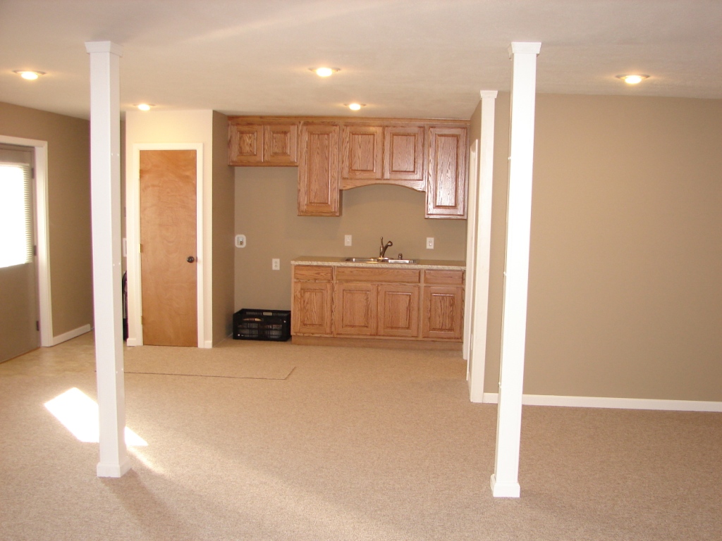

couple more......

So are you living in there? I've heard of people around here, building large barns and taking about a 1/3 or even 1/2 and using it for living quarters.
Wedge
   / Morton Building
#26
Not yet......we plan on using it as temporary living quarters while we build a home in the future. It is more like a finished "break room" inside the building.
   / Morton Building #27
Just want to say that this is a very nice. I think all pole barns should have a living space in them. I see alot more people building garages and pole barns with living spaces before the actual construction of there house. Probably a lot cheaper then living out of a hotel if you sell your current house. And probably alot easier than living with family or friends while the house is being built.
Can't wait to see finished pictures.

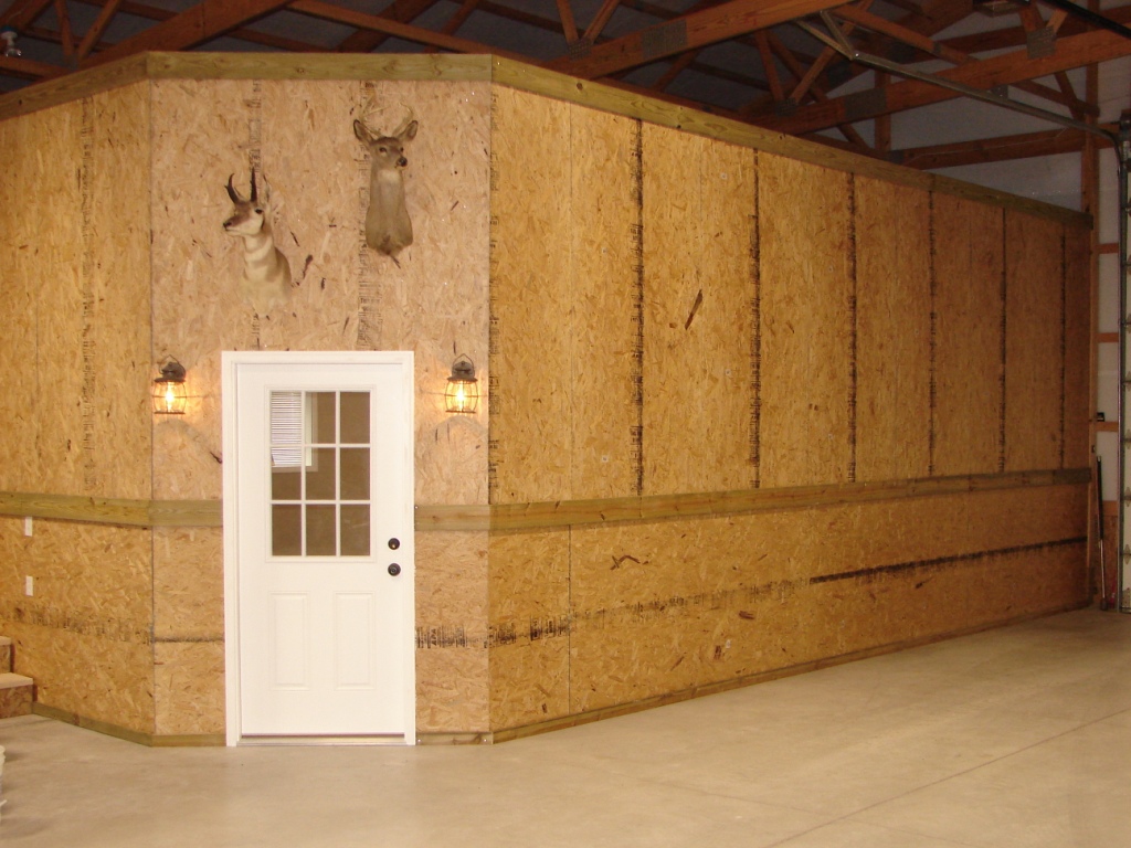

"It looks like Morton set short glue lams posts to get out of the ground and then nailed the rest of the columns to those? Were the upper columns in pieces or were they already together and just mated up?"
Yes, columns are assembled and precut at factory, factory installed " bird blocking 2x4s spaces the girts or siding nailers onsite. The columns are nailed to the treated columns in the ground with one nail, wall is assembled on the ground and then rotated up with tractor loader.
"I see what looks like OSB around the bottom. How thick is that and was that optional or stock? Is it for protection from animals kicking or you getting too close and is it structural as well?"
7/16 OSB, mainly to prevent dents in steel wainscotting, my wainscoting was screwed in and the rest nailed, Beavis probably had all his steel screwed on.
