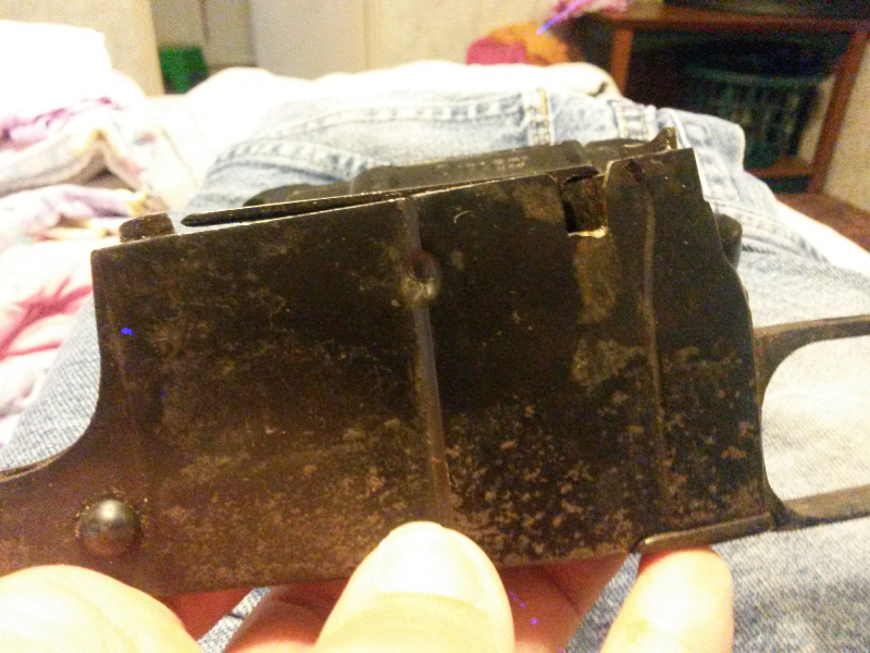

So, dumb question, is the interrupter the only thing that holds the ammo in the magazine from springing out? There is an area on the back right top of the magazine that looks like it has been knotched out. I've read about "Finn anti jam" mag modification but never seen what it actually was they did.
   / Mosin-Nagant hex receiver #120
intrrupter seperates and kinda lifts the top round so it can be chambered, primary reason for the lift is to prevent rim lock.
