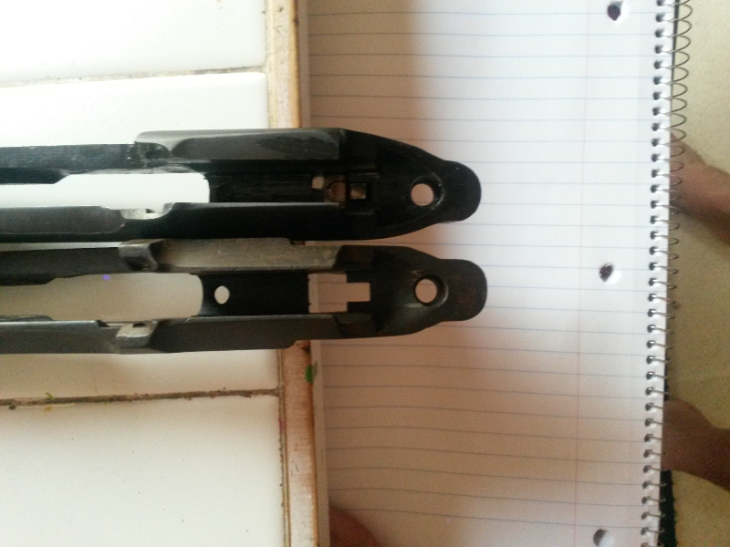

Are hex receiver stocks and round receiver stocks suppose to be interchangeable? I got the friends stock last night, and this morning I tried to put it together. Seems like the hex has some more material removed at the rear. Or I'm doing something wrong. I could of coarse carve some of the wood away to make it fit;
But, could I remove a little of the metal, that way I could use the hex stock on the hex receiver in the future?

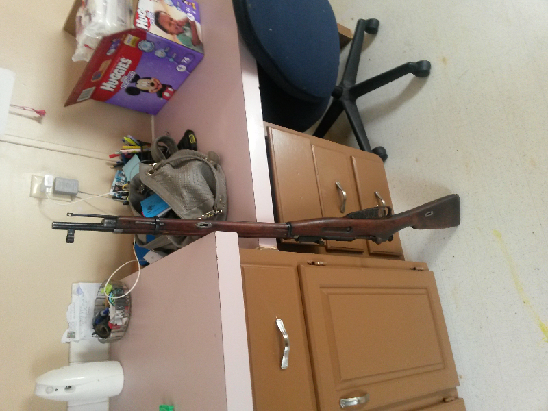

Got it put together. Wrapped some 240 grit sand paper around a screw driver handle and sanded to fit the round receiver.
Hopefully I get a chance to do some shooting with afternoon.

I considered it, but in the end, when you really look at how the bolt locks up when closed, I felt OK firing it. It's not extracting, and the magazine would not hold the ammo in, (bad description...) so I loaded single round and then had to hand remove the fired round from the bolt face. Sorry for the ignorant description, but I think I have a few more YouTube videos to watch to better understand the mechanics, and the parts.
So, fired 8 rounds I think, shoot a touch right and maybe bit high at 30 yards.

The spend round remains on the bolt as you pull it back, clipped on the bolt face by the extractor. So, yes, but the spend round is at least pulled back out of the chamber.

Ok, I'm missing the "interrupter" and the extractor is broken off. I'll have to order more parts on ebay. Sorry for the rather ignorant way I tried to explain it all.
I was pleasantly surprised by the recoil, really wasn't bad for a steal butt plate.
