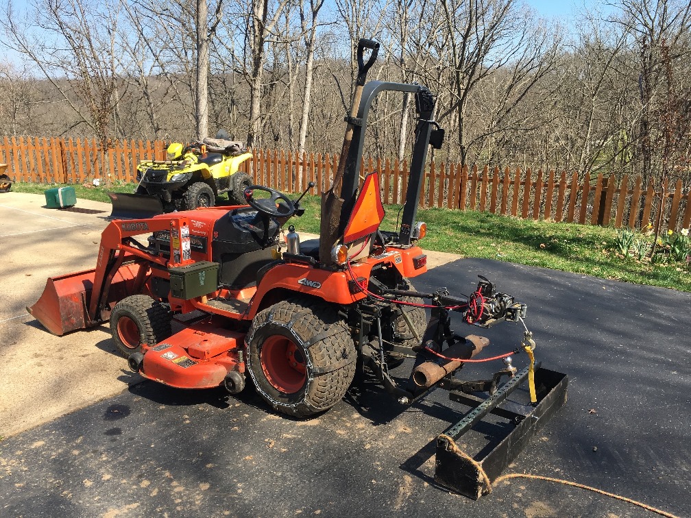

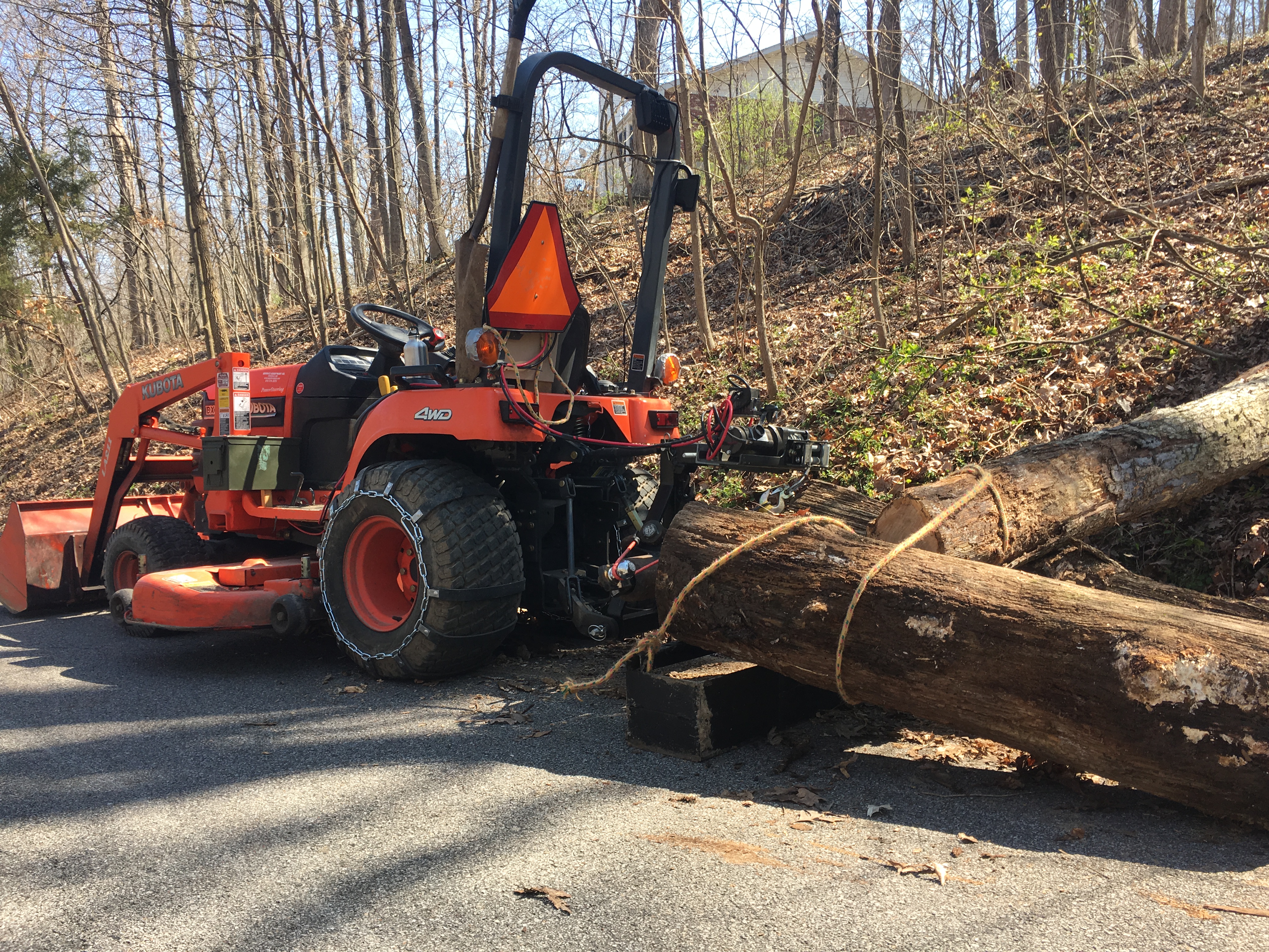

I have limited room to store my tractor, and less room to operate in my woods, so I try to keep things compact. There is little room for tool boxes on a BX, but I fit a 30-06 ammo box right in front of the diff lock and one behind the seat. I also added shovel and axe holders to the ROPS. I never have the right implement with me, so I took a heavy hitch and added another 2" receiver to the top for a removable winch mount, along with 3 weld-on chain hooks. Then I made a mini box blade that doubles as a log holder for skidding which plugs into the 2" receiver, and it will get some tabs for hanging extra counter weights soon.
The ideas found on this site show such intellect! BX2200 Drive B.jpgWood 1A.jpg

That is really impressive work out of a SCUT with MMM and turf tires! :drink:
What's the muffler-looking cylinder under the winch?

It sure does get used hard here. With a curious toddler and one on the way, time by myself to get chores done is limited! That cylinder is an old piece of XX strong steel pressure pipe. Its about 1.5" thick, and 36" long. I salvaged it from a gun range gong after realizing that I badly needed a rear counter weight.

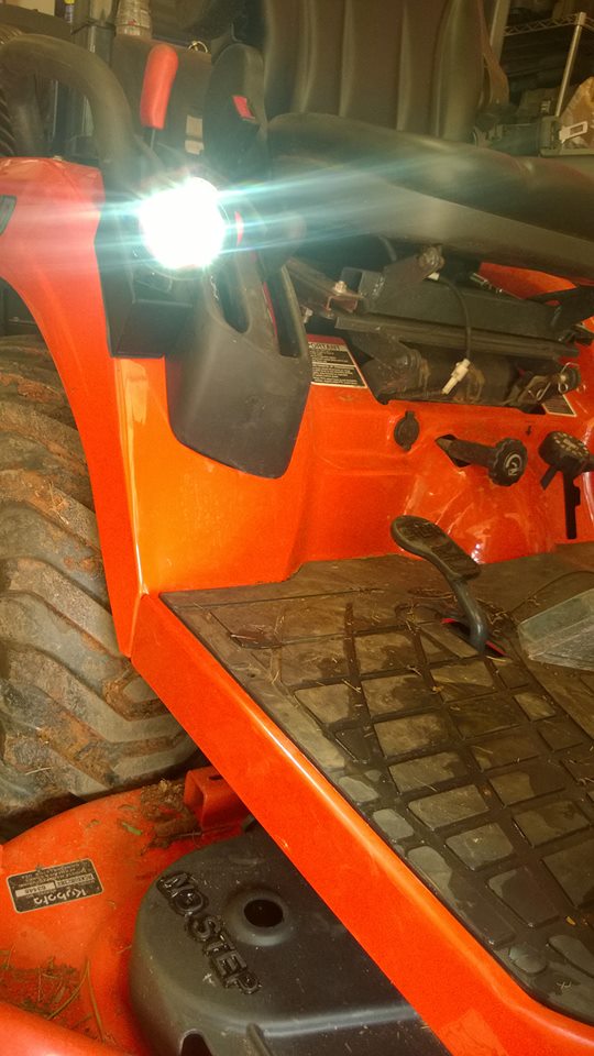

I cut the grass at night due to my schedule and the heat so I put these fender lights on to be able to see what in front of the MMM and give me some side light.mounted light.jpg
