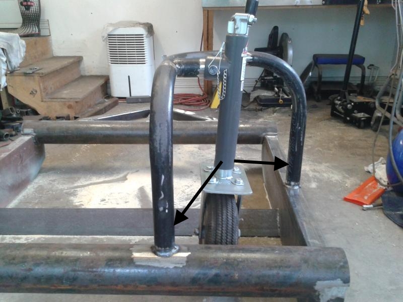

Just weld a brace towards the bottom of the vertical tubes of the mount you have, that ties into the bottom of the jack (will look like a diagonal brace for the rear corners) That is the quickest way I can see to fix it.
   / Mostly scrap built (but still awesome) land plane #102

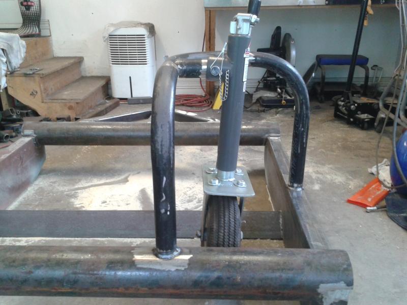

Married the jacks to the casters
I either have to weld the "socket" into the jack, or somehow tighten up the pin... maybe drill and go to the next size up with tighter clearances.
How about a collar or U bolt clamp to a brace where I added the arrows?

I was thinking another 90 from the corner of the plane to the bottom of the jack... but yeah, same idea. I'd use a "U" bolt so that they jacks are still easy to remove/replace.

One other thing - I've not used those particular jacks, but the ones I have used the bottom will rotate til the pad hits the ground - IOW, you can raise/lower them either with the crank, OR by turning the pad or wheel.
IF yours are that way, you may wanna relocate your wheel fork bolt holes nearer to the front (direction of travel) and make new wheel forks that angle backward, so the wheels will track. (I only mentioned moving the bolt holes, because the pics make it look like just angling the forks could cause the wheels to rub on the rear crossmember)
Otherwise, you may have your wheels raising/lowering on their own and/or trying to run sideways.
If the wheel fork trails the mount, it'll always run true... Steve

That one weighs at least that much now that it is full, under the bench and now has metal casters. Make sure you thread the bottom for leveling bolts.
Xfaxman illustration has what I had in mind but I would just go straight across and tie into the jack.
You could use a muffler clamp as light weight as that style of jack is built. The jack wil be destroyed before a 3/8" clamp.
These have a bit of play, but not much.
I do like the thought of using the brace as gusseting for the plane itself... and I was thinking a muffler clamp too. Wouldn't take much to make it a hole lot stronger. I'll just weld some flat plate to the pipe with holes for the clamp.
