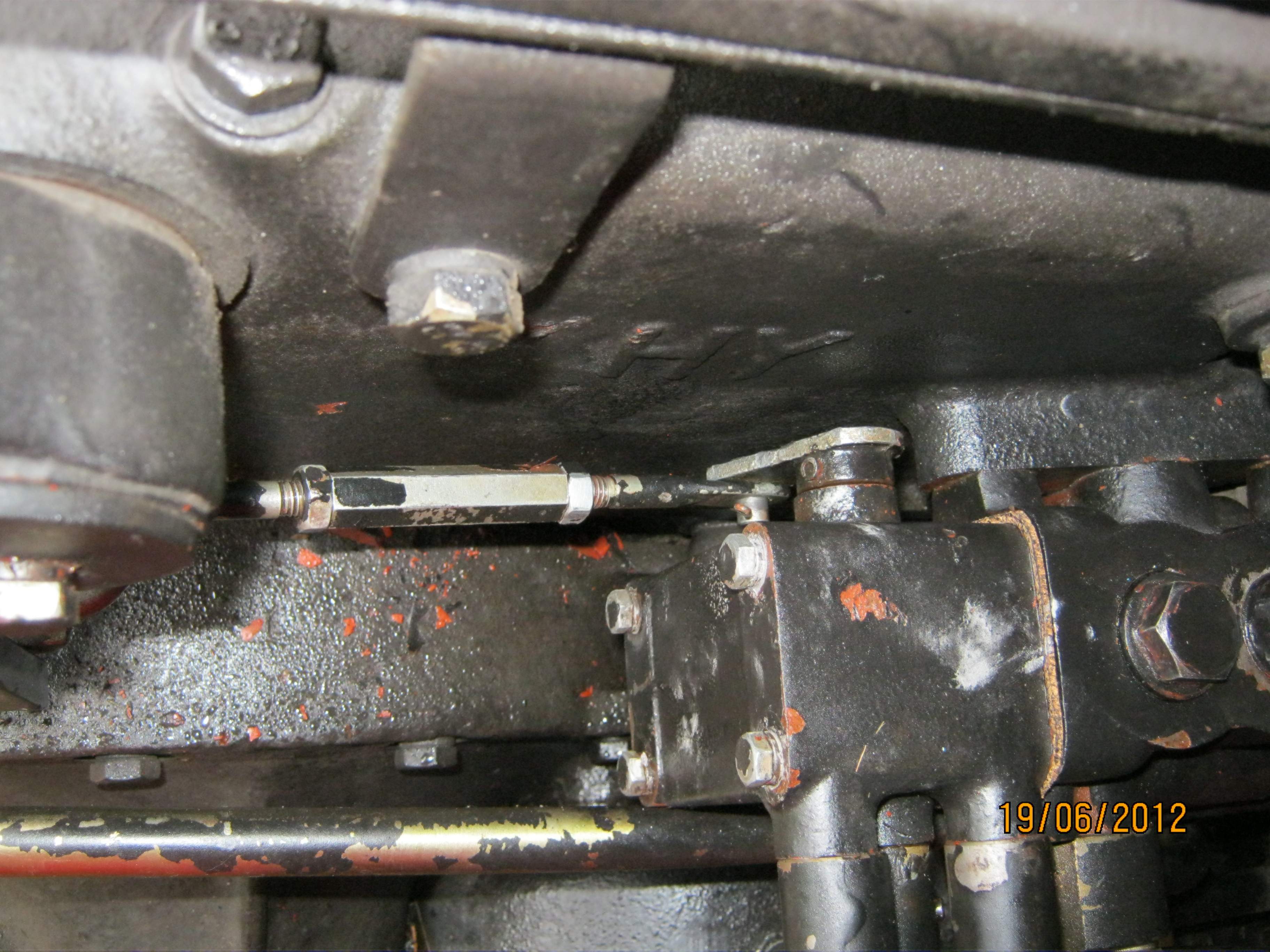

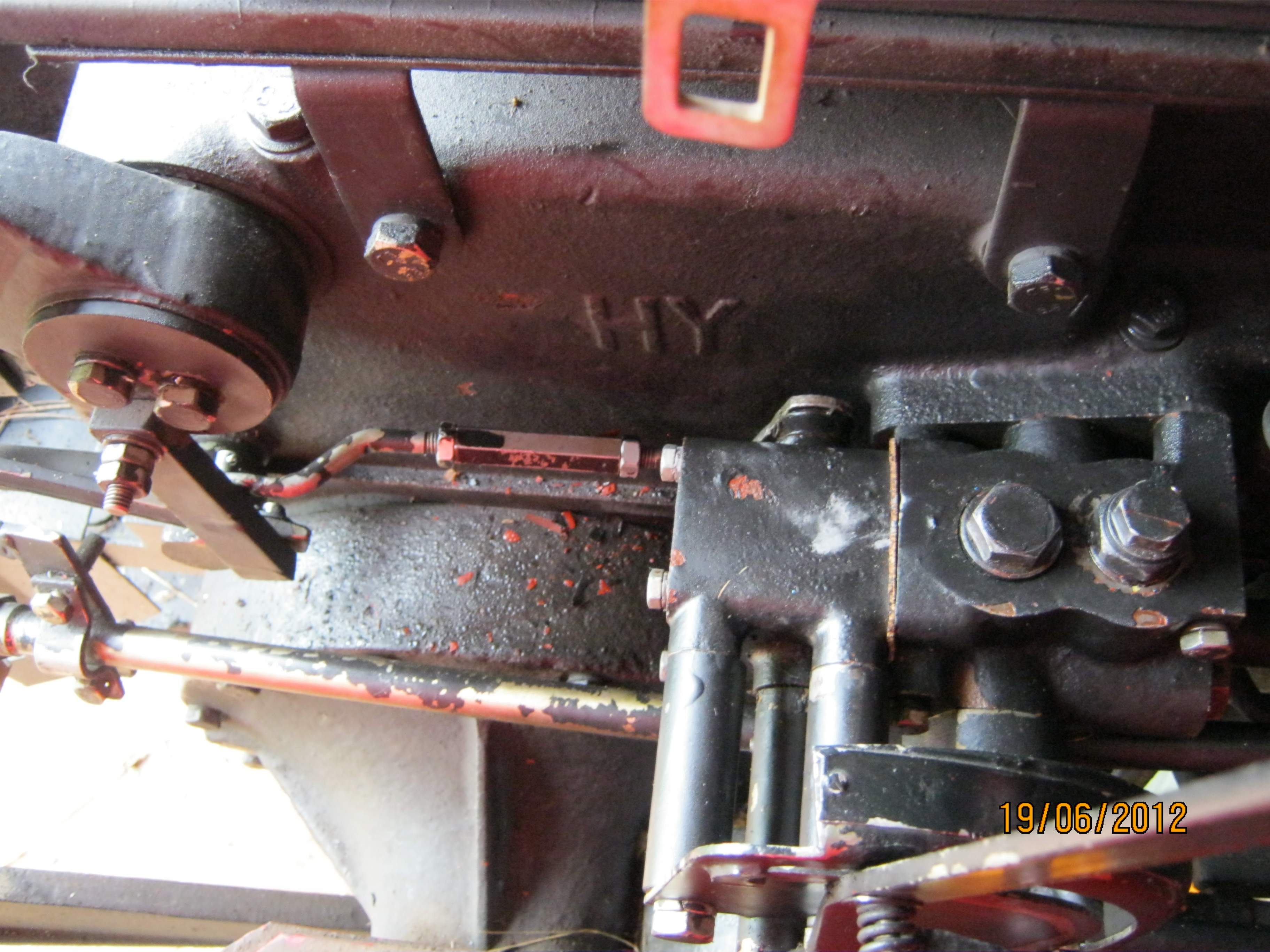

I think i may have found the issue with the arms ..have found the small feedback shaft at the distributor unit was seized so there was no movement in the feedback linkage from the 3 point linkage arms when they reached the full height .Have yet to install the unit back on the tractor so until then won't really know but it has certainly made a difference to the main control valve movement in the distributor unit .. watch this space!!:laughing:

I'm a happy chappie ..it works !!
Had to adjust the link arm and it all works as it should .:thumbsup:

Hopefully i have managed to attach a couple of pics to show the adjustable linkage and the small arm that was seized(Right side of pic))
