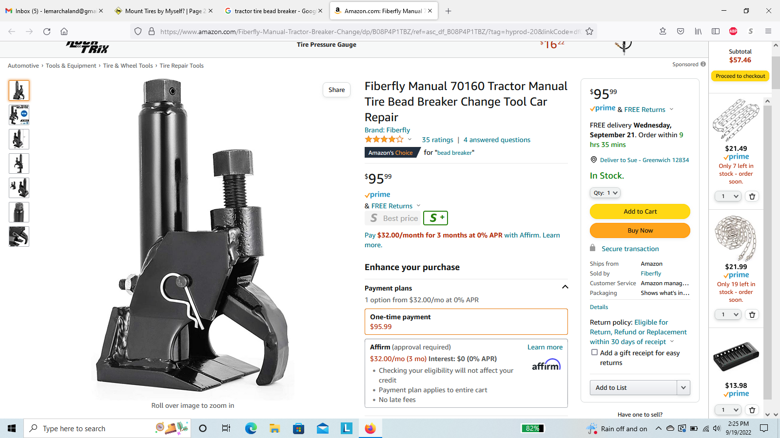

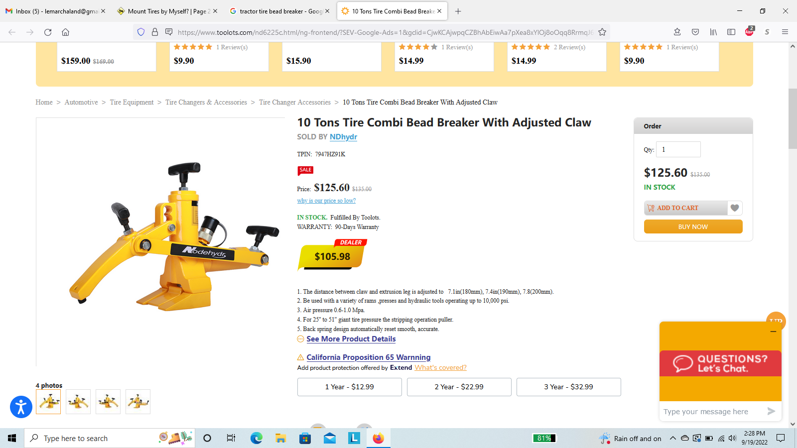

We use a bead breaker;
similar to this
I a have looked at the hydraulic style, but it is falling to the younger guys now days, so may save my money

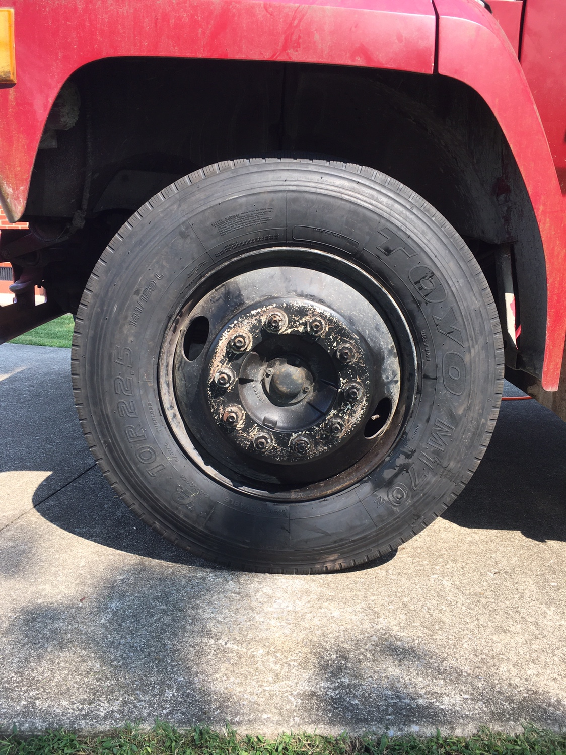

Put these on a couple days ago with a couple of HF tire irons. They are 10-22.5 load G
Very stiff tires. Takes about 15 minutes to change once off the truck.
Open air line connected to the valve stem with the core removed and just roll it back and forth usually is all thats needed to seat.
Never had luck with a strap. If its giving that much trouble seating I will use starting fluid.

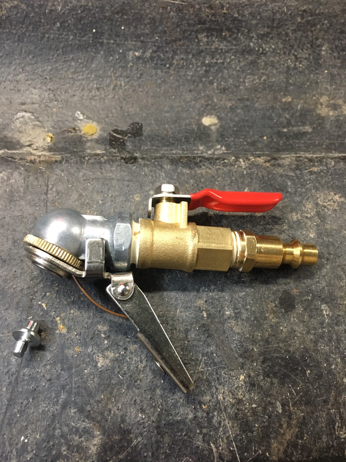

To make seating tires easier make yourself one of these.
All of this came from HF.
Just unscrew the clip on the chuck and take the core pin out. Then before you reassemble it screw a 1/4” valve on. Screw the chuck back together and put your quick connect on.
To seat a tire take the core out of the valve stem, clip on the chuck and open the valve.
