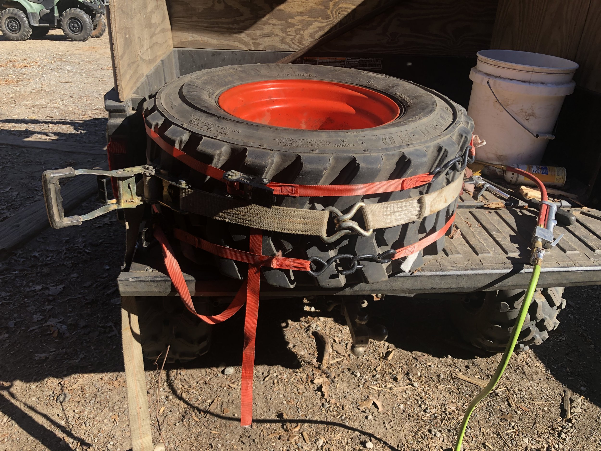

I’ve done it and mostly it’s all about breaking and seating the bead…
Sometimes one has to get creative when it comes to seating tubeless tires with high volume of air with valve core removed and a ratchet strap around the circumference of the tread to force the bead to the rim…

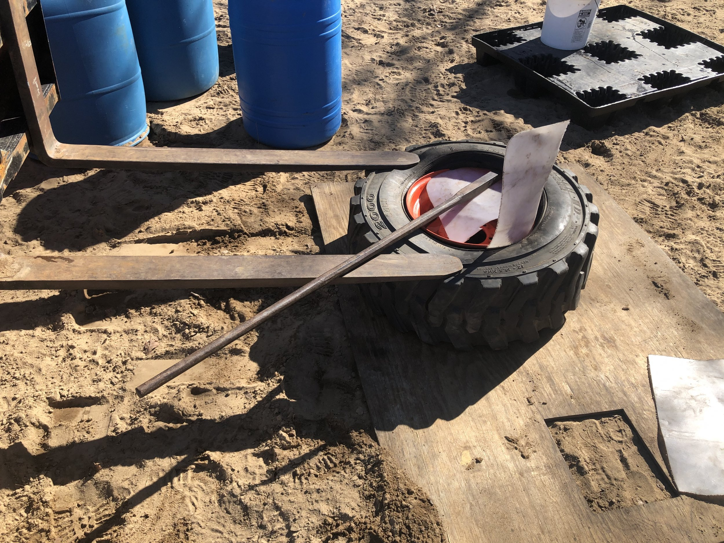

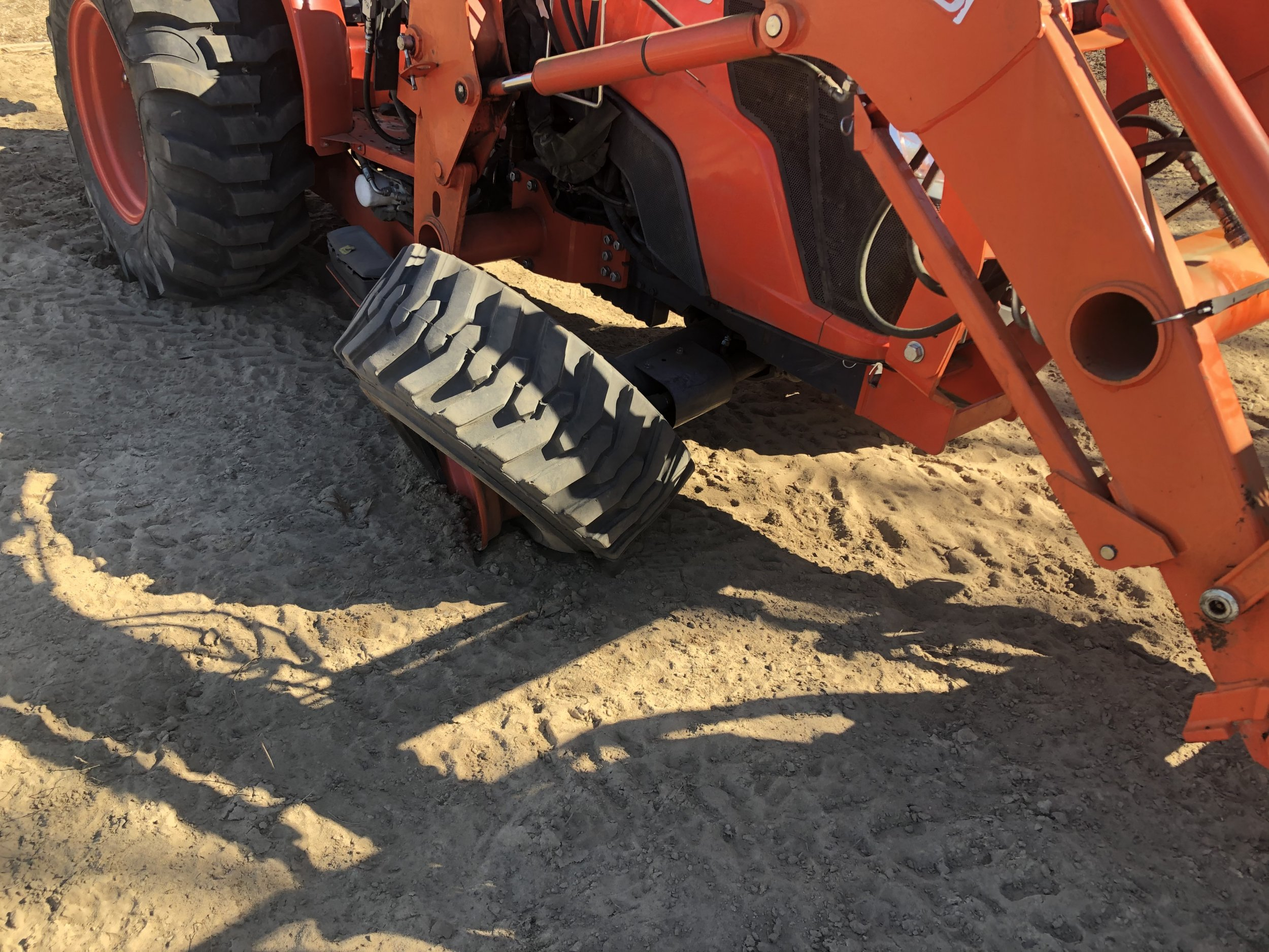

I think as long as your new tires get close to the same diameter tires currently on the front, the tread pattern doesn't need to match the rears at all.
As for dismounting and mounting yourself, if you can break the bead with something heavy(I've used the corner of the bucket on the FEL), just some tire irons are needed to do the rest, and a ratchet strap and an air compressor. Watch some youtube.
This^

I’ve lowered my truck on the tires to break the bead…

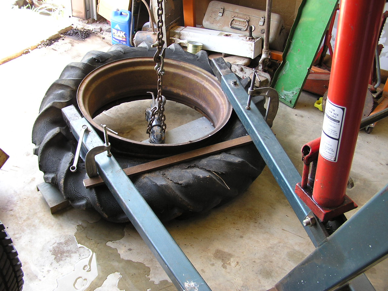

You can also use clamps.Some lone screw drivers or
metal rods maybe flatten one end. Watch a youtube
video on how to change a tire

Be careful with the straps when seating the bead. I use a rope with a loop, it will pull away before it breaks and whips me with a buckle.

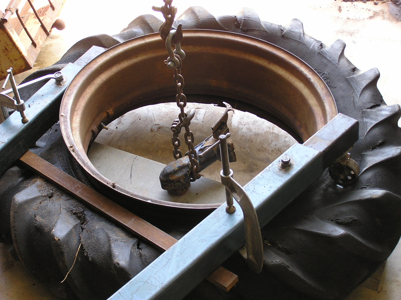

Being I collect antique/classic tractors, I have done quite a few. Most have been 24" to 36" rim size. I bought a slide hammer type bead breaker, and even the worst one's were broken off the rim in just a few minutes. Knowing how to use one is the secret. You need to go in pretty well flat ways until it hits the rim. Move over a few inches and do the same all the way around. Takes maybe 4-5 licks each spot. Then start around again driving downward each spot 4-5 licks. Most generally after moving 6 times, the tire literally drops down.
I have tires tools of all sizes, from 1" wide, 18" long, to the 42" long tire irons. Just need to press down the opposite side into the drop center, then start with a narrow tire spoon. Use a second one to catch what you have and chase it around. Just take baby bites as you go. Once you get about 1/3 the way around on the large diameter rim size, I can use the longer tools to bring it on off.
