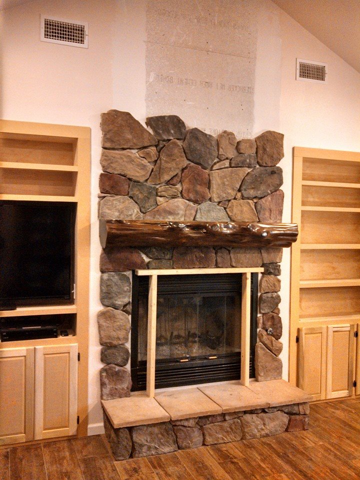

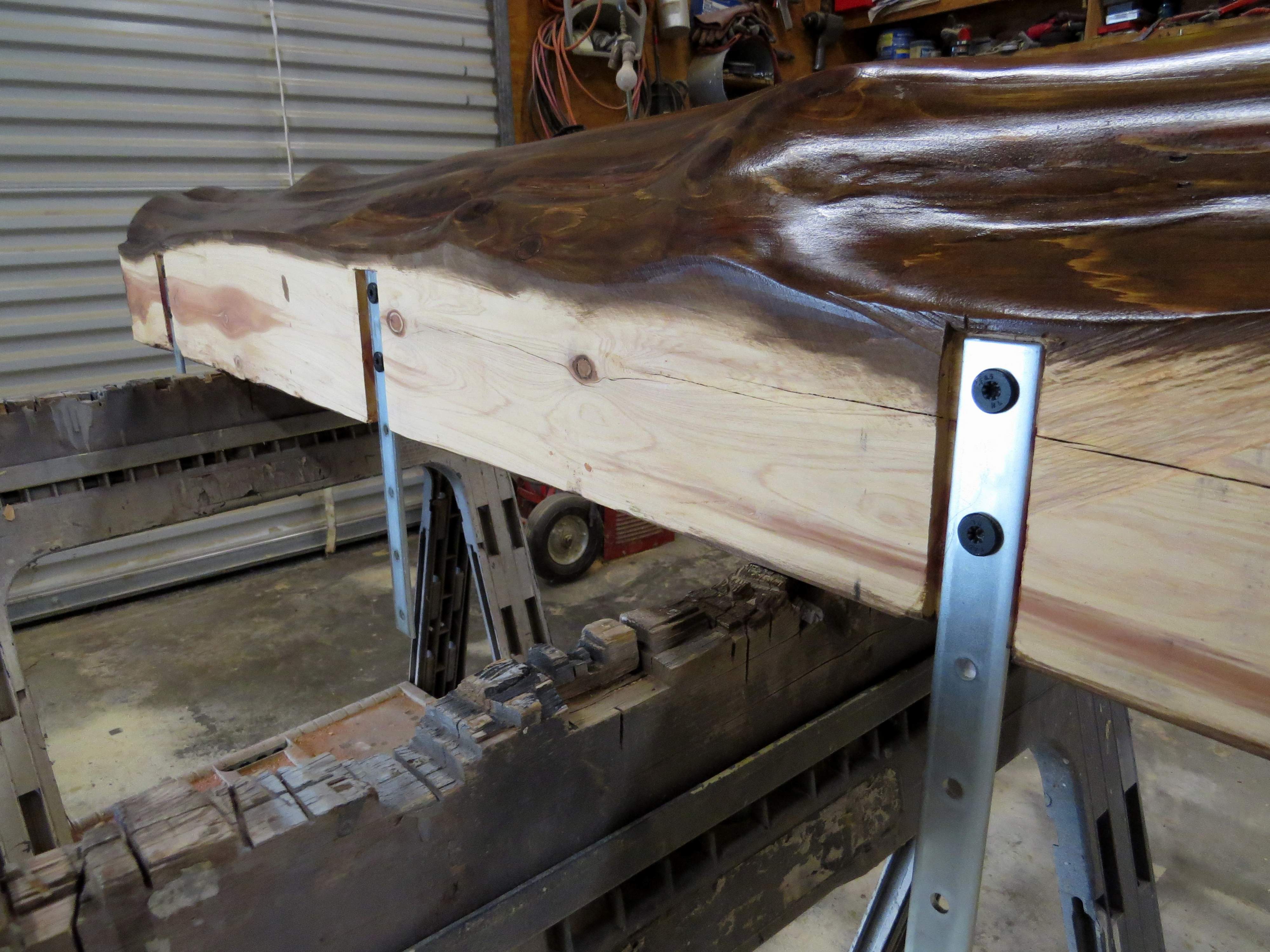

I used a couple of metal brackets from Lowes that where pretty thick and already had some holes in them with some lag bolts. Then I just screwed it all into the studs in the wall above the fireplace. Once in place, the rock went on below and above it to hide the brackets and offer support from the bottom.
Keep it simple
Eddie
