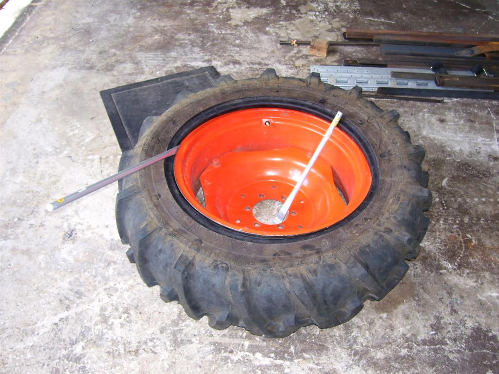

If you have done this before you learn the well thing real fast...ok sometimes slow. No matter what the tire they are easy to put on if you keep the bead in the wel and use some soapy water to help slide it on or seal the bead. Sometimes it is hard to keep the bead in the well. But no one mentioned my method for removing a tire. Actually the hardest part IMO. Yep I remember guys busting the bead with that sledge, 4 pound hammer and chisel. I use something a bit easier...and heavier. Usually only have to turn it once to get the other side. I did the 4 atv tires (6 ply Mud Lites gong back on) in about 40 minutes total. About 15-20 to replace the Tube on the L.

Rob, I never used your method of breaking the bead loose when I was working in a shop or service station doing tire work, but I've used it more than once on my own tires at home.:)
