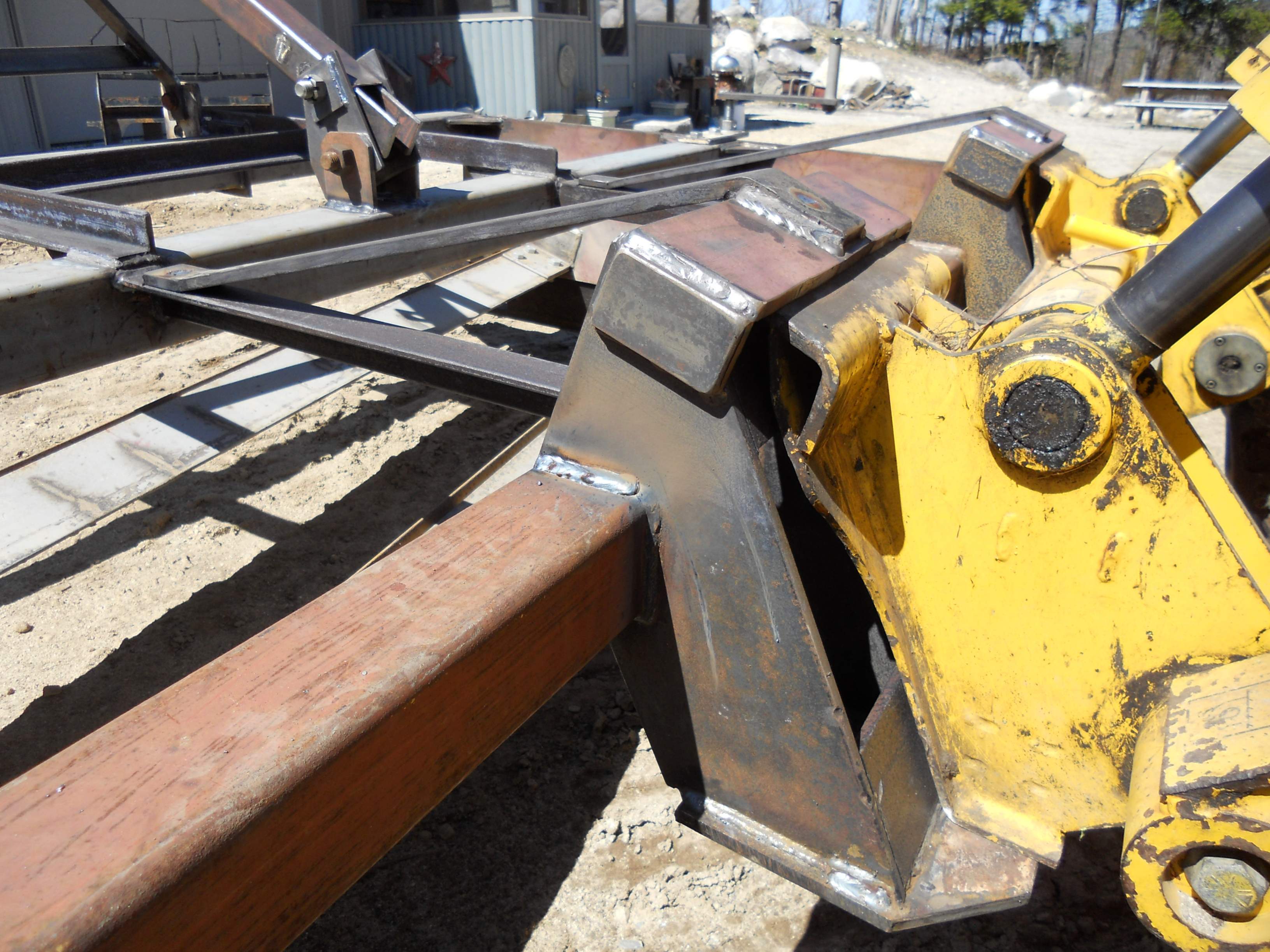

Here is what I have so far....first 2 pics show the QA of the FEL laying down on the metal frame, the next 2 show the "top bar" in its proper orientation & tacked into place.
Now, before all the critics start, this is my first attempt at building anything like this from scratch:) The top bar is 1/4" thick and a bit wider (or deeper) than I would have liked but the steel was free, so I'll work with it.:thumbsup:
I cut it to length, and then cut 4 pieces at 45 degrees (matching my wooden template I made) and I have those 4 pieces supporting each side of the QA plates (2 for each side).
Sorry, the resolution is not that great b/c it is my cellphone camera!
I have laid a weld across most of it and will probably have to go back and add a second layer for strength.
I'll post more pics when done or at least getting the lower tabs in place.
Thanks for looking!
P.S. - I might go to the Ritchie auction in June and see if I can buy one of the frames they have listed??!! At least I'm having fun learning:D

/ mounting plates #17
You're doin good!!
A few thoughts from my experience, 1/4" is a little light for the top angle but should be fine if you support it (like you did on the outside edge) at a point inboard of where your quick hitch ends. Make sure that the handles move all the way through their complete motion before you weld it. BTW, it doesn't need to go all the way across. Isn't welding up your own stuff cool!
Keep in mind that the top angle does ALL the work while lifting and the bottom angle does all the work during a "backdragging" type load.

Thanks RI.
I have another support on the inside of each QA plate....so there are 4 total. I remeasured and the topbar is actually 3/8". Thanks!!!
