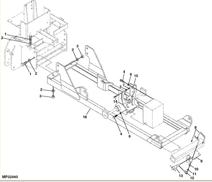

I just bought a JD 46 used backhoe from a dealer. It was a Kubota dealer so he wasn't very helpful with instructions. I downloaded the manual from JD this morning, but the mounting instructions and pictures don't match my tractor. I have the brackets to mount to the loader bracket and that is very easy to understand. I have a 2320 with the 3-pt arms currently mounted. Are there other brackets or pins that I need to purchase to mount this to the back of my tractor?

Go to jdparts.com and take a look at this bracket that is for the 46 on a 4110 (am thinking the 2320 may be close because tractordata said it follows model 4110). Find it under the 2320 in 'attachments' under 46 hoe. Took some poking around, but this came up.

pmgeiss, beenthere has posted a good picture for you. There are 3 key things you need 1 the correct sub frame for the 2320, and 2 the heavy support bracket (part 15 in the previous picture), that will replace your current support bracket that came installed from the factory, and 3 the front hangers with pins.

Well a sad day at the local JD dealer! It is true that the 2320 has a shorter sub-frame and the cost is over $1,000. Good news is the bracket that attaches to the tractor comes with the sub-frame (or at least that is what I was told). So now the choices: sell the backhoe with the 2520/2720 sub-frame (it is the same for both tractors), buy a new sub-frame for my 2320 or upgrade to a bigger tractor to fit the backhoe...this is my obvious choice as we have been talking about buying bigger anyway, but don't know if the pocketbook can stand that pain right now.
