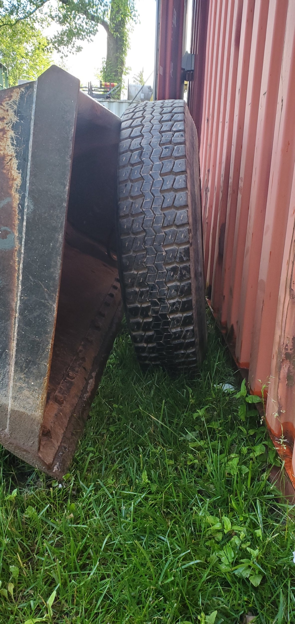

This is my tire cage:
I hide behind the bucket when filling.
This tire never "popped" on to the bead, it seems the rim just has a shallow slope to the edge of the rim. Got to 110 psi no problems.
I have put split ring tires on my hydraulic press as a safety device, yours looks good to me as well
That's because the 1/2" sizes (22.5, 24.5, etc.) doesn't have safety beads on the rims. They'll just seat, there's nothing to make them "pop".
