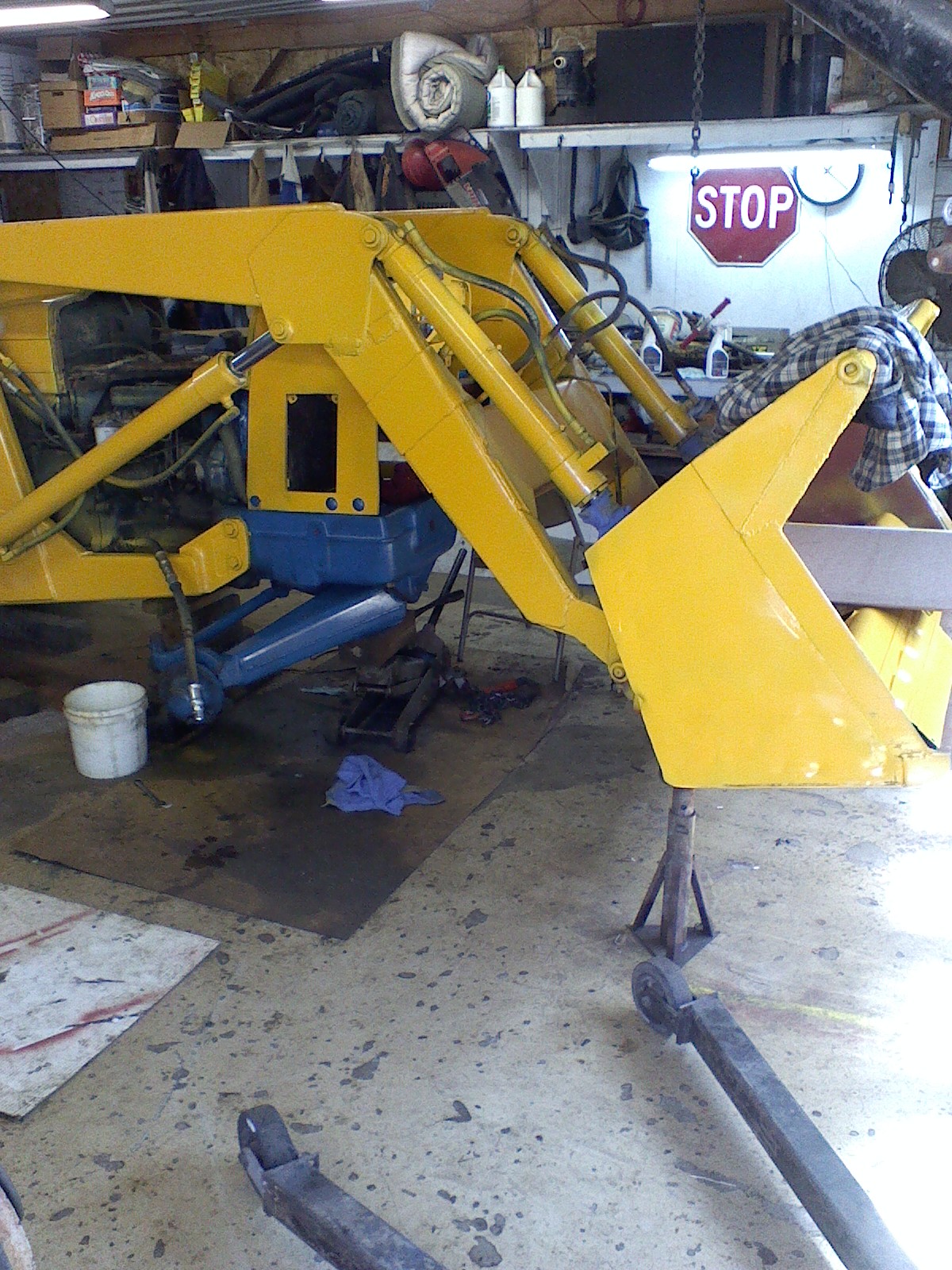

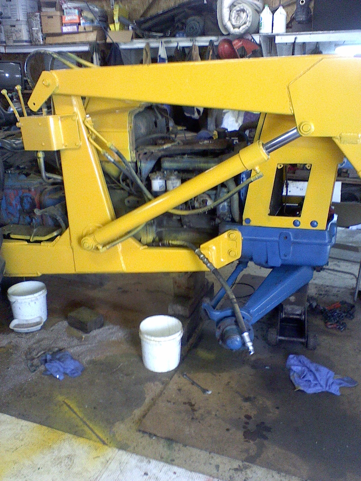

I would advise aginst mounting it where you are planning.
First of all, it will take a prett good sized winch just to be able to out-pull what you can by just chaining and dragging.
That said, with that good sized winch up that high is not a good idea.
Given the tractor is pleanty heavy enough, a tip/rollover is NOT likely unless you are pulling at a pretty good angle. But all that heavy 1/2" plate is your hydraulic resivoir. So aside from the fact that (at least ours) has the large filter and dipstick on top which would make mounting around that a challenge, but that chunk of heavy iron is only bolted with 3 bolts on each side into CAST IRON. And that cast Iron also has to support the front axle as well. And given that you want to mount ON TOP of that (a good 30" above the mount bolts) that will put a pretty good strain on her.
Notice in the pics, the BLUE peice is ALL CAST. And the 3 bolts that hold it are noticable too as they are blue:D
PLUS, with the cutout windows in the side, it would take very little force if you were polling on an angle to lay the thing over sideways. The little 3" or so sections in front of and behind the side windows arent much.

Yes it is a 4500. A 1967 model. And the windows are normally covered by panels that have slots in them and a wingnut or two and there off. The picture I posted doesn't show them.
I just did a google images search for "ford 4500" and it does appear that some do NOT have the windows.
And I even saw one that the loader frame mounts to the peice you are refering to.
Do you have any pictures of yours??
Either way, I still wouldn't want to mount a winch there. TOO high and TOO much leverage for a peice that is bolted to cast iron IMO.
