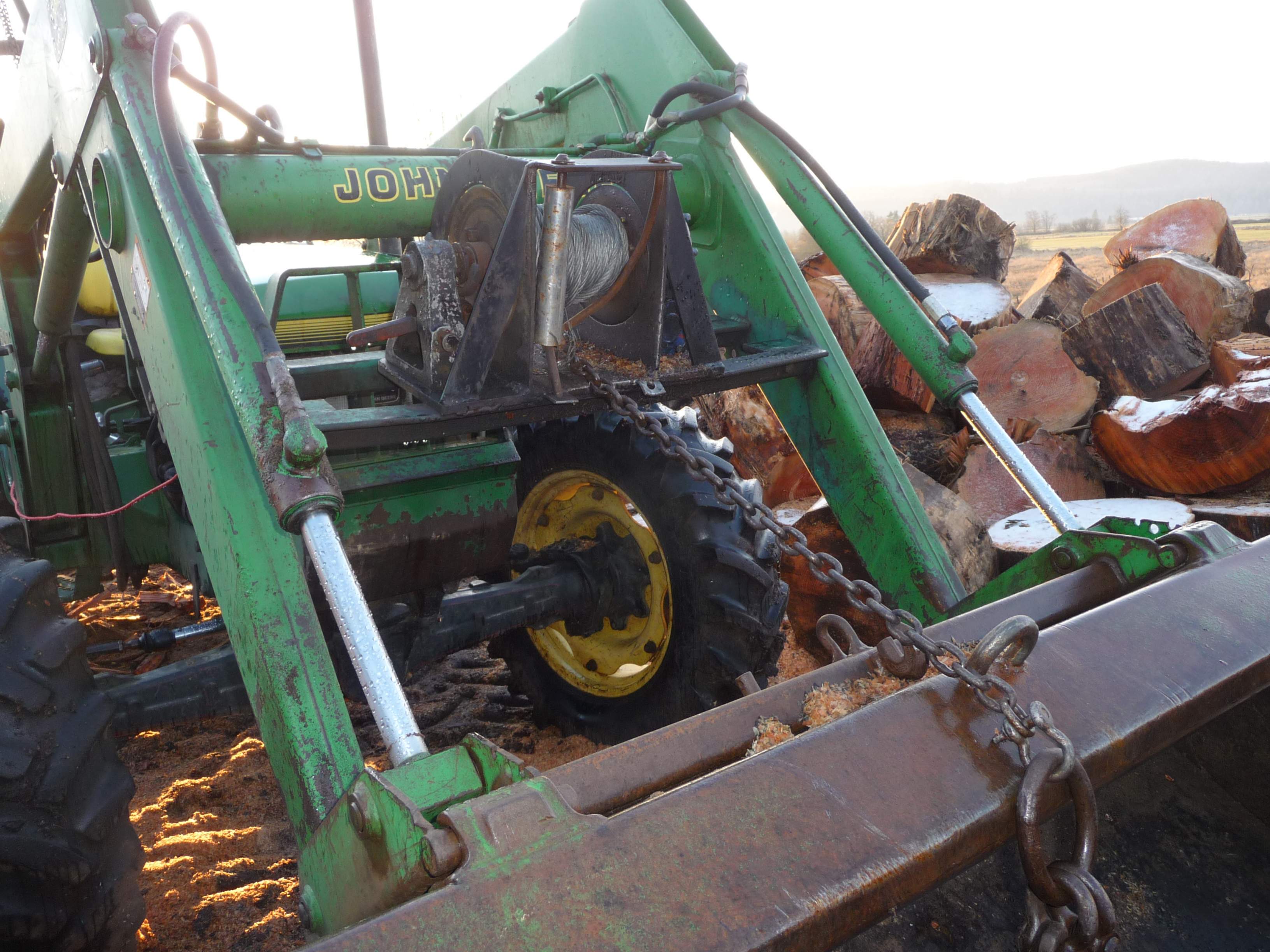

My ford 4500 tlb has a box-steel crossmember spanning the loader arms. How about a reciever hitch for a winch on there?
The loader bucket would be turned down, the weight off the front tires and the tractor raised slightly by the loader downpressure.
The winch would then be above the loader with all the straight pull stress being transfered to the loader structural arm pins, then to the down to the steel tractor frame.
No cast iron would be involved here.

Chuck, I use mine that way and have had no problems. I have pulled hard enought to lift the rear tires off a few inches with the loader dug in. I don't recommend pulling that hard, but I had no problems.
I did this when pulling a 78000lb truck out of a field and had a block purchase on it.
