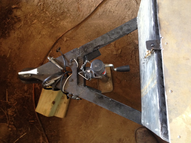

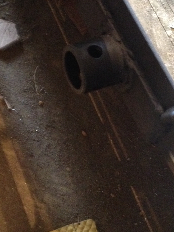

Ditto. However I bought the weld on one with the round pipe. Now I can pull the pin and stow it. Plans are to buy more of the weld on pipes so I can move it to the back to use as anti-tip downriggers. Of course then I need 2 jacks for the car trailer. My brother has 2 jacks like this on his pickup box trailer so that it won't tip up when loading and it is unhooked.
I like those too. U can also use them to change a flat if they're mounted behind the axle.

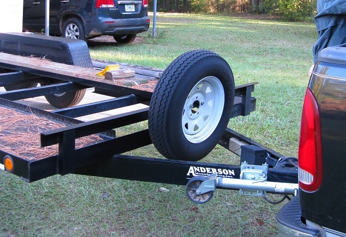

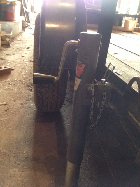

Not finding fault with your method but sharing mine. My clamp on moved the jack just far enough away to clear the tailgate and the swivel makes it easy to stow without having to retract it all the way up.

JD your whole project looks like the easier way. I was focused on what was there, kinda forgot about the benefits of the fold up kind. I coulda built that connection onto my jack easily. Wheel is a blessing & curse ( but if it had a reliable brake....) :thumbsup:

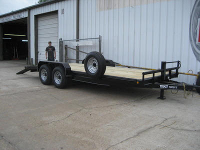

newtrailerpics003.jpgI like the way the jack on my trailer is mounted. It has a telescoping foot that is spring loaded to retract it so you only have to jack it up enough to release pressure on it when hitching then pull the pin to retract the foot. Reverse order when unhooking so there is less turning of the crank handle. There is no way to hit the tailgate on it, but with center mounting as it is, you would need to offset a winch a bit.

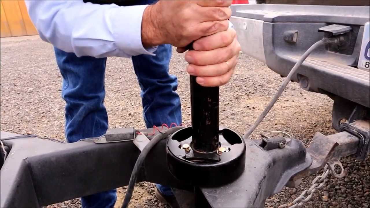

I have installed a Jack-E-Up on every trailer I have or will ever have. In fact I just installed one on my Son's trailer last weekend. These are wonderful, they allow you to completely remove the jack with just a third of a rotation of the jack.
