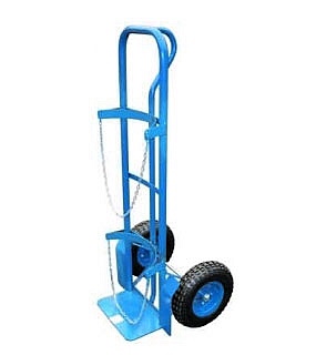

The are easily moved with a good two wheel dolly.
