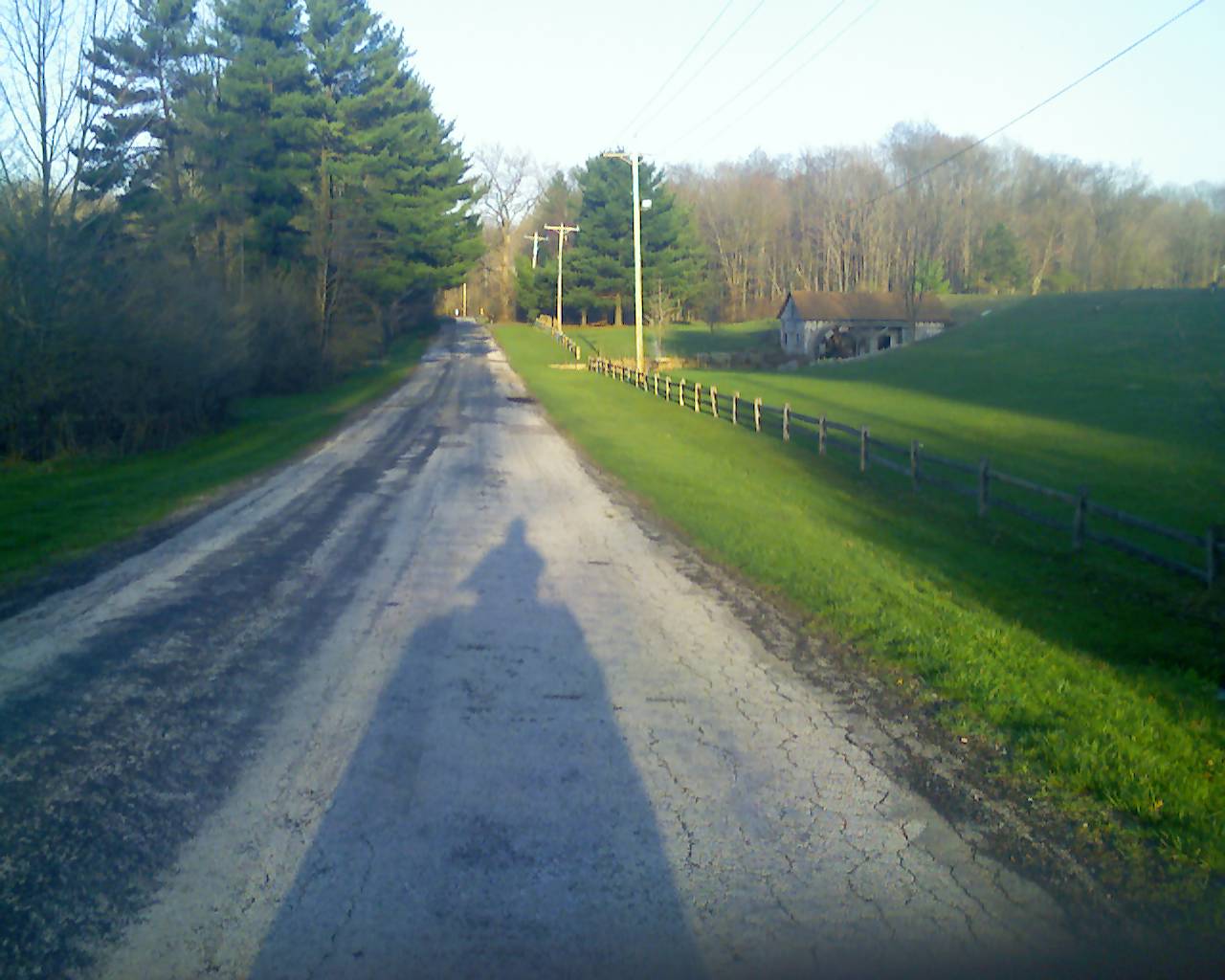

There is no feasable way to get the lowboy near the shed, as you would have to pull in forward, break it down and seperate it, then get the semi tractor out of the way. There just is not enough room due to trees and terrain, as well as places along the route it would get high centered.

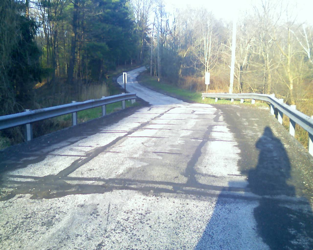

I rode the route on my ATV this evening, looking for tree branches, low wires, measuring gaurdrail height and width between gaurdrails etc. It was all good news, the gaurd rails on the bridge in question are 21ft 8 inches width wise, and 34 inches high. The 16ft wide roof section of the shed will be 6.5 feet off of the road, meaning as far as mailboxes and gaurdrails are concerned, I will only have to worry about the 12ft wide wall section.
I snapped some pics of the route and shed with my phone while on the ATV. I am working on loading them on my computer now. I will try and post them tonight.

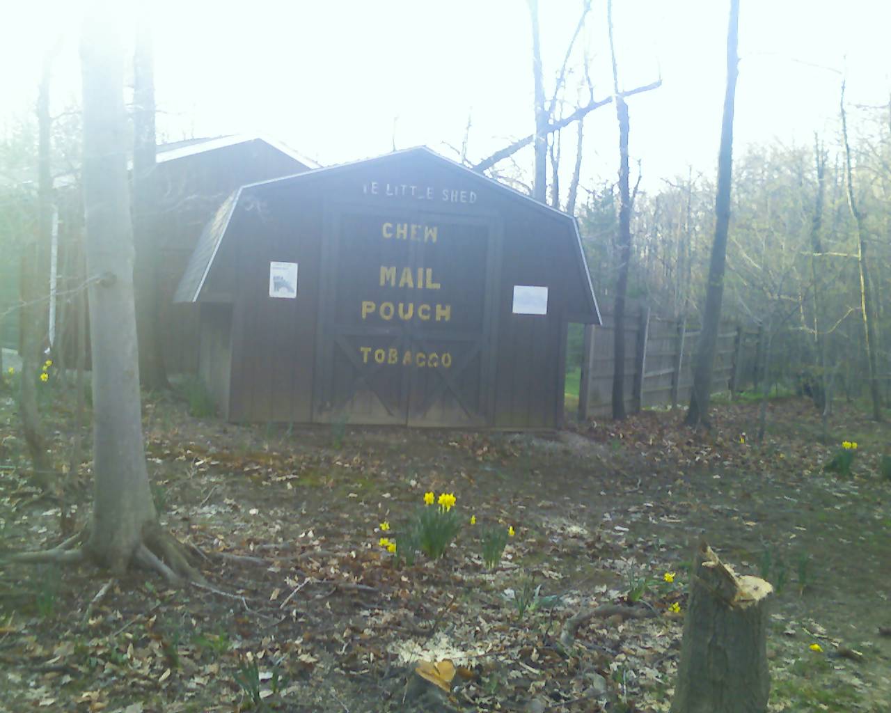

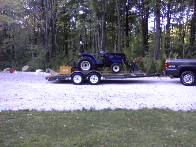

Here are some pics. of the route and one of the shed, and one of the trailer, tractor I will use and part of the truck I will tow it with. Please excuse the low quality, I used my phone this time.

Do you have a local police department? If you do; ask for an escort and pay them for their services; that way; everyone will be safe. I see no problems in moving it. I would jack up front, then support; jack up rear and support; back under it; lower and haul.
   / Moving 16x12 shed on car trailer. #26
I've moved a 16 X 16 cabin and 2 halves of a 24 X 24 pole building (we cut it in half) with a trailer like that. The longest of these moves was only 1-1/2 miles. As other have suggested, raise and block the building until you can back the trailer under it. Drop it onto the trailer, blocking to clear the fenders and adequately support it, and away you go. Take it slow. From the pics of your route and the bridge you should have no issues as long as you clear the overheads.
