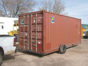

Slip a wide mobile home axle under it for moving. Weld a couple of large angles to the axle for the container to rest in. Add a hook and chain to a forklift hole to keep it from sliding. Make a hitch to fasten to the lifting holes on the container end, or a long tongue to the axle.
Bruce

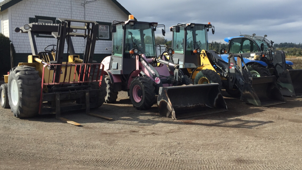

You don't NEED forklift pockets to move but they WILL keep the container from "flipping" off the forks.
If you are moving 20 footers when empty and not planning on stacking them, a 5000# + rough terrain forklift will work. Fork extensions will make it safer and/or be sure to tilt the mast back when moving.
Normal forklift practices prevail. REVERSE down slopes and drive FORWARD up slopes.
I can move our 20 foot seacan with either the 5000# R/T (left in photo) or the 7700# telehandler (far right) with no problems when empty.
I purchased the R/T new in 1992 but it's probably worth less than $10K today, WELL within your budget. Hope this helps.

Depending on what you plan to add when making it into a "cabin", you could end up doubling the bare weight of the container. I would be thinking of fabbing up some kind of transport dolly for one end of the container, possibly making it towable to give more maneuverability, stability and flotation.

The correct way to haul a seacan not by a crane is to weld steel skids under them from end to end and use those as the supports for any bottom point loads. Big forklifts/loaders with forks do work well for short trips.
I like the dolly idea. A well made dolly with integral hitch NOT using the can as the frame would be excellent.

Plenty of ways to safely DIY this though with a tractor. I would plan on building a simple axle that connects to the ISO points on the tail end of the container and lifts it up, and then on the other end you could build the same thing that has a tongue to connect to the back of your tractor, or even a lift like a Mule shed mover.

Since all containers are 8'6, you could easily make something that's simply an axle on two pivots with a hydraulic jack in the middle of the crossbars... slide it on, put two pins in it and jack it up. The front needs to turn so it's slightly more complex, but still very doable.
